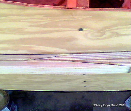

Here is a good one, a pair actually, in real life, in this case on William Moffitt's D'Arcy Bryn build:

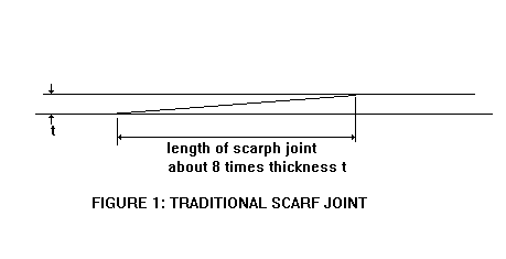

ENTER THE SCARF JOINT....
The scarf joint, if sufficiently long, allows the glue to work in shear, greatly increases the glue area over a simple butt joint, and hopefully leaves you with a long stick that is as strong and as even as the shorter sticks that went into making it. "Sufficiently long" means something like at least a 6 to 1 slant. So if you are joining 3/4" lumber, your scarf would need to be at least 4.5" long.
That is the suggested minimum. Longer would be better although I don't recall the suggestion to be ever more than 12 to 1.

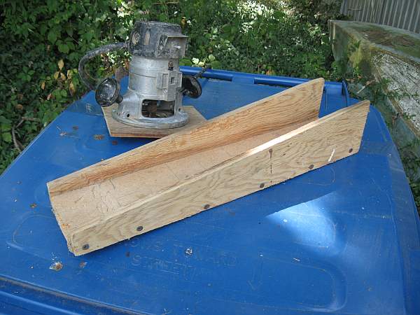

ENTER THE ROUTER JIG...

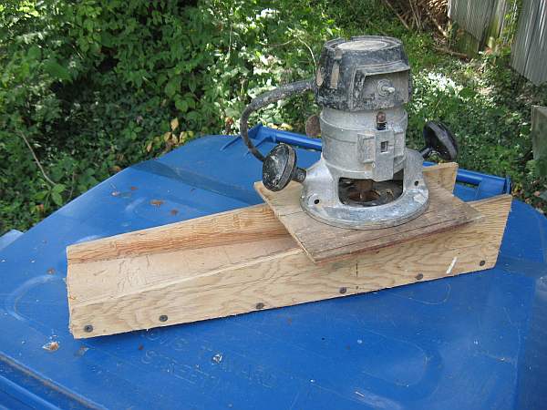

I just got this out of storage but it saw very heavy use when I made my Birdwatcher in 1988. Birdwatcher is 24' long with a 26' mast so a lot of scarfing was required for the long sticks and boards needed in the build. You see the idea, I think, Just a simple tapered jig made of three pieces of wood to start with. This jig is 20" long and 4" wide on the inside and will swallow a 2x4 if required. The sides vary in depth from 3" at one end to 3/4" on the other end so over a 20" span we have a 2.25" taper, or about a 9 to 1 scarf.
So you start by clamping your stick into the jig. Then place the router (with its base widened with a piece of plywood) on the top edges. The router has an end cutting bit adjusted to cut about 1/4" deep with each swipe. Start the router and slide it across the top of the jig so it slices off the first 1/4" of the scarf. Then adjust for another 1/4" cut, and so forth until the scarf is complete. So with a 3/4" board it will take about three passes. Normally I tried to avoid cutting the stick to a knife edge on its end, I would leave maybe 1/32" depth on that end.
That's about it. Maybe I cut a hundred scarfs with this on Birdwatcher including 4" wide boards used in the mast. The real advantages of this thing are that it is made from junk, gives perfect uniform results, and is small enough that you bring the tool to the stick and not wrestle a flimsy 16' stick around the shop and into a table saw. Highly recommended.

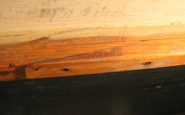

For the most part I never glued up my scarfs ahead of time, say to make a 24' stick from two 12' sticks, then to be assembled to the hull. Instead I would prescarf the stick ends but not join them. Then install one stick, say to the hull side if it were a wale, with glue and nails. Then install the second stick to the hull with glue and nails with the scarfed ends overlapped and flooded with glue. I would apply pressure to the scarf joint as the glue set with screws though all of it, sometimes with a block of wood to allow the clamp screw to pull tight without splitting the thin end of the wood. Here is a photo of the scarfs made this wayl on my AF4 wale showing the assembly screws which I left in place. A belt with suspenders never hurt anybody. And it doesn't hurt to stagger those scarf joints even though they are supposed to be as strong as the stick.
