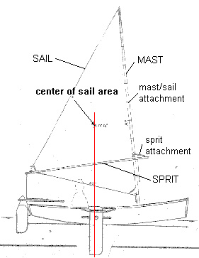

THE BASIC ELEMENTS...
sharpie sprit sail
THE MAST...
THE SAIL...

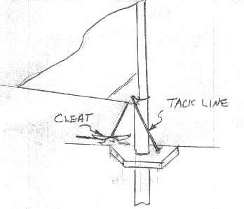

MAST/SAIL ATTACHMENTS...

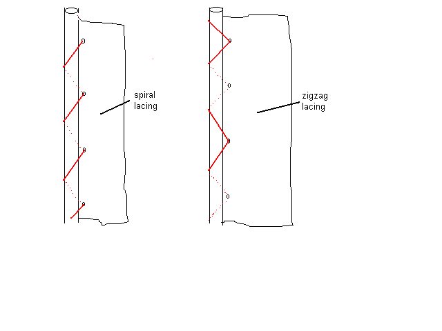

lacing

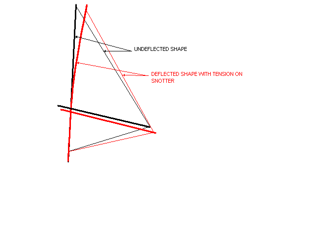

mast bending

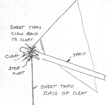

clew attachment

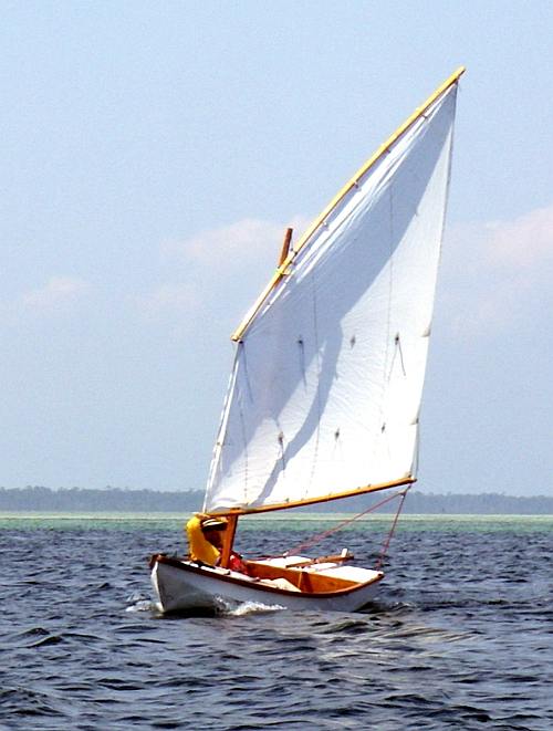

And this Toon2 by Scott Gosnell in Florida has a balanced lug sail adapted from the AF3 lug sail plans...
This Toon2 is also said to be a fine sailor. Compared to the stock sharpie sprit sail I would expect it to sail not so close to the wind. On the other hand it will certainly be easier to tow and set up and easier to reef and maybe be as good or better on the other points of sail. It's all the usual tradeoff. Note that it is not really a large boat and that the weight of the skipper in the stern affects the trim quite a bit. So with fine tuning she will be faster and better all around with the weight more forward. Then again, for lazing around on a slow day I found with my Piccup Pram that trim was not that critical and if the skipper lounged comfortably against the aft bulkhead, it looked bad but it sailed good. On its maiden voyage Mark's Toon2 was cruising all well with a Frolic2 and a Wooboto.
