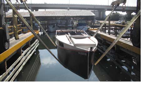

Rene Vidmer's far flung AF4b gets an oversized launching in Pensacola this time. Let's review: New York, up through Canada and the Great Lakes, down the Illinois River, down the Mississippi River, up the Ohio and the Tennessee, down the Tom Bigbee, along the Gulf Coast, then up the Suwannee, a portage across the Okefenokee Swamp, then up the St Mary's to Folkston, Ga where it now awaits a fresh motor!

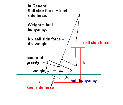

Here is the view of the hull under the force of sail that we will be looking at:

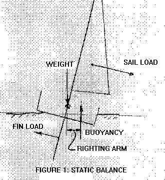

Figure 1 shows a diagram of how to figure the righting moment of a boat at a certain angle of heel. This is a static analysis which is to say the boat is not accelerating. It can be moving, but all the forces on the boat are in balance. If the boat is being pitched and rolled about in angry seas, a much more complex analysis is required. Also, the distribution of the ballast (as opposed to simply the location of its center of gravity) becomes a factor in a dynamic analysis.
What we have here is the wind's pressure on the sail, up high, and a balancing load on the keel or fin, conspiring to tip the boat over. That "moment" or torque, is counteracted by the weight of the boat pushing down and the buoyancy of the boat pushing up. These last two forces are not in line with each other when the boat heels but are separated by a distance called the "righting arm". If the weight of the boat in is "pounds" and the length of the righting arm is "feet", the righting moment is measured in "foot pounds". Note here that the stability of the boat is a direct function of the weight. So heavier boats are more stable than light boats and could carry more sail in a given wind.
To figure the foot pounds of the righting moment, you need to know the weight of the boat and the location of the center of that weight - the "CG". Also you need to know the location of buoyancy of the heeled boat. (The buoyancy itself is the same as the weight in a static analysis.)

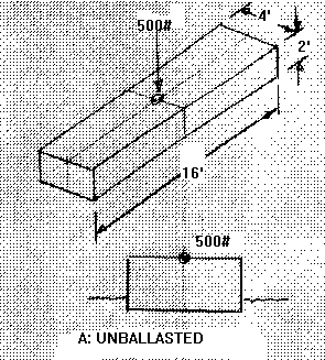

This is very hard to do my hand. I'm going to use Hullform6S as a tool to do this. To keep lots of variable from getting in the way, I'm going to use the above pictured "boat" as the example. It is just a box, 16' long, 4' wide, 2'deep. It weighs 500 pounds with its unballasted weight centered on the top of the box, 2' above the bottom. I'm going to ballast the box in four different ways, roll each example over at 10 degree intervals to 90 degrees, and record and plot the righting moments as predicted by Hullform6S.
I should note here that the original essay was steering towards the effect of different sorts of ballast which is interesting in itself. And although the test model was a simple box, programs like Hullform can figure the hydrodynamics of about any shape you care to type into it. If you have a very specific hull shape in mind you need to define it to Hullform essentially by typing in offsets taken from your hull.
...EXAMPLE A...
So example A will be the above unballasted 500 pound box.

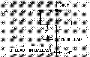

Example B is shown below. It's the same as A exept it has a 250 pound lead fin with the weight of the fin centered 2' below the bottom. So the CG of this combination is .66' above the boat's bottom. But, the 250 pounds of lead displaces some water, right? Its volume amounts to .36 cubic feet of lead displacing the same amount of water which is 22 pounds of water trying to float the lead back up. So the total ballast effect of the lead while it is under water is actually about 228 pounds. If the boat heels to the point where the lead is totally out of the water, it has 250 pounds of ballast effect.

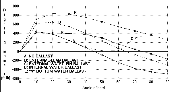

The results of the Hullform6S study are shown below:
Curve A is, I think, pretty typical of a light flat boat with no ballast. The maximum righting moment of about 450 foot pounds is reached quite quickly although I think a real boat would have the peak at about 20 degrees. The boat looks to capsize at about 45 degrees heel. My experiences with Jinni, about this size and weight, were similar. It capsized twice in the time I had it. Both time it went over well before it shipped any water over the rail.
Curve B shows the how effective metal outside ballast can be. Not only is the maximum righting moment about twice that of example A, it still has substantial righting ability at 90 degrees of roll. It will tend to roll upright at any angle of heel up to about 110 degrees.
Curve C, external water ballasted fin, is an interesting one. Until the fin starts to exit the water as the boat rolls, it has no effect. When fully out of the water (about 80 degrees of roll) it is as effective as metal. In between its righting moment goes to about zero. If rolled to about 50 degrees it might stay there until acted upon by an outside force such as a wave or maybe the crew moving about. If rolled to a greater heel angle it will try to return to 50 degrees. If rolled to a lesser degree it will roll fully upright.
Curve D, internal ballast, has about 50% greater maximum righting power than no ballast or the external water fin. It should easily outsail a water fin boat up until it capsizes at about 65 degrees of heel. At that point the water fin boat gets back on its feet while the internal ballast boat flops over.
Curve E, V ballast tank, cuts across about everything as a compromise. It doesn't have the initial stability of the internal ballast boat, but it has positive stability at high roll angles. I've heard some water ballasted production boats behave this way.

Now, given the curve above, you can say that (assuming the height of the sail rig is the same for all cases) in a given wind these boats could carry sail area in proportion to the maximum righting moments shown. A, C, and E should all have the same sail area since they all have a peak righting moment of about 400 foot pounds. The effect of the ballast here is to delay capsize to deeper roll angles. But D, with internal ballast, could carry about 50 percent more sail, and B, with the metal fin, could carry twice as much sail.
