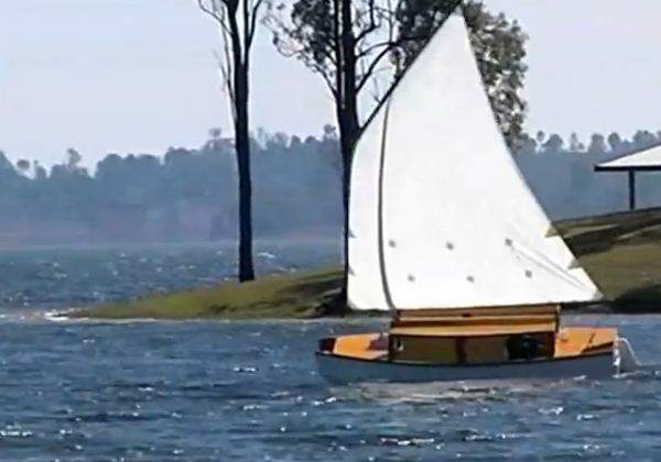

Sailing a brand new Scram Pram in Australia. Greg Flemming started the project, oh maybe ten years ago, and Ross Lillistone finished the details and made this cool youtube video http://www.youtube.com/watch?v=CnqvJB2ei7s&feature=youtu.be for us to watch. That is Paul Hernes at the tiller. I'm told this has a Fatcat2 sail rigged as a lug, smaller that the Scram drawings and essentially the same as the Blobster lug rig, but it appears to be excellent. Now I'm told it goes back to Greg for final painting. You can find Ross at www.baysidewoodenboats.com.au

Now, if the boat is designed with plumb sides, like many Bolger box boats and I've followed along those lines, it isn't hard to figure out how to do it by looking at the plans. Like a normal box house, you make the walls higher and the roof will go with it. Take a look at the new Australian Scram Pram, a capture from the youtube video.....
Greg Flemming raised the roof a few inches in construction and I never noticed it! Ross Lillistone who completed the details said he wasn't sure of that also, but added it had plenty of headroom inside. It's a very simple change to make and can really enhance your interior life.
