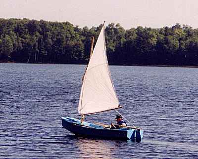

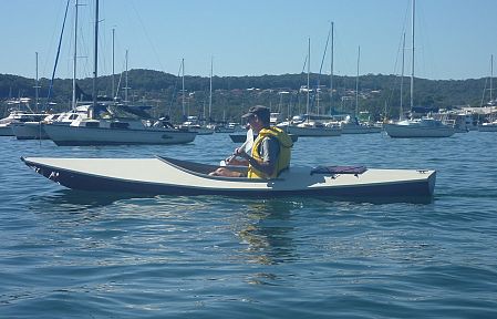

Miles Bore Down Under takes his new Rio Grande (also known as Sandrasboat) for a spin around the marina. Miles also has the one and only Blobster.

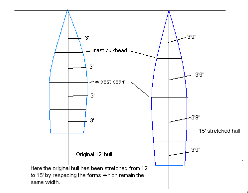

...you have stretched a 12' sailboat to 15' by either the old fashioned way of respacing the forms, or maybe by the instant boat way of laying out the side panel dimensions expanded by a factor of 15/12. So the top views, old and new, might look like this...
Everything including the bulkheads has been respaced by the 15/12 factor.
WHAT'S WRONG WITH THIS PICTURE???
OK, with my boats the mast is usually hung on the forward cockpit bulkhead, and the leeboard pretty much has to be at the boat's widest beam in order to be in water flowing parallel to the direction of the centerline.
It needs to be mentioned and never forgotten that the sail area MUST be centered over the leeboard (or daggerboard or centerboard) area for the boat to handle properly. It is about the only thing with a small sailboat that is sacred. If the sail area moves aft of that, the boat will get more "weather helm" and will try to always steer into the wind. Weather helm is not bad if it is not overdone, a small amount is ideal. But if the sail moves forward of the leeboard area you get "lee helm" and the boat will always try to steer away from the wind. Lee helm is I think always bad and usually very bad. From a safety standpoint, if you fell off a boat that has weather helm, the boat might steer itself into the wind and stop and wait for you if you are lucky. If you fell off a boat that has lee helm it will turn downwind and just keep going away from you and leave you. Perhaps as bad though is that a boat with lee helm may not steer to windward at all or may not be able to tack through the wind to a new course. Essentially you won't be able to steer it. So it is to be avoided! (And, by the way, if you have a boat that is quite lackluster going to windward and you can't really see why, try moving things to give more weather helm - move the sail area aft in particular. A few inches will make a difference.)

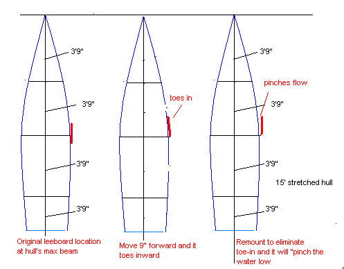

So what is very wrong with the above is that the sail rig was designed to have 3' between mast mount bulkhead and the leeboard. The stretched boat has 3' 9" between them and is guaranteed to have lee helm unless something is done. This sort of thing might not be apparent at all to someone who is building stretched without making a drawing of sorts of the new boat with sail rig.
WHAT CAN YOU DO???
You could try to move the leeboard forward 9" to achieve a new balance. Like this...
Now, I don't really know how important that is since I never did tests but you can see if the leeboard were brought forward of the widest beam and still mounted parallel to the side, it would toe inward a bit. You could mount it there but reset the leeboard mounts such that it is now parallel with the hull centerline. But if you assume the waterflow there is parallel to the hull side then your boat still isn't going to want to steer exactly in the direction of the hull centerline (actually it seldom does anyway), or you may end up with a bit of a waterspout and added drag as the water gets jammed between the side and the board as the two converge a bit.
If you use a daggerboard or centerboard you could avoid the above but you still have to move it forward 9" to compensate for the sail moving forward.
You can move the mast mount aft 9" so it matches the leeboard location. This is I think how the problem is usually solved. If you are thinking well ahead you might do that by planning for a new bulkhead installed there. The new bulkhead won't be the same dimensions as the original so you will have to scope that out. But the usual solution has been to mount a new mast step 9" aft of the original and a wide traditional mast partner board securely across the wales such that these together will move the mast aft 9".

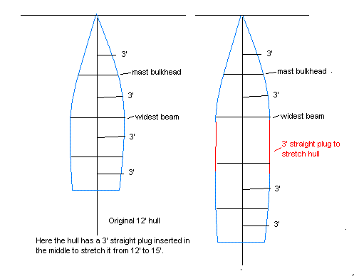

But let us say you did not stretch the hull by respacing forms or expanding side dimensions. You did it simply by installing a straight "plug" at the hull's widest beam. Like this....
I know it may not look elegant but you can see right away all of the advantages. You can leave the mast on the bulkhead where it was and also leave the leeboard the proper distance aft, where it originally was, since the leeboard is still at the hull's widest beam. The hull no longer has its widest beam at just one point - the straight plug has given it a widest beam region that is 3' long. Ah! The experimenter's paradise! The leeboard could go anywhere in that plug if required and you can tinker with different sail rigs to your heart's content and should still be able to get things to balance if you can shift the leeboard along the plug.

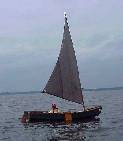

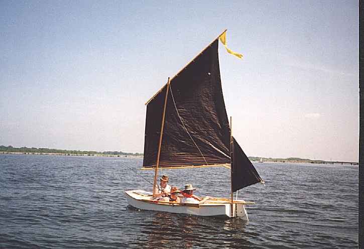

I think my own Piccup has had about six rigs of different sorts and was always the test bed for the polytarp sail experiments. But, hey!, that's nothing compared to the tinkering the late and great Reed Smith did with his out in California. Here is his Piccup rigged as a sharpie sprit yawl!
Reed's

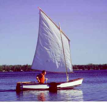

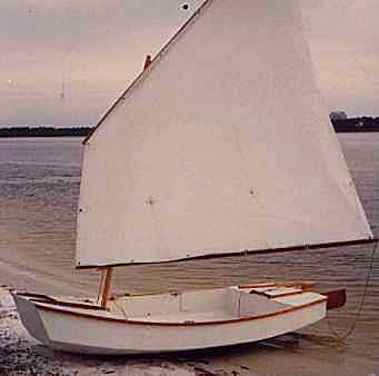

Here is another by Doug Bell:

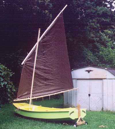

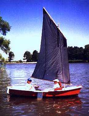

This one is by Jim Islip:
And this one by Ty Homer:
