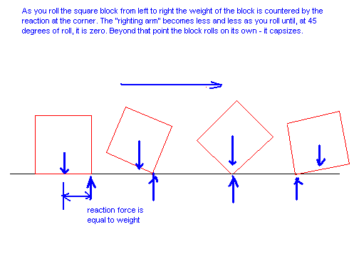

...anyway, back to the early pencil and paper. Starting with basics I imagined a square stick sitting on its side like this...
If you start to "roll" it it will start to lift up on one edge. The "righting moment" at the start will be the weight times half the width of the stick. Then as you start to roll it the "moment" arm between the support corner and the center of gravity gets shorter to the point where, at 45 degrees of roll, it goes to zero. Beyond that point the stick will try to flop the other way over, it "capsizes".
Well, its sort of like a catamaran, isn't it, since the cat will have its support point all on the corner once it starts flying a hull. And by this time I already knew that the classic sharpie hull, in this case my old Bolger Jinni, would capsize at very close to 45 degrees of roll (I was way to busy to measure the exact angle at those times). And then I read that Howard Chapelle considered "self righting" for a sharpie hull to be the ability to recover from a 45 degree heel. Right away I felt I was on to something. But note,,,the length of the rolling stick has nothing to do with the results.

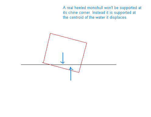

...a monohull doesn't roll around its outer chine like the stick does. Instead it "mooshes" (a technical term I don't have the time to explain now) down until the weight of the entire boat is countered by the weight of the water displaced by the abovementioned mooshing, so its righting arm will be less than the above simple example. Like this...
(...and keep in mind that the center of gravity of the real boat isn't going to be at the middle of the "square' - it could be about anywhere given the ballast, rig, crew, etc, but the designer can calculate it and control it to some degree).

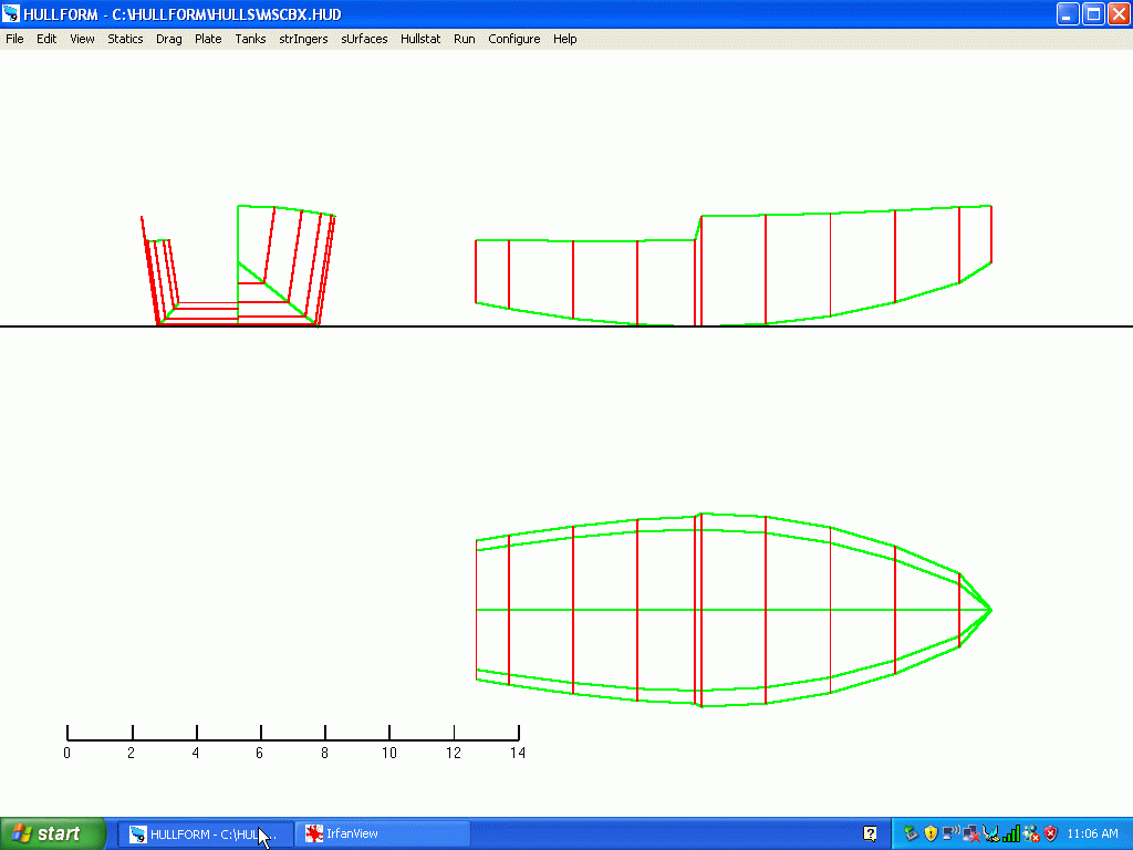

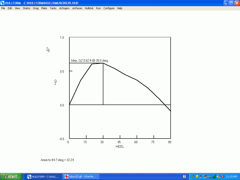

So, at long last twenty years on, let's use Hullform to see if there is any truth to my guess that the length of a hull has nothing to do with the roll stabitily. I found in my old files my Hullform model of Musicbox2. Here is the program's graphic of that old file...

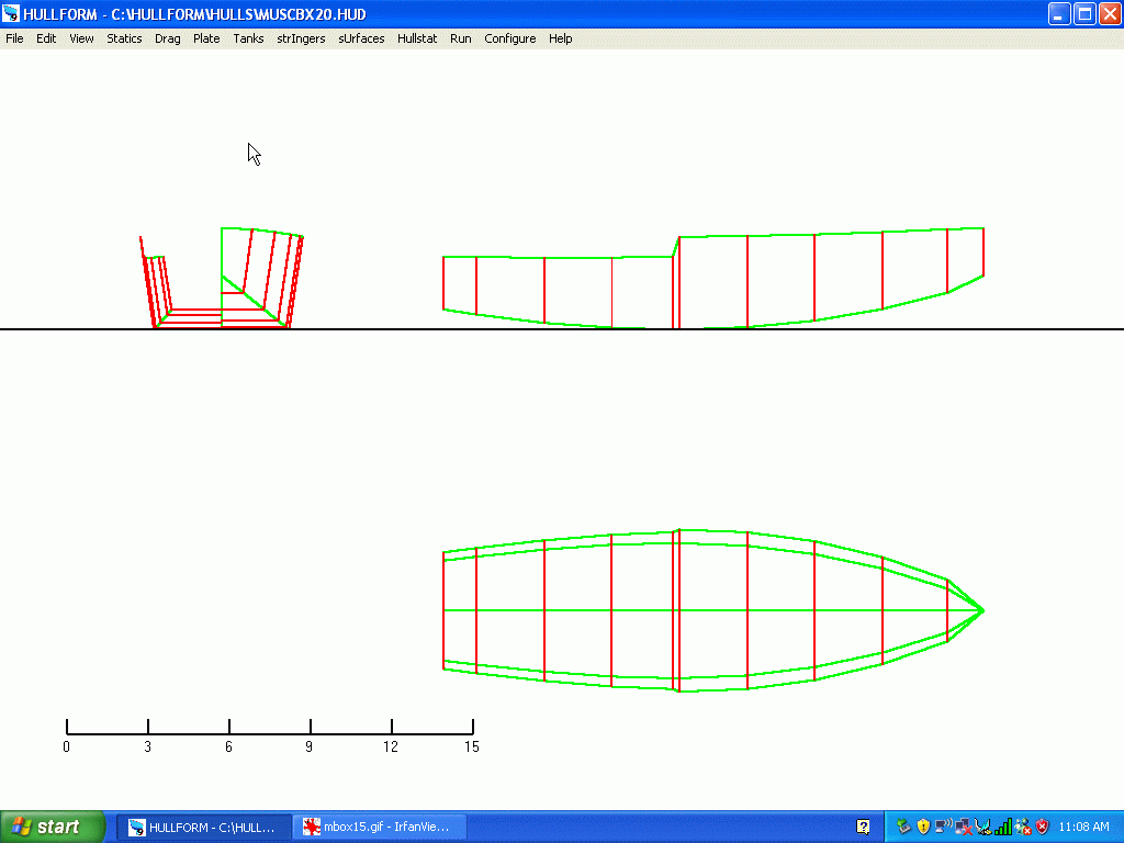

Then I stretched the basic design simply by respacing the sections so that the initial 15' design became a 20' design - the beam stayed the same. Like this...

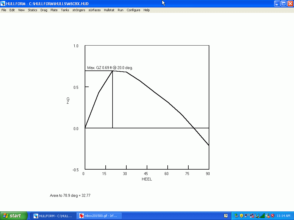

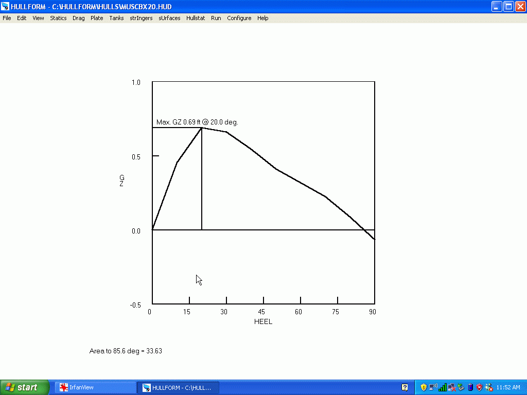

Then I let Hullform do all the work and got righting moment curves for both designs. I did this for three examples - the first with the 15' hull at 1600 pounds total...
... and then for the 20' hull also at 1600 pounds...
and then for the 20' hull at 2000 pounds total with the idea that the longer boat will be heavier. The vertical cg was the same in all cases...
Hullform is giving the stabiltiy solution in the form of Gz, the righting arm. So the righting moment is Gz times the weight. Anyway, it shows at 1600 pounds, the Gz is the same for the 15' and 20' hulls so the length has almost no effect on stability. Note that for the 2000 pound 20' hull that the Gz actually goes down compared to the lighter boats. I would say that is the effect of the heavier boat mooshing deeper into the water and, when rolled, cannot be supported as well by the chine area as the lighter boats.
No, just stretching the hull from 15' to 20' made no appreciable change in the stability. The length just doesn't matter all by itself.
