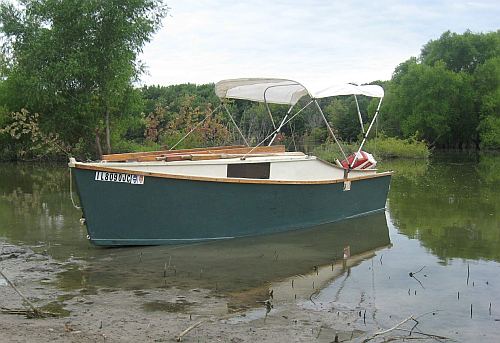

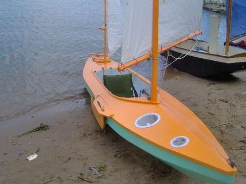

Into the water at last! My AF4 is into its 16th season. The local lake has been flooded all year and only this week have the launch ramps become usable. Still, here I am beached by a farmer's flooded field. AF4 was specially designed for this sort of funny business. Last year's season was spoiled by very low water!!

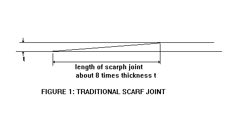

TRADITIONAL PLYWOOD SCARF JOINT...
scarf joint
Figure 1 shows the traditional plywood scarf joint. I''ve never done this in plywood although I've made a lot of scarf joints in plain lumber. The two overlapping faces are tapered and glued together such that both joined faces remain smooth. If you are building a traditional lapstrake boat from plywood you have to make the joints this way.
What's good about it? The faces are smooth both sides. Essentially you have a single piece of wood to work with after making the joint. It's quite strong, as strong as the base wood provided the taper is long enough. I've seen the taper range from 6:1 to 12:1. The shorter tapers are easier to make and probably just as good given modern glues.
What's bad about it? The tapers can be hard to make properly although thickened epoxy has made experts of most of us. Some experts have special saw rigs to cut the taper. Most use power hand planes or belt sanders, I think. When gluing the joint you must press it up against a firm surface while the glue cures, making sure nothing glues to that surface, and making sure the two pieces are secured lengthwise so the tapers don't push them apart as you apply clamping pressure.
There is one more warning for instant boat builders. Almost all instant boat designs have panels layouts which assume you will not be using a scarf joint. If you join two 8' panels with a scarf joint you will NOT end up with a 16' panel. It will be shorter by the overlap amount. That might be just enought to negate the ply panel layout.

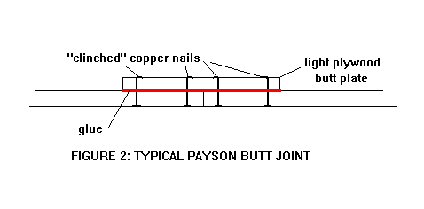

THE PAYSON TEAL BUTT STRAP...
Payson butt strap
I think this type of joint was described in Payson's great book INSTANT BOATS. I used it on my Teal which was my first homemade boat. The side panels were 1/4" thick on my boat, the bottom 3/8". The butt straps were 3/8" plywood, 6" wide. So the effect of the joint was similar to a 12;1 scarf on the 1/4" ply sides and about 8:1 scarf on the bottom. The nails were supposed to be copper, but I think Harold might have also suggested copper rivets or short bolts for fasteners.

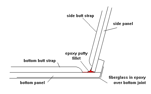

What's good about it? It's pretty simple to visualize and make. If the fastening is good you can make the joint and go right on building without waiting for the glue to set. You might do that with the sides, for example. Another neat thing about this plain butt strap joint is that, with a typical flat iron skiff type of assembly, the bottom panels need not be joined before assembly onto the hull. In that case you will have the hull inverted on sawhorses ready for the bottom. Then you put the first bottom piece on attaching it to the sides. Then you install the first butt strap at the end of that piece. Then you install the next bottom panel to that butt strap and the sides. And so forth until the entire bottom is planked, like laying bricks.
I might mention now that I think butt straps and plates should be well rounded at the ends to avoid trapping dirt and moisture. In boats that have taped seams I advise stopping the butt strap short of the edge of the panel so you will have room to run the tapes undisturbed. This is especially true of butt straps on the bottom. You must have a clear limber channel around the perimenter of the bottom. In that case I stop the strap about 1/2" short of the side, fill the little gap with epoxy to keep the water out, and tape over the bottom of the joint with glass tape and epoxy. Usually I don't put glass tape over the outside of the side panel joints. But butt joints in any deck should be well sealed with glass and epoxy. Here is an end view of the treatment:
joint end view
What's bad about the plywood strap? I think in Maine you aren't a man until you've made a boat with clenched copper nails or rivets. Not so where I live, can't buy them any place I know of. I got by with bronze boat nails but they really aren't flexible enough for the job. They didn't look too cool. And the edges of the plywood butt straps don't look too cool either, wanting to have gaps and splinters showing. It takes a while to finish them. And, of course, you have a lump at each joint and folks will ask, "What's that?"

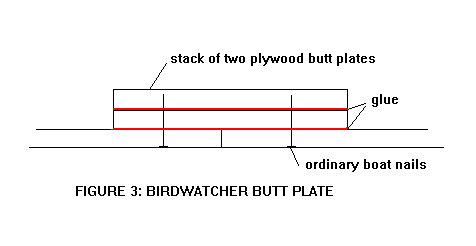

THE BIRDWATCHER BUTT STRAP... Birdwatcher joint
When I built my Birdwatcer in 1988 I think I piled on more layers of plywood straps such that I wouldn't have to bend over the nails. And by that time I was more expert at finishing the edges of plywood. It worked but it was very obvious that I could have done the same thing with regular lumber and saved a bit of work.

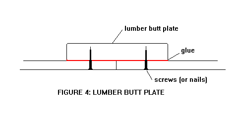

THE LUMBER BUTT PLATE...
lumber butt plate
This is what I like to advise now. Not much to it. Very quick and easy to make. Some say it looks too clunky for their tastes.
If there has been any structural problem with the above butt plate it is at the ends of a plate that joins bottom panels, ending short of the sides to allow a limber path. If the ends of the plate are not solidly glued and fastened to the bottom panels the butt plate will eventually loosen at the ends. I think that is due to the rapid change in flexibility in the system where the plate suddenly ends. A better solution might be to taper the end of the bottom butt plates starting maybe 3" in from the end of the plate and tapering down to maybe 3/8" thick at the ends. That will allow a gradual change in the flexibility and prevent a stress riser at the end of the butt plate. By the way, for any bulky butt joint care must be taken in design to see that the joints don't fail in places where the butt plate will be in the way.

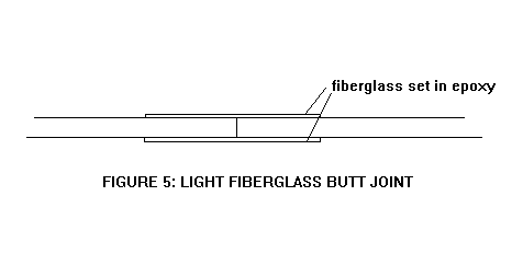

LIGHT FIBERGLASS BUTT JOINTS..
light glass joint
Both Harold Payson and Dave Carnell presented this one to U.S. readers in the '80's but I'll bet the English inventors of taped seam boats did it earlier. Simple as can be in theory. Just a layer of fiberglass on each side of the plywood.
Dave Carnell presents lots of details at his web site. He has done scientific load tests of these joints and says the joint will be as strong as the base wood if you use one layer of fiberglass cloth in epoxy on each side of 1/4" plywood, two layers on 3/8" plywood, three layers on 1/2" plywood, and four layers on 3/4" plywood.
I used the glass butt joint on my Roar rowboat but went back to wooden butt joints later. At first it would appear that the joint is easily made by laying the ply pieces on the floor, taping one side with fiberglass, waiting to cure, flipping the panel and repeating on the other side. But I found that plywood on its own often does not want to lay flat enough to get a smooth fit, so I had to place the joint over a board and screw the pieces down flat. Next the idea of flipping the panel with only one side taped doesn't work well because that one layer of glass has little strength by itself. But it can be done carefully. Better yet is what both Payson and Carnell advise: glass both sides at once. Lay the first side of fiberglass layers wet with epoxy on a protected flat surface, lay the plywood to be joined upon it, lay the second side of fiberglass over the top of the joint, cover with plastic sheet and weigh down with concrete blocks. The plastic sheeting not only protects everything from gooey epoxy, but it should provide a smooth final finish and if you are lucky no filling or sanding required afterward.

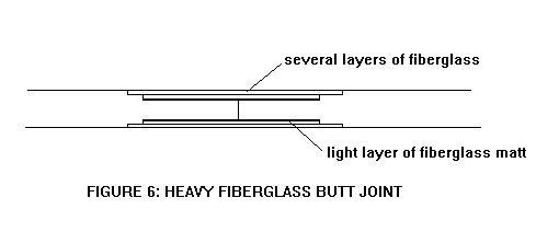

THE PAYSON HEAVY GLASS JOINT...
heavy glass joint
Harold Payson did a little more work on the glass butt joint. I'm doing this from memory and hope I'm getting it right. To hide the build up of glass on a thicker sheet of plywood he recessed the surfaces roughly with a sanding disk in a drill. Then he added a layer of light fiberglass matt to the wood before pasting in the glass. Fiberglass matt is generally thought to provide better adhesion to wood than glass cloth although by itself it has little strength. Harold is big on using polyester resin on his boats instead of epoxy so perhaps the matt is more important for the polyester users. But you can see the advantage of the system: the final joint can be more or less invisible as the multiple layers of glass are recessed.

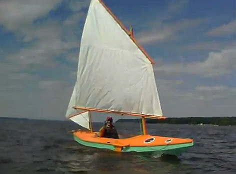

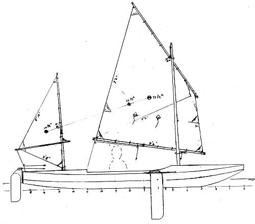

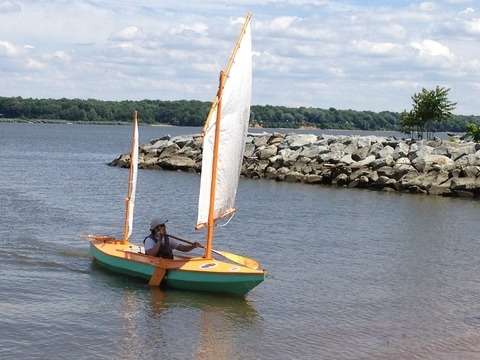

PAULSBOAT, SAILING CANOE, 15' X 3', 120 POUNDS EMPTY
I had a request from Paul Moffitt, of the famous sailing Moffitts, for a sailing canoe. Now, a "sailing canoe" can mean a lot of different things. But to me the sailing canoes that you read about from the late 1800's were what we both had in mind. I had always put off designing one because I had the idea the usual sailing canoe design is too wide to be good with a paddle, and too narrow to be good with a sail. Many of the old classic sailing canoe designs were actually small decked over rowing boats that were wide enough to sail with some stability. I guess there were still called canoes because of their double ended shape and perhaps because they had recently evolved from true canoes which were rigged with small sails.
Anyway, it was going to be a compromise. Paul also wanted some capacity to carry some camping gear. So I drew Paulsboat. It was really based on my Larsboat which in turn was based on my Toto which in turn was based on the Bolger/Payson multichine canoe, etc. To get more sailing stability and more capacity Larsboat was widened from 30" to 36" and the bottom plank also widened 6". I gave the cockpit a 7' long open space with the idea that the skipper could camp inside the boat, which by my experience is quite superior to sleeping outside. For one thing setting up a shore tent will usually quickly bring down the law almost anywhere and sleeping inside discretely will not. I slept in the smaller Toto many times. Anyway, the cockpit is large enough to float two adults and is between buoyancy/storage chamber fore and aft. Access to these chambers might be difficult. I've shown them with large deck plates in the bulkheads but you likely won't be able to reach way down in them. I've noticed many folks put several smaller deck plates in the decks, as Paul did, to allow access. The deck plates also allow for airing of the chambers and if you ever build in a closed box and don't allow for airing you can expect rot very quickly.
The sail rig was pretty well copied from the old sailing canoes which often used something similar. I stuck with my usual leeboard for lateral area and placed it such that the boat should handle well under main sail alone. The rudder was something to think over. Many of the traditional canoes had a tiller with complications used to get the tiller to clear the mizzen mast. I wanted to avoid all that since it usually means some metal forming and welding and that will turn off many builders quickly. What Paul wanted was to be able to steer with pedals and had aquired from Duckworks some plastic kayak pedals where the pedal did not pivot but could slide in a groove a total of 14". Well, let me back up a bit. The rudder drawn simply has a tiller horn on each side, each 12" long. That might sound long but in reality it would be like steering with a 12" long tiller and then it seems way short. The idea was to tie a line to the horns that looped around the cockpit through pulleys forward such that you could steer with your hands by pulling on the line. Not an uncommon idea. The downside I thought would be that at times you would hardly have enough hands to steer and work the sails. So Paul got those pedals and installed them connected to that steering loop. He says it all works fine and he was able to reduce the length of the rudder steering horns. But don't give up on the idea of the continuous loop around the cockpit. With the loop you could let your passenger steer as you take a nap.
We pondered a bit about what would happen in a capsize. With the decks and flotation chambers it should float high with little water inside but getting back in could be a challenge. I am pretty sure you should prepare, and test, a stabilizing system which uses a float attached to your paddle which is somehow secured across the cockpit to steady the boat enough to allow you to enter over the side. Nothing new about that idea. You probably need to be somewhat strong and nimble.
Paul has been paddling with a single paddle and reports no troubles. Having the pedal operated rudder would be a big plus especially with the single paddle. I have a feeling we did a good job compromising on the width of the boat.
Construction is the usual taped seam requiring six sheets of 1/4" plywood. It is going to weigh a bit, no getting around that, but Paul has been cartopping without trouble.
