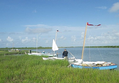

Chuck Pierce sent this great photo along with the note, "My friend Pehr Jansson sent this to me-he took this as we were preparing to leave Army Hole on this years' Texas 200. From front to back, Pehr's PU Pram, my Mayfly 14, Stan Roberts' Family Skiff, and Lee Morgans' Mayfly 16."

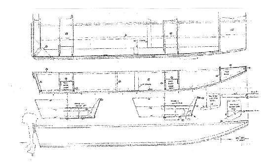

NOW, let's say you have 12' instant flat iron skiff plans in front of you and the sides are drawn with dimensions every 24" to give you the shape of the panel. And you really want a 16' boat. Remember that a boat that is 12' long overall will have side panels longer than 12' because it will take a curve on a way from bow to stern (usually, not true for Puddle Ducks and such with straight sides). Can you simply redraw the sides spacing the dimensions at a proportion of 16/12 to get the longer boat?
In real life I would say "yes", it will work. It is not exactly correct but in real life you won't tell any difference. This is especially true of a simple flat iron skiff since its bottom will not be precut to shape, the plywood is simply flopped atop the assembly and cut to shape.
Note that the shapes of the forms and bulkheads will not change but the edge bevels will as will the stem and stern pieces if they are raked. So you will have to figure as you go. I'm pretty certain this method has been done lots of times. And, by the way, if you are building with taped seams then you worry not about bevels.
THE NEXT STEP.....

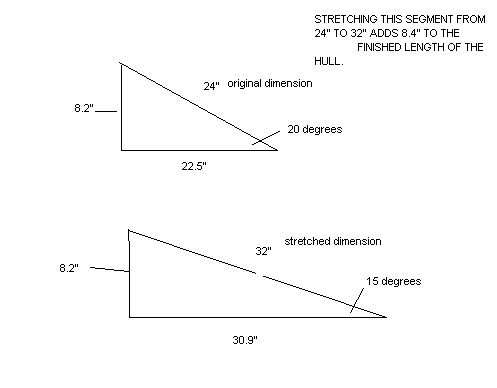

Now let's say you have an set of instant boat plans for a 12' multichine hull and want it in 16'. Can you simply expand all the side, bilge and bottom panels by a factor of 16/12 and get it all to fit? Well I say, "Maybe but I don't really know." With the simple flattie it will work because only the sides have been stretched and the bottom simply cut to fit. The actual hull shape won't be a pure stretch of the 12' design but I think the shape error will be small and won't be noticeable. What happens is that if you stretch the dimension spacing at the boat's center by 8" the finished boat will get longer there by 8" because the sides are there parallel to the boat's length. But near the stern or stem, where the panels curve inward, the same 8" added spacing won't give you the same 8" added boat length. For example if the panel curves inward at 20 degrees at the stem (sort of typical) a 24" panel gives only 22.5" of boat length. The 16' boat curves are less severe than the 12's. So the 12's bow angle is 20 degrees and the 16's bow angle is 15 degrees. That panel stretched to 32" will give boat length of 30.9". Like this...
What you were thinking about was a hull length stretch there of 16/12 x 22.5" = 30". So it is there about .9" longer than expected because of the difference in bow angles (because we are just making it longer and not wider). There are twelve sets of side panel dimensions in this example but the above would be the worse case. I would expect a boat streched this way will end up a few inches longer than the expected 16'.
But....if you were to expand all the panels of a multichine this way there is another worry. The sides, bilges and bottom don't usually bend to the same curve and so the curve errors that happen on the sides, bilges and bottom might all be different and you may get significant gaps in the assembly.
Given the example of the sides, I would say that stretching a multichine this way will work with some but not all the time. But it could still be done if you work this way. Don't cut the bilges and bottom to line yet (always good advice even when you aren't stretching). Start the assembly as usual with sides attached to the forms and bulkheads, stem and transom. Now the shape is really defined and you need only fill in the holes left for bottom and sides. "Survey" the shape of the bottom either by making a pattern or just flop the oversized bottom panel into place and trim to fit and install. Then the same with oversized bilge panels. That is how I would do it. Make sure the initial assembly is straight and sturdy as you push and shove bottom and bilge panels into position. It's sort of like sculpting, more like old time building. By the way my Toto was "designed" this way since back then I didn't know how to do the twisted bilge panel expansions with a computer.

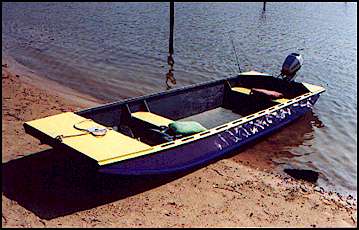

But myself I would not do that. The slam dunk easiest and best way to stretch a boat is to use a simple "plug" in the center. At the boat's widest beam the panels should all be parallel to each other. Just imagine cutting your 12' boat apart at the widest beam and inserting a straight 4' piece between, joining all three pieces together and off you go. The bevels of the bow and stern section have not changed at all. The extra length has been added to the boat's greatest cross section where it will give the greatest added buoyancy and capacity and passenger room.
I think large steel ships are routinely lengthened this way - cut them in two in the middle, spread the two ends apart as required, and weld in plates to rejoin. I am ignoring the huge amount of interior work needed and even the homebuilt boat may need some added bits to stiffen. I guess I forgot to mention that the longer boat will have greater stresses in the middle. I don't think that is much of an issue with the typical plywood homebuilt - I've never heard of one coming apart in the middle, but it would be an issue with stretching out a tanker which sometimes do break in half.

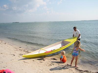

But, you say it won't be sleek. It will look slab sided, just like big ships are all slabs with pointy ends added. For some reason it is not as bad as you might expect. I've drawn a few boat with constant sections in the middle, just with the idea that someone will want to lengthen/shorten without much use of the moaning chair. I did it long ago when I stretched Toto...
with a 30" plug to get Larsboat...
To make serious room for a second paddler. The 30" straight plug just isn't noticable.
