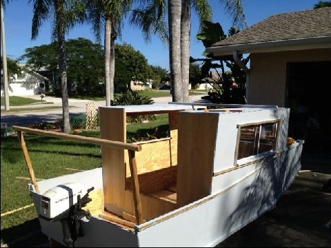

Mark Smith in sunny Florida plugs away at his Dockbox deluxe.

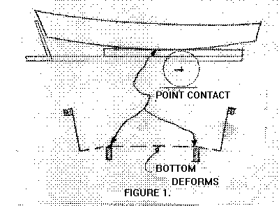

Most likely the trailer you get will be set up to carry a flat bottom or V bottom fishing hull with a long straight run. The bunks usually are padded 2x4's running fore and aft.
Most likely you'll have to scrap that bunk system and build a custom set for your boat. Most homebuilt sailers and rowboats have enough rocker in their bottoms to contact those longitudinal bunks only in one spot. The entire weight bears on that one spot and the hull will deform there. See Figure 1 for what can happen. We'll return to this subject after we've found the best place for your boat on the trailer.

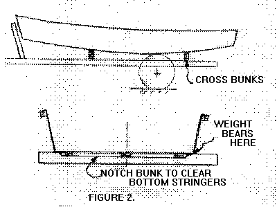

With the boat located fore and aft, we'll size up some custom bunks. I can think of three ways to support the typical rockered hull and none include the 2x4 longitudinal bunks that come with most trailers. See Figure 2. Here a flattie is mounted on two crosswise bunks, one forward and one aft, such that the weight bears only on the chines. The chine corners are very stiff and strong and nothing will happen to her.

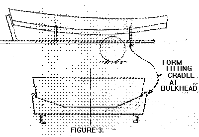

Look at Figure 3. Here a multichine is supported similarly, but with no hard chine to carry the load, she must be carefully cradled. The cradles should be located directly under hardpoints such as bulkheads to avoid deforming the hull. A V bottom hull with a lot of rocker should be supported the same way.

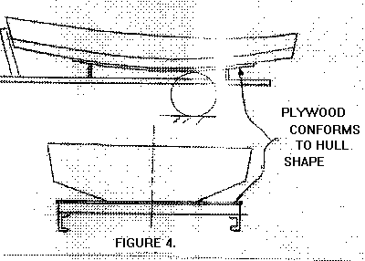

Look at Figure 4. Here a plywood sheet as wide as the bottom forms a "sling" and distributes the load over a wide area instead of just at a couple of points. This is probably the most gentle system and has other advantages such as being able to do general hauling. This type of bunk doesn't need padding, but the other two types should.

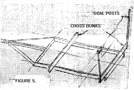

Trailers should have at least a pair of goal posts to keep a boat well aligned with the trailer as the boat is floated in a crosswind. See Figure 5. Without the posts, launching and retrieving solo in a crosswind is about impossible without getting wet and strained. You may not need posts if you have a V bottom sitting in high cradles which act as goal posts as in Figure 3.
I've seen fishermen use very tall posts with trailer lights mounted on the tops. Not only does that preclude having to disconnect the lights while launching, but the trailer is better illuminated in the driver's rear view mirror at night. (That's a problem with normal trailer lights. Sometimes you can't see your own boat and trailer tagging along behind you.) At any rate the posts need to be tall enough so they stick up about a foot out of the water when the trailer is immersed. Then you know exactly where your trailer is.
To launch a boat from a trailer with goal posts, you back down the ramp until the boat is almost totally afloat - perhaps only the bow is resting lightly on its bunk. You disconnect the bow line, push the boat aft, totally afloat now, beyond the goal posts, and pull the boat back to the ramp on the downwind side of the trailer.
People who go fishing everyday get very good at this. They untie the boat before backing and retie the bow line to the trailer with lots of slack. They back down the ramp until the boat is nearly afloat, jab the brakes, and drive forward a bit. The boat jerks off the trailer when the brakes are applied, the bow line catches it after it has drifted past the end of the trailer. Then the boat is pulled forward by the vehicle until its bow rests gently on the ramp. The driver now only disconnects the bow line which is totally high and dry at this point. Essentially he's launched his boat without getting out of his car!
To retrieve you put the trailer on the leeside of the boat and, HOLDING THE BOW LINE, push the boat beyond the goal posts and let the wind (or momentum) drift it between the posts. Then pull it onto the trailer with the bow line, secure it and drive off. Power boaters often just drive their boats onto the partially submerged trailer.

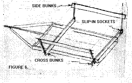

With a goal post on each side of your trailer your boat can still try to escape at an angle between the posts. The solution is another set of posts forward with padded boards connecting to the aft posts. See Figure 6. You create a slot in which to berth your boat. It's probably the most secure bunk system.
I recommend you make the side bunks fit into sockets for quick removal. I did that with my 24' Birdwatcher and have no trouble launching and retrieving solo. Here's how.
Arriving at the ramp I take close note of the wind direction and remove the bunk that will be upwind during the launch. I back down the ramp until she's just afloat, tied loosely at the bow, and the wind pushes her against the downwind bunk. Now I need only untie the bow and pull the boat off to the upwind side of the trailer and beach it next to the rig. I don't have to push the boat aft through the goal posts and float it to the downwind side of the rig, which can get pretty frightening with a big boat in a big wind. The downwind bunk is always there to catch and hold the boat. Retrieval is the reverse of the loading.
