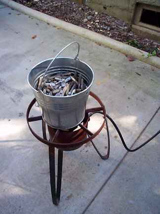

This is Tidmarsh's setup.
Looks like maybe a plumber's melting stove with a pail of wheel weights on top. I also use wheel weights which I got from my local tire guy. For heat I use the normal campers propane stove. For a pail I use a coffee can with a handle bolted to it. There is a pour hole on mine about half way up the side of the can so I don't have to tip the can all the way to pour the lead and there is little chance of it sloshing over the top by accident. The pour hole is too small to pass the steel clips of the wheel weights (they float nicely on top of the molten lead).

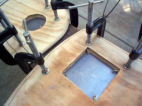

Here is a close up of the holes prepared for the lead pour:

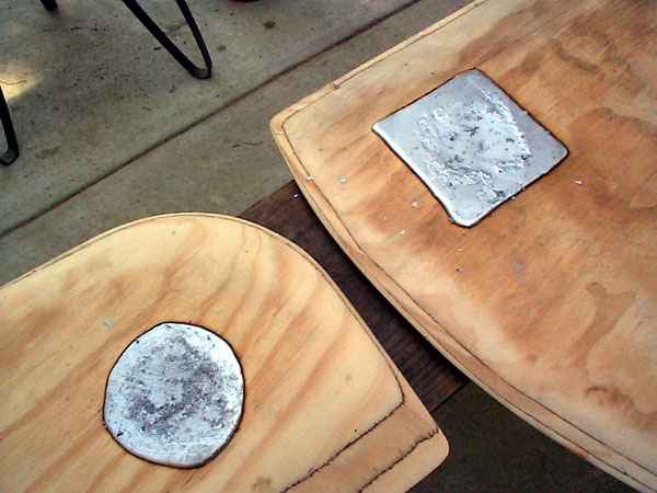

They are clamped to a metal plate the will form the bottom side of the casting form. Note the screws in the corners of the pour holes. The idea is that the lead will flow around the screws and harden, locking the lead solid to the wood. Use nails or screws that won't rust. I might add here that it is also good to bevel the edges of the holes. The lead will flow into the bevels and form flanges that also help to trap the lead.
Now the lead is poured into the holes, slightly overfull to allow for some shrinkage when the lead cools.
That is about it except sometimes shinkage will cause the lead block to loosen. I found I could put the lead over an anvil and whack it with a hammer. That flattens it a tiny bit but expands it at the perimeter, tightening it in the hole. You might have to trim the lead flush with the wood's surface. Lead likes to clog files and sandpaper so I found a rasp is a good start and something like a 20 grit disk gets it down to where you want it.
