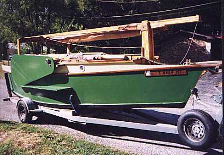

...was on this sharpie, "Endeavor", built by Karl James.
You might recall that Karl had built the prototype of my Jewelbox design a while back and his brother Pete had built the Petesboat design that was based on Jewelbox. But even back then Karl had told me that he was thinking about a trailerable version of Bolger's Black Skimmer. As his thoughts advanced Karl had blended in ideas from Bolger's Martha Jane, in particular the yawl rig with a balanced lug main, and water ballast.
You can see from the photos that his rig folds very neatly on its tabernacle down onto a gallows on the aft end of the cabin. All of the rigging is kept in place ready to go. The main sail is bundled up there too to port of the stowed mast. The sail is wrapped in a velcroed cover full length to keep road dirt off. (There is also a small mizzen sail stowed on the roof of the cabin.) Anyway, to rig the main Karl has only to raise that mast by walking it up, secure the mast heel in a clever way we will talk about later, remove the sailcover, and hoist the main. I don't recall how the tack and sheet lines are attached but they could be left attached to the yard ready to go, or snapped into position just before hoisting.

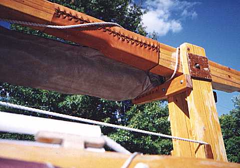

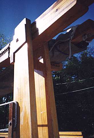

Let's look at the the aft side of the tabernacle.
Karl said the mast here is the same one he used on Jewelbox, which means it is 3-1/2" square and solid. But you can see that in the region of the pivot bolt he has laminated another layer, probably 1-1/2" thick, onto the aft face of the mast such that the pivot bolt does not go through the main meat of the mast, very important I think since the pivot bolt area is probably the most highly stressed part of the system. (Karl added the beautiful laced leather to keep the boom from chafing the mast.)
That would mean the mast is 3-1/2" x 5" in the region of the pivot bolt. So the tabernacle verticals are probably 1-1/2" x 5". In the region of the pivot bolt the verticals are plated with I would guess to be 1/2" plywood. A good idea to prevent splitting of the lumber. The pivot bolt itself appears to be maybe 1/2" in diameter. The pivot bolt takes the compression load in the mast in this system. And it resists the tendency for the mast to spread the verticals apart with side loads. So the entire unit works together. Also below the mast is a cross bar that extends out one side to support the stowed bundle of boom, sail and yard.

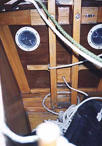

Here is a view of the lower part of the tabernacle, looking down into the bow well:
You can make out the mounting bolts, they look like about 1/2" diameter, going through blocks in the bulkhead. I'll let you drill those holes through those edgewise planks. There is also a healthy dose of thickened epoxy fillets. Also note that the vertical planks are mounted clear of the bulkhead by those blocks mounted to the bulkhead and I would guess the verticals are about 2" clear of the bulkhead plywood.

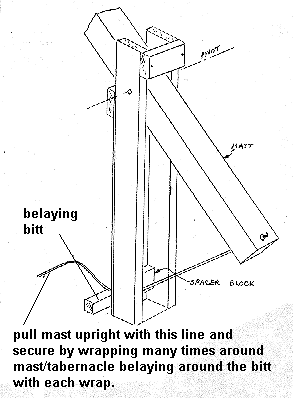

Now, if you look back at the overall boat photo you will see that the mast heel extends about three feet past the pivot, and swings down into the slot formed by the two verticals. Look closely and you will also see a rope going through the heel of the mast and going down into the bow well. Look again in the bow well photo and you can see that same rope running through a hole in a wood plate towards the bottom of the tabernacle. When the mast is walked up to vertical, that rope is held in hand and tightened when the mast is upright. To lock the mast in position, that same rope is belayed many times around and around the mast and the bitt you see running across the back of the tabernacle. That's it!

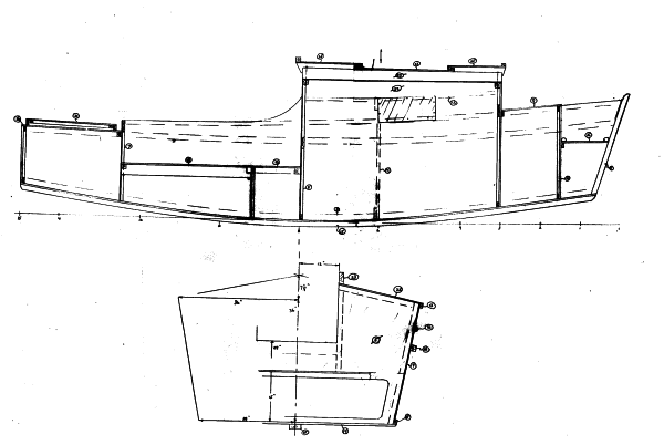

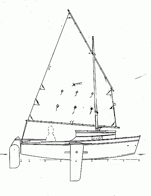

When I drew Caprice last year I had seen Karl's rig and tried to copy it. Here is my interpretation of it:

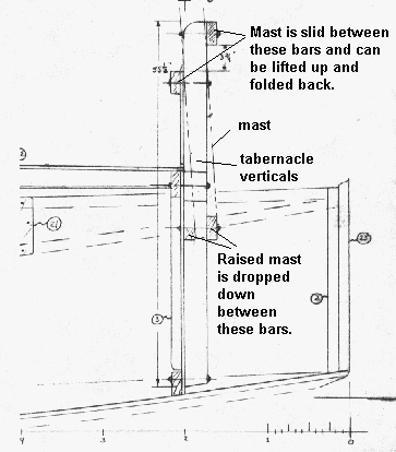

I think Karl's system is the simplest and best I've seen. The locking of the mast in the vertical position is often the trickiest part and Karl solved that with a simple rope. (Karl sails his boats very hard and I'm told this tabernacle has passed all the tests.) On some of my other tabernacle designs I used no pivot bolt, but had capture plated fore and aft at the top of the verticals like this:
This is closer to the Birdwatcher system in that you walk the mast upright and then lift it up a bit to drop it into a step. On other designs I've used the pivot bolt but also showed a pin at the mast heel to secure the mast - easy to draw but reaching down to fit that pin into position might he hard in real life. I think on Bolger's Long Micro the heel of the mast is locked into position with a long wooden plate that hinges just below the heel. So that plate is layed flat while the mast is raised, then pulled with a rope up into position and that rope safely belayed.
