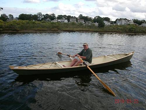

Jake Millar rows his rocketship! This is the Batto design which is a plywood update of Pete Culler's Bateau design. Jake has added both old and new, adding Culler's original trim and Jake's own sliding seat (the original and my plans show a fixed seat).

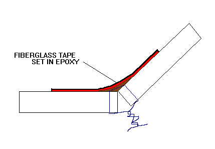

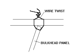

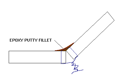

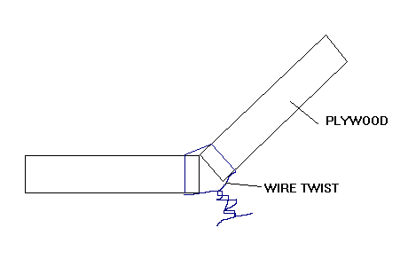

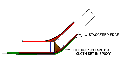

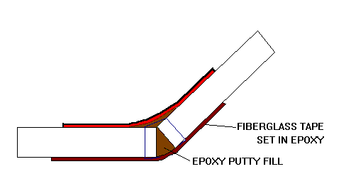

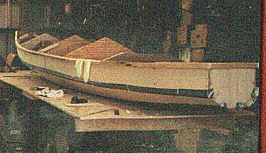

(This is how I do it. Others have their pet methods.) Not much too it. My boats are all designed from the inside out, so to speak. The dimensions are arranged such that the panels should make kissing contact on the inside edges as shown above. Usually the project is upside down at this time, sides, bulkheads stem and stern fastened together, and you are trying to put the bilge or bottom panels on with taped seams. You put the panels into position and drill pairs of holes about every 12" around the perimeter, about 1/4" in from the edges. You take pieces of soft wire, I prefer stainless steel aircraft "lock wire" but almost any wire will work if it is pliable, and cut lenths about 6" long and form them into a long U shape like a staple. Get inside the project and push the wire staples up through the holes so that the ends now stick out through the outside. Get outside with a pair of pliars and twist the wires until they tighten the panels together. If you overtighten you might break the wire or tear the wire right out of the wood. Eyeball the joints to make sure they are fair. You can open a joint up to maybe a half inch if it will help. If two panels are binding too tightly, you can run a saw down the joint to loosen it up. I think a small gap or V is preferred because it allows resin to flow in and seal the ends of the plywood. But the joint fit is really not too critical.
taped larsboat
taped dory
