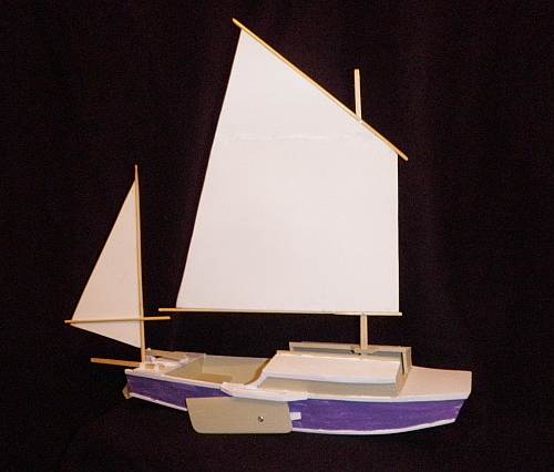

John Goodman quickly built this Hapscut model. Now on to the real thing!

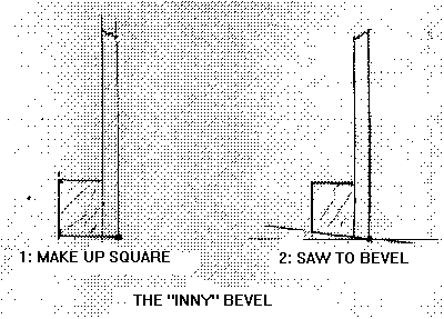

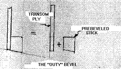

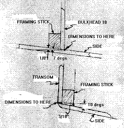

BULKHEAD BEVELS

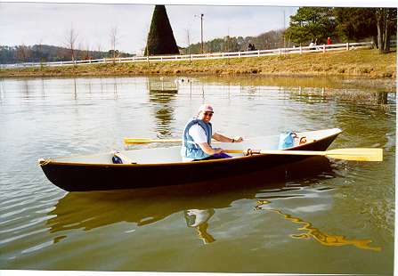

SPORTDORY

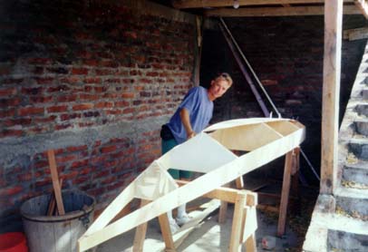

SPORTDORY
