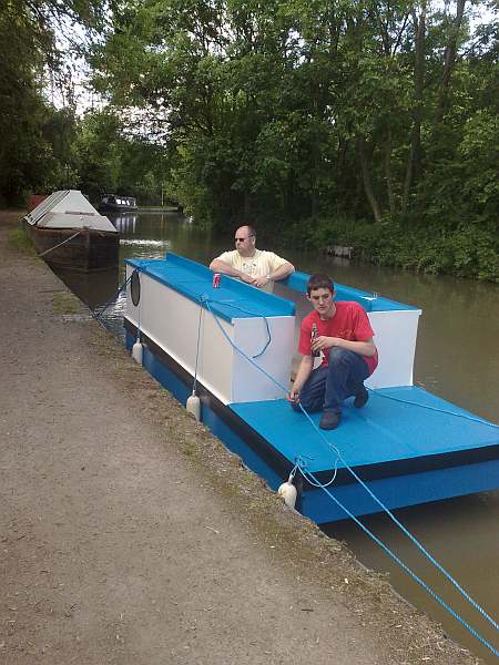

Mick Cross plys the canals of Jolly Olde England in his Harmonica. Actually he has two of them.

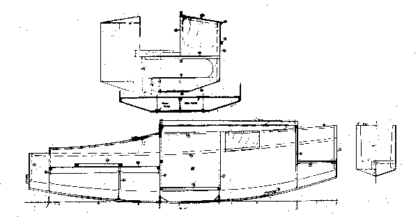

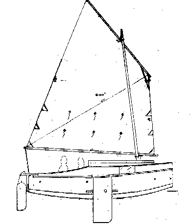

Blobster
Prototype plans for Blobster are $30.
