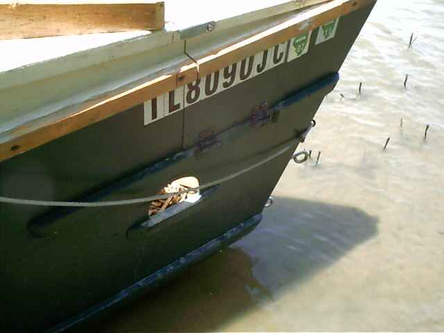

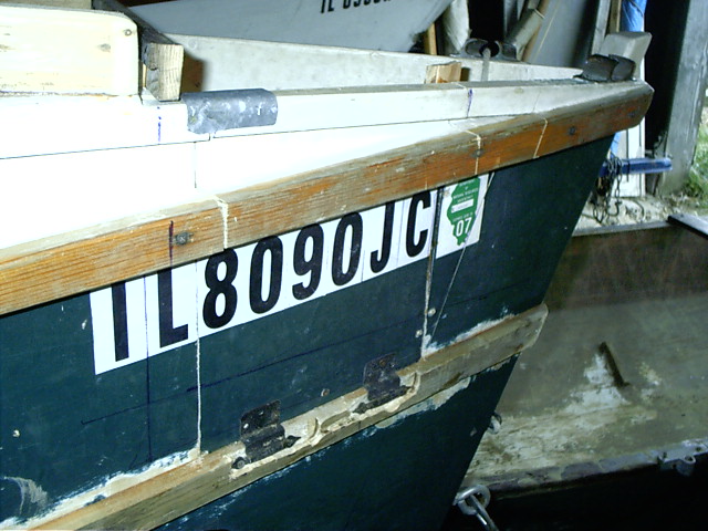

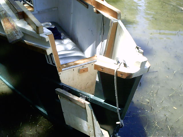

...I want to report on the new boarding door arrangement. As you may recall I chopped away at the fore deck and bulkhead and then made a swing down door in the bow to allow easier boarding from the beach. Here is the door during construction:
And here it is after cleaning up (but I kept the rustic hinges). With all the flooding we've had this year I couldn't really find a beach so here she is pulled up onto a flooded agricultural field:
Unlatch it, swing it down and leave it. Pull out the drop board from the bulkhead to give an easy step to the shelf in the front of the cabin:
I can get there is one step now. Before it was about 40" hoist to the foredeck, then swing legs around for a 40" drop into the cabin with maybe a little parallel bar action on the way with the deck beams.
I suspect the door and dropboard are overkill, at least for calmer waters. I've left the door down by mistake a few times already. It is well above the usual waterline, especially when the bow lifts under power. There is an added benefit that I had not guess at in that it is easier to see over the bow now with the dropboard removed. A few inches seems to make a big difference here.
So it was a big success! I'm not going to include the mod in the drawings - it is the sort of detail that I don't like to see on drawings myself. Options that can weigh down a first time builder in particular. Better yet a set of drawings for a simple project that will leave him saying, "I can do that!" Then ten years later he can add a door, like I did.

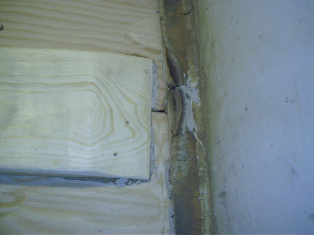

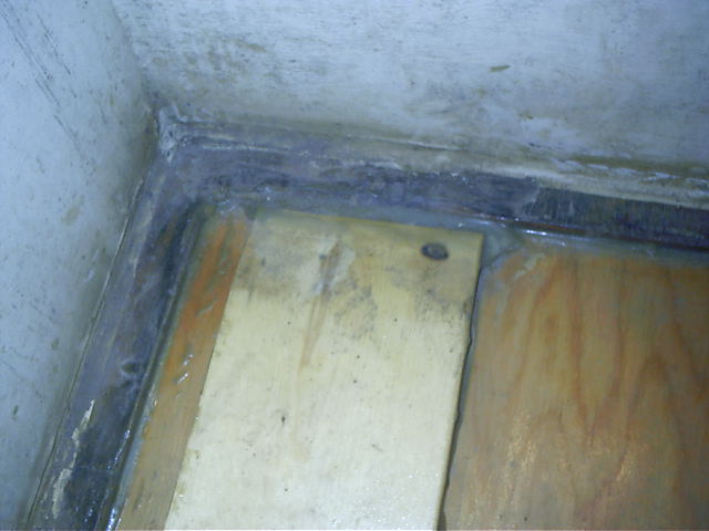

For butt plates I went to using 1x6 boards, up from the 1x4 of the first bottom since those were troublesome. I cut them short of the sides as I usually do, like this:

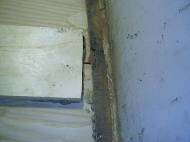

The old idea was to keep the butt plates short of the sides to form a limber channel where water could flow freely. But those old butts started to separate from the bottom right at the ends near the gap. My theory was that the sudden change in stiffness at the end of the butt plate caused a stress concentration, etc. etc. and if you sound educated you can explain away anything. So this time I tried something different. First I tapered the ends of the butt plates to ease that sudden change in stiffness, like this:
At that point I had the grand idea to taper it to nothing and put epoxied glass from the tapered plate over to the side to complete a structural joint. Then I found I couldn't really taper it to zero. Then I filled the gap with epoxy putty (my favorite thickener is baby powder) like this:
And then with the Rend Lake messabout coming fast I stopped work, left off the glass and went boating. You will note also that I put a fillet completely around the inner joint of the new bottom. I did that with the old bottom too and had no problems with rot at all at the bottom/side joints. The fillet prevents water from wicking into the joint methinks and also keeps dirt out of the joint. Thus no rot.

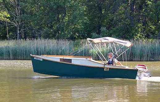

Then off to the lake. First time in the water with the new bottom was at Rend Lake messabout. NO LEAKS! Although we watched it closely and kept it at first in thin water just in case. Paul Breeding got this photo of me setting off:
STILL NO LEAKS! Outside this quiet cove were whitecapped waves going maybe 2' high. I went out into it for a short time and pounded around a bit. No significant bottom flexing. I chickened out at the time being concerned about my motors which had not been run in two years, the backup motor would not start at all, and went back into the cove. In subsequent trips I have seen no leaks at all and no significant flexing. Nothing has broken. Another success? It took at least a year to see the problems with the old bottom so the jury is still out. This is one case where I did change the drawings, in fact I did that a long time ago, increasing the bottom thickness to 1/2". I'm still showing on the drawing the original stiffener layout of three 1x4 boards instead of a single 2x4. We will see how that works out too but the the single 2x4 is easier to install and probably stiffer than the sum of the three 1x4's. And I think the single stiffener joint is less likely to cause problems than the triple stiffeners since those joints tend to become rot traps.

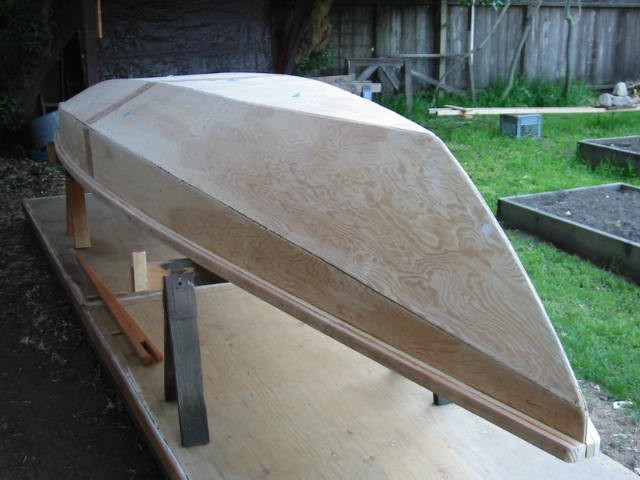

Steve Chambers out in California had built a Roar2 very quickly, in two or three weeks as I recall, and had gone off rowing with it and liked it a lot. He started looking for a design to learn sailing. He was thinking of my old Woobo design but got to really like the Roar2 bow which evolved from Toto. Could the two ideas be combined, a Woobo with a Toto bow. Would it be called Wooboto. Why not? And thus it came to be.
I knew that Steve worked quickly. He started straight off and I saw no need to release Wooboto in a prototype stage since it would be a "done" design in no time. Steve did a great job of it.

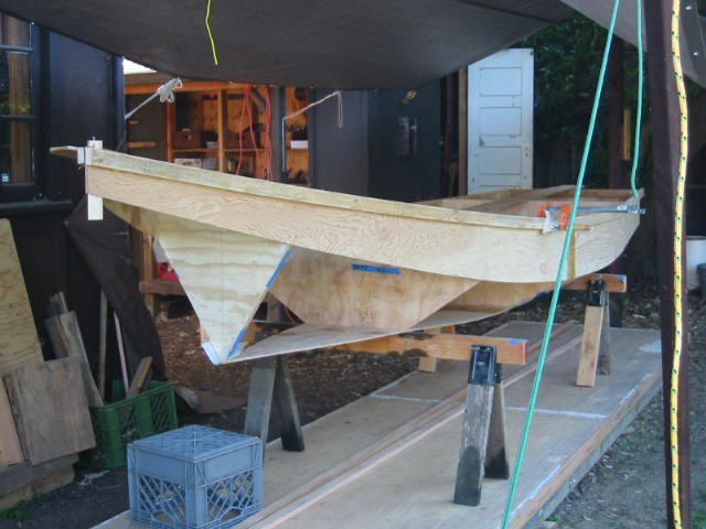

I wanted to show this photo to illustrate the one problem he had with assembly. He assembled it as I called for in the drawing with the sides attached to the forms and bulkheads and the wales added as shown. But the problem was that the sides, especially in the bow, are flimsy at this stage and the stiff wales pushed the sides down an inch or so as the wales themselves were bent upward. He noticed the problem at this stage and adjusted the forward form so that the bottom did not bend downward too, then he had to adjust the bilge panels a bit to fit. So from now on with designs of this shape I am going to change the assembly method so that the wales are not added until the bilges are installed to stiffen those narrow sides. Steve quickly pressed on to this stage:

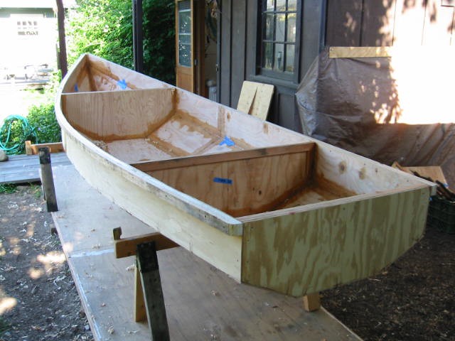

You see that Wooboto has a simple spare structure. No interior seats and no motor well. And then on to this:

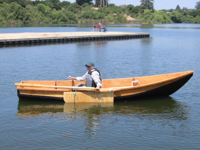

A quick clean job. By this time he had already made a polytarp sail from the Mayfly drawings shown in my book, a 75 sq ft job. But he launched it first as a rowing boat without its decks:

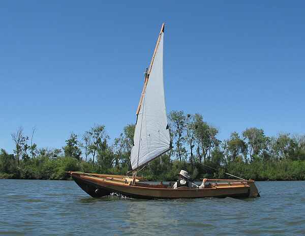

He made those oars too. He practiced sailing for a few weeks:
And then off on a cruise of several days with a club of pretty boats in the Sacramento Delta area as I recall:
