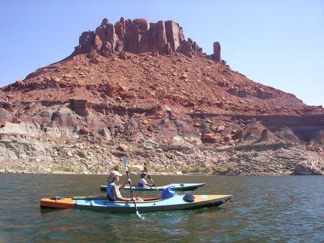

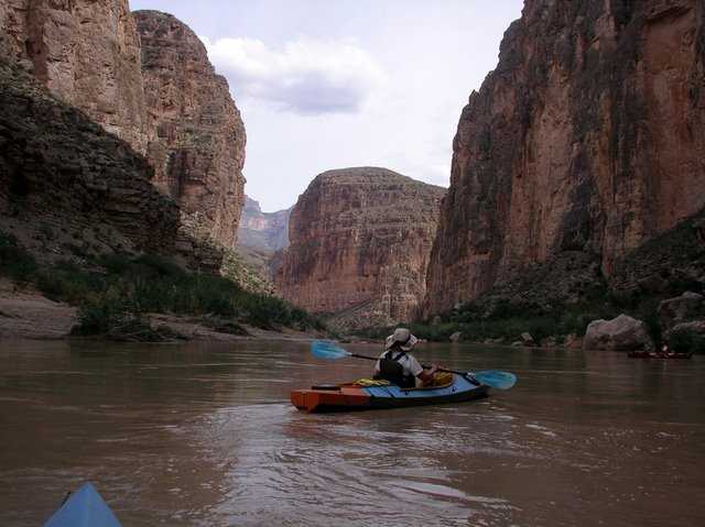

Duckworks' Sandra Leinweber paddles her new RioGrande on the Rio Grande.

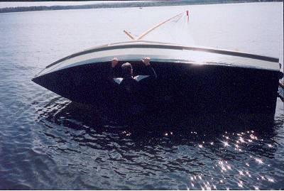

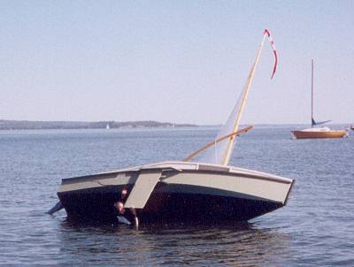

This is a rerun of the 15sep99 issue which featured a capsize test done by Herb McLeod on his then new AF3. I want to keep this one up front because it demonstrates what you need to do when you capsize a sailboat which is not self righting, but rather is self rescuing. That is you can get it back upright and going again if you are properly prepared and if the boat, like AF3, has ample built in flotation or airboxes to keep it floating high on its side as you recover. A few things I'd like to point out. 1) Herb's tests were done in very benign conditions and if you capsize in really bad conditions recovery could be a lot more difficult or impossible. 2) If you tinker with a design such that you remove flotation or airboxes or enlarge hatches or move them off centerline, etc., the recovery system may not work and the boat may swamp to the point where you cannot recover. 3) If you have a design with no flotation or airboxes at all, such as most any traditional open boat, recovery is about impossible because the boat will swamp completely and be unstable even if it doesn't sink.
And now on to our story...
AF3 CAPSIZE RECOVERY...

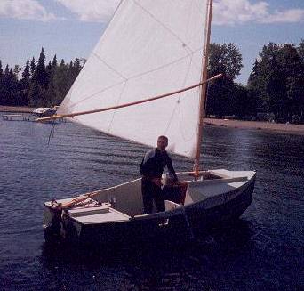

"Hi Jim:

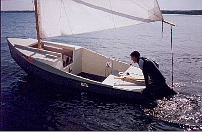

I now have 14 days of sailing in on the AF3. Alas, no pictures yet of it sailing on the water for the same reason as ever, no one else around to take a picture. Most days I am the only boat on the lake. Had one sail where we traveled 20 miles in one day. We did a 6.5 mile section that day in 1 hour 10 minutes with the small sail (69 square feet) on a beam to broad reach (lots of wind). Also managed to turn the AF3 on its side that same day. The AF3 floated well was easily uprighted, boarded and bailed out. Everything in the cuddy stayed dry and we managed to not lose any of our gear. But that is not what I am writing about....."
"I climbed on from the stern. I have a small step on the stern that also doubles as a support for my mast cradle. Iput my hands on the stern deck and placed my foot on the step and climbed on board. I must take a photo of this step and send it to you. With the step it was easy to reboard and I could walk around in the cockpit with the water in it and bail it out. Gord then reboarded over the side, which was much more difficult and his choice not mine."

The capsize with two men on the cuddy deck is no surprise. The boat was not designed for that. In fact the idea behind the slot top cabin is to do all sail handling from inside the slot. You can do that if the snotter attachment is kept within reach of a person with his feet on the boat's bottom. I suspect the high snotter attachment Herb is using is to gain more sail efficiciency. That is true enough but after having snotter tackles fail in one way or another I learned to keep the them well within reach.
Herb looks to have gone through all his tests without disturbing any gear because he had it well stowed. Very important.

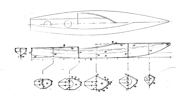

RioGrande, Kayak, 13' X 30", 60 POUNDS EMPTY
Sandra had been boating in a Toto double paddle canoe and in the larger Imresboat kayak. Both of those were designed for lake work but Sandra was making a lot of river trips and some of the rivers were not that lazy. What she had found was that the shorter open Toto was nimble for running rivers but had swamped in larger river waves on occasion. The larger Imresboat was decked over and never swamped and was long and lean, designed for long straight hitches. But on the rivers the current provided the propulsion and quick maneuvering was at times important. Could a compromise be struck? A Toto with an Imresboat deck?
An easy assignment. RioGrande is essentially a Toto (but slightly narrower) with the Imresboat style deck. I suppose it has the same number of parts as Imresboat. The fore and aft volumes are watertight and there should be no way to sink this thing short of destroying it. (Not to say that you could get back into it easily.) As you might imagine compared to Toto there are now more parts to make and those parts all have weight. So I'm guessing RioGrande will weigh perhaps 60 pounds, maybe more, where my original Toto weighed 45 when built of 1/4" plywood. The Leinweber's have proven you can use 1/8" to build these and it will get holed with a good hit from a river rock - they've proven both parts of that. By the way, small kayaks like RioGrande can't have much capacity. This one displaces 250 pounds and, given its empty weight, if you weigh more than 200 pounds you should look for a larger boat.

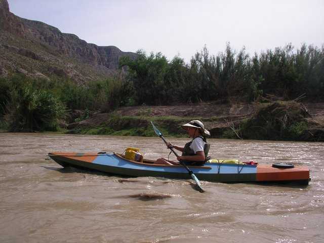

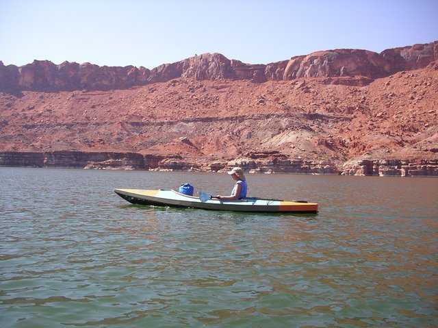

As you see in these photos RioGrande has been proven on the Rio Grande. Chuck built two of them, one from wood and another as a foam cored plastic boat. The plastic boat has hard glass/epoxy surfaces and is better at surviving river rock collisions than the wood. No surprise there but don't ask me how he did it. It is a South Texas experiment.
From these photos I gather the boat is loaded deep with supplies and camping gear. That didn't seem to affect it in any practical way but you could not load a Toto this deep safely.
Looks like four sheets of 1/4" plywood, or maybe 1/8" if you are feeling brave. Taped seam construction.
