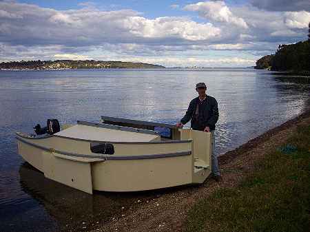

This is Shannon Boyd in Texas with his first project, a beautiful Toto.

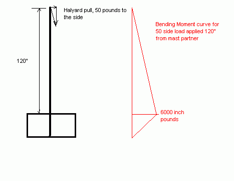

Anyway, with the side pull at the top of the mast the mast sort of acts like a big lever. The bending forces in the mast are zilch at the tip and then gradually build as you work to the mast partner. At the mast partner that side force meets its first reaction and that puts and end to the buildup of bending moment. So I would usually expect the location of the mast partner to be the location of the maximum bending in the mast. Add to that some compression due to the halyard tension and then the direct compression of partner against the mast and you have a somewhat complex picture. That's where it is most likely to break. I've had masts break elsewhere but only due to construction sins that I took a chance with.
NOW, LET US HANG SOME NUMBERS FOR EXAMPLE.....
Let's say we have 50 pounds of sail side force at the mast tip being dumped there by the halyard which gets it from the yard which is tied to the sail, etc. Let's say we have 10' of mast from tip to mast partner. Then we would have 10 x 50 = 500 ft pounds of bending at the mast partner. Let's call that 500x12=6000 inch pounds.
Let's say we have a 3" round wooden mast to start with. Recall that the maximum bending stress in a round section will be Mc/I where M is the bending moment (in inch pounds), c is the distance from the center of the section to the outer fiber (1.5" in this example), and I is the "moment of inertia" of the round section. A peak at the handbook says for a round section the I = .78 x r^4 or .78 x 1.5x1.5x1.5x1.5 = 3.9 inches to the fourth. With a predicted bending moment of 6000 inch pounds it works out as a maximum stress of s=6000 x 1.5 / 3.9 =2300 psi. Good wood is stronger than that, maybe up to 10,000 psi if you are rich enough for perfect Sitka spruce. But Lowes pine maybe, maybe not. No knots or cracks near the mast partner please.

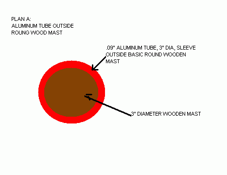

Ok, maybe the skipper is getting a little worried. He has a bunch of fat people on board for the first time and has stability he has never imagined before. The wind is picking up and he is in a position to "blow the sticks off" as they used to say. When he gets home he slides an aluminum tube over say the bottom 4' of the mast such that it extends from the step to a foot or two above the mast partner. It is a sliding fit, not glued or fastened so that the two pieces are locked together. But the fit is good enough that the wood and tube must bend together. They will share the load.

Next, we will calculate the EI 's of the two pieces. We already know the wood has an I of 3.9 and an E of 1.5 million, so EI is 5.8 million. If you knew the real applied load you could calculate the actual bend of the mast but if your mast is tapered then the I is changing constantly and it ain't easy and is best left to the student.
We didn't say how thick the aluminum tube was but let's say it is .09" thick and 3" in diameter. Another quick peek at the old handbook and we find I for a tube is 3.14 x t x r^3 so for this tube is would be 3.14 x .09 x 1.5x1.5x1.5= .95 inches to the fourth. So EI for the aluminum tube here would be .95 x 10 million = 9.5 million.
The tube is about twice as stiff as the wood. If they bend to the same curve, and they must if they fit together, then the tube will absorb about twice as much bending as the wood. So if the bending was 6000 in pounds, then I would expect the wood part to take about 2000 inch pounds of that and the aluminum tube about 4000 inch pounds. So the stress in the wood is greatly reduced.
LET US NOT CELEBRATE YET....
You have to check the stress in the tube next. Back to Mc/I. For the tube we already know the numbers. Stress here is = 4000x1.5/.95 = 6300 psi. OK, celebrate. Almost any structural aluminum can handle that.

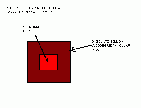

...Let's say the above mast was made with a square cross section, say 3" square with a 1" square hole down the middle. Can we reinforce it with a 1" square steel bar placed in the hollow center.
Same procedure as above. First the I of the new mast. Another quick peek at the handbook and we find the I of a square is (a^4)/12. So for this square mast we start by taking I = 3x3x3x3/12 =6.8 inches fourth. But the center 1" is hollow so we must subtract that where Icenter = 1x1x1x1/12 = .08 inches fourth. Total is 6.8-.08=6.7 inches fourth and note that almost no I was lost due to the hollowing of the mast (and not much weight was saved for that matter either). So EI for the wood mast at the partner would be 6.7 x 1.5 million =10 million. Note that the square wood section is much stiffer than the round of equal width.
Now for the EI of the steel bar placed in the hollow center. We already know the I is a tiny .08 inches fourth. But E for steel is about 30 million, 20 times stiffer than wood. So the steel filler has EI of 2.4 million.
The steel EI is only about one fourth that of the basic wooden mast so here I would expect the wood section to take say 4800 inch pounds of the total of 6000 inch pounds which the steel's share is about 1200 inch pounds. Nothing like the benefit of the outer aluminum tube and that is to be expected because in bending it is the outer fibers of the thing that are doing all the work. Lastly a quick check of the bending stress in the steel would be something like stress = 1200 x .5 / .08 =7500 psi and there is no problem. The wood will fail long before the steel. But I suppose you could see this system as giving the wood a 20 percent reduction in stress, or the mast is 20 percent stronger.

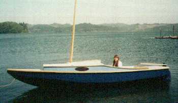

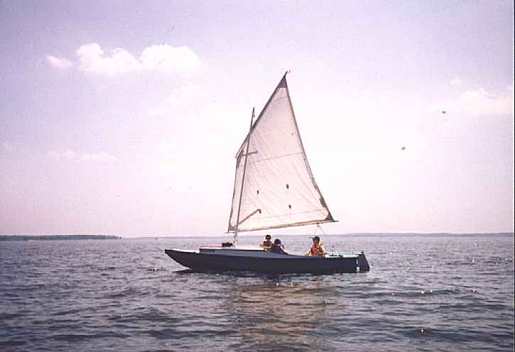

And Gary Blankenship's Frolic2 completed the Everglades 300 mile challange with him reporting sailing for hours at 7 knots or more. Last count he completed three of the challenges with a 4th overall in 2007. Here is Gary's Frolic2:

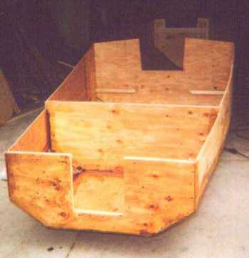

A Twister goes together in good shape. He moved the cabin bulkhead aft for more cabin, less cockpit:
