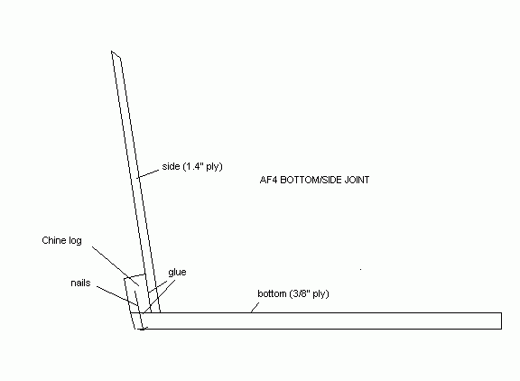

I thought about this a lot. How to remove the old bottom. It was constructed like this:

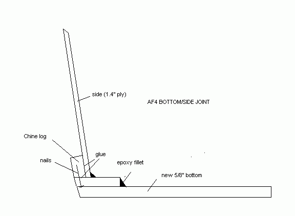

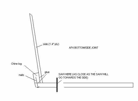

The bottom/chine joints all seemed totally intact. The first thought was to remove the old bottom where it joined the chines but that would involve destroying all the nails, etc. that I used to join it all together. Then I said to myself, "Why destroy that joint! What if I cut the bottom inboard, like this:"
A bad photo of the operation might look like this:
Then I could grind the old paint and fiberglass off the remaining bottom and have a nice flat and wide surface to attach the new bottom, like this:
That was the plan. Now to real life demolition.

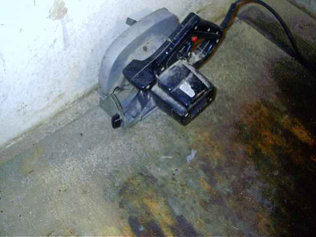

The initial sawing was quite easy to do. Done from the inside with the boat on the trailer. First I took my circular saw,with those great thin carbide tipped blades that Dave Carnell used to sell. It cared not if it hit a nail which was bound to happen. I set it as close to the side of the boat as possible and let her rip. This went very quickly but the circular saw would not get into the corners. In a few minutes the bottom was released from most of the sides and bulkheads but was still tabbed to the corners. Then I took my little saber saw and did the corners (careful to not let my body fall through as the bottom gave way at each corner). I would say in an hour I had the major sections removed. I left the little forward tip of the bow intact since the saws would not fit down in that little well. I saw no real need to remove that part.

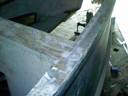

...with the hope of finding a grinding gizmo of sorts that would buzz away the paint and bottom corner armor of glass and epoxy. I was pleased to find they had a very rough disk, open 24 grit, that would fit the 5" rubber backup disk I have used for years with a drill. OH JOY! It buzzed through it all down to bare plywood, filling the shed with a dust of paint, glass and epoxy. I found one area about a foot long where the epoxy used to glue down the corner glass armor had not set completely. It clogged my disk but luckily that was on the final stretch. I suppose I had about two hours in sanding. I suppose I had maybe six hours in the whole operation at this time.
In real life it now looked like this. The curved chines still show a bit of fiberglass, the center web going across is the bottom of the cabin bulkhead:

...I hope to show the new bottom going on. Should be straight forward but I decided the repair glue with be epoxy and not Titebond as first planned. I will have to level fill those small rotted areas and also have a skim of glass and epoxy on the corners in areas. Not sure if Titebond will bond to those areas to will go with epoxy and nails (of course).

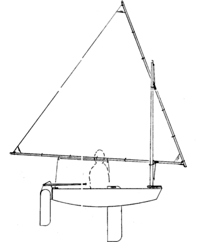

In recent years I've seen several PDR boats at our Rend Lake meets. Chuck Leinweber asked me to design one too but I guess I put it off thinking there was already a lot of variety. But enough arm twisting did the job and I ended up drawing Catbox.
The basic idea for the PDR class is pretty sound I think. The bottom of the boat is tightly controlled with variations of just 1" allowed, but I take that to be a "builder's tolerance" sort of thing and not a designer's tolerance. I took the shape shown right from the Wikipedia article on the PDRs so it must be true. Hull depth can be varied a bit. At the start I got fancy and tried to give it an elegant sheer but that never works for me. Whenever I try hard for elegant I always end up with ugly so I went back to a straight line which is I think what this class is all about.
I made it with an air box on each side. These serve many purposes. In a knockdown this boat should come up more or less empty of water because the side boxes are deep enough to float all high and dry. The inner wall of the box strengthens the bottom and that combined with the arc of the bottom should negate any need of added bottom stiffening even though the bottom is just 1/4" plywood. The wall also supports the decks which serve as seats. And if you put big deck hatches in them you can store your gear in the boxes and it should stay dry. Boxes like these need to be left open to the air anyway when not sailing to keep them from rotting. Very important.
Idid a lot of things with Catbox that I don't usually do. No external chine logs and no bottom stiffeners. I'm keeping the thing smooth as can be since this is a racing boat! I guess you could try it with external chines logs if you wish but I see no advantage here. The external sides and inner walls are all the same but don't forget you will need two righties and two lefties.
For the rig I took a Sunfish rig, at least I think I'm using the same dimensions. Catbox is a lot shorter than the Sunfish but it is also a wider so I don't think it will be overcanvased in general. The Sunfish sails are available new here and there but if I had one of these I would try polytarp first, very cheap and appropriate here and to my mind if properly done polytarp may have an edge over sailcloth in light winds.

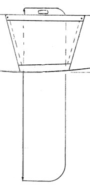

Let's see ... NO LEEBOARD! It is true. I didn't want to spoil a sleek racer with a leeboard so I gave it a daggerboard. It is attached to one of the inner walls, not in the middle and in the way. The hull/daggerboard interface should have less drag than a leeboard rig. I also arranged the board case such that the angle of the board can be changed - swept forward or aft to change sail trim. Should be a good speed trick in the right hands under the right conditions. Anyway, it will be something interesting to tinker with.
That's about it. Simple nail and glue construction needing four sheets of 1/4" plywood for all.
