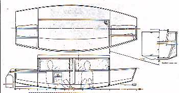

The IMB design has been around a while. It was designed for a contest put on ten years ago by International Marine Publishing. So I called it the "International Marine Beacher" which became IMB. I'm featuring the IMB below in the design section if you want to read more details but in general it was supposed to be a self righting mini (13' x 5') cruiser that could be pulled behind a small car.

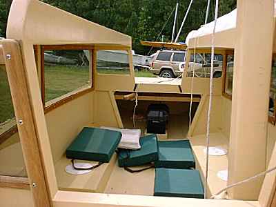

To keep the weight way down I made it a Birdwatcher boat with a cabin style invented by Phil Bolger in the mid '80's. Everyone rides inside a watertight cabin looking out through Plexiglass windows. Their weight is kept low and thus becomes the boat's ballast. That plus the high cabin sides might make the boat self righting to 90 degrees of roll, I hoped.

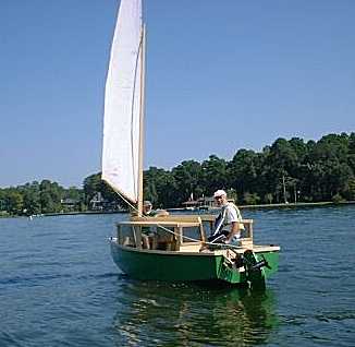

I was very fortunate to be able to attend the Lake Conroe (Houston) messabout. Among all the attractions were two IMB's! They are the only ones I know of. The first was built by Gerry Scott and the second by Bob Williams.
I got to sail in both, although the "sailing conditions" were light to say the least.

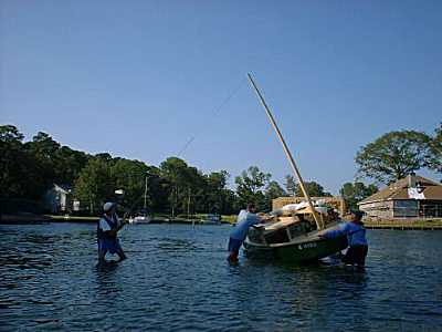

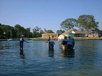

Here is what we did. The IMB was beached and we removed the trolling motor and battery and all the loose things. The boat was walked into waist deep water, parallel to the shore, and human anchors placed at bow and stern. The halyard was secured to the mast and its free end given to me close to the shore. So I could pull the boat over with the halyard while the good folks held the boat in place.
The sail was stowed to keep tangles to a minimum but the sail and boom can have an effect on the result. I would expect the boat would be slightly less stable due to the weight of the sail and boom up high. Once the boat is knocked down the boom and sail can help float the boat and keep the boat from going turtle. In fact that effect is really strong with a lug sail who's yard acts like a float out on the top of the mast. Then when it comes time to right the boat it is very very important to totally release the sheet because if water pools in the sail as you try to raise it off the water the weight of that water can make the boat much harder to right.
Remember that the skipper's weight is ballast in a boat like this. Gerry was skeptical about riding inside through the test so he watched from the outside.
I pulled it over slowly. I can't recall a point where the righting moment peaked but I would expect it to be at maybe 30 degrees or so. When the windows start to into the water the empty IMB still has a lot of righting ability (Gerry says he has sailed his with the windows touching the water). Somewhere about 80 degrees of heel the righting moment, as felt by tension in the halyard used to pull the boat over, went to zero and she wanted to go the rest of the way onto her side. I eased it down and let the mast into the water at which point the roll stopped and she was stable on her side.
Now time to right the boat. I held the halyard slack as Tim Weber attempted to push down on the skeg and see how much effort was needed to right the boat. Up she popped quickly. Tim said it was pressure of one hand that did it, maybe 15 pounds. Once it got past the 80 degree point it righted by itself and I did my best to ease it upward since these things can roll upright very quickly indeed.

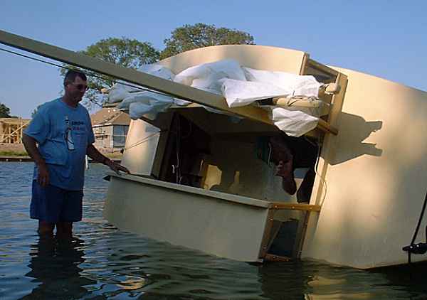

Next Gerry, great sport that he is, said we should repeat the test with himself inside to check on the human ballast effect (adding that a seat belt would be nice). So he got inside and braced himself hanging on to the mast.
Repeating the test was quick and simple although the effort to haul it over was quite a bit greater with Gerry's ballast inside. We pulled her over slowly to make sure Gerry had time to brace himself as required. You might image what being inside would be like, and I'm thinking of that old Fred Astaire film where he dances in a rotating room the final affect being that he goes from dancing on the floor then on to the walls and then for a stint at dancing upside down on the ceiling. Anyway, here is the scene close to 90 degrees with Gerry smiling and waving to the crowd, something he might not do in a real capsize.
Unlike the Scram, the smaller IMB had positive righting all the way to 90 degrees. There was tension on the halyard the entire range. When it came time right the boat no external push was needed, Gerry's weight and the boat's geometry did it all.
