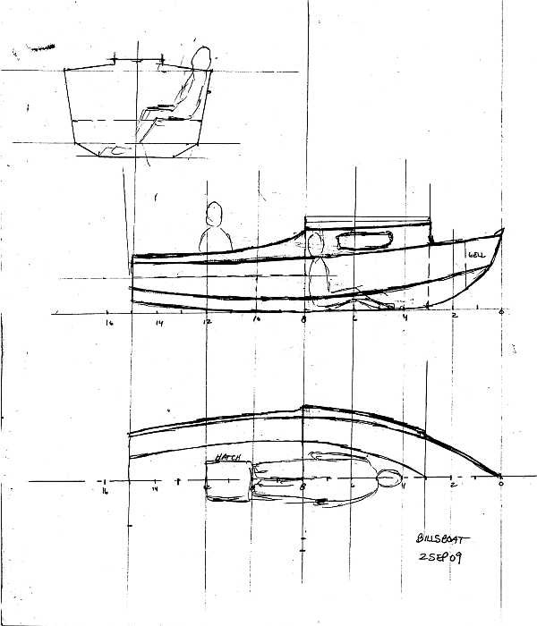

I traded a few sketches and we settled on this to start:
Note the shape and the small bottom. There is only enough floor space to sleep one, right on centerline with his pillow in the V of the bow and his feet passing through the main bulkhead and under the aft deck, Micro style. But I was careful to make the aft deck long enough for sleeping. He wanted flared sides for looks mostly I think. Flared sides make a boat harder to design and harder to build but I suppose you only do that once and then you can admire it more for a long time. In practice I think it makes a boat more comfortable and also gives it wider shoulders in a knockdown. I'm sure Bolger would say something like," If you think giving it flare to make the top wider is good, then even better yet to make it wider all the way down with plumb sides." But this one is flared.
Even at this early stage you can make a quick hack at weight and displacement. For weight I would expect something like 600 pounds of hull and rig, maybe 200 pounds of ballast, for 800 pounds on the trailer stripped. Add a motor and some gear and maybe you have an even 1000 ready to sail. Add 200 pounds for a skipper and she sails away at 1200 pounds. For a rare excursion maybe two passengers add another 400 pounds so you have a max of 1600 pounds to float.
Now the idea is to have that hull make a hole in the water (imagine a clear plastic hull pushed down into the water) such that the volume of water displaced by the hole weighs 1600 pounds. This was to be a 15' boat but it will probably have a waterline closer to 13'. then the fattest part of the hull is 5.5' wide at a point 9" above the bottom, tapering to 3' wide at the bottom. So that part of the hull has an area of .75x(5.5+3)x.5=3.2 sq ft. Now, a "prism" with that shape and length would have a volume of 3.2x13=42 cu ft. Experience has shown that a hull with ends shaped like this will have a "prismatic coefficient" of about .55, so this new boat should have a displacement volume of 42x.55=23 cu ft of water when immersed 9" deep. Water weighs about 63 pounds per cubic feet so she will displace about 23x63=1450 pounds of water and we are pretty close to our goal. Actually I do this sort of numbers juggling very early on, right at the first sketch level.

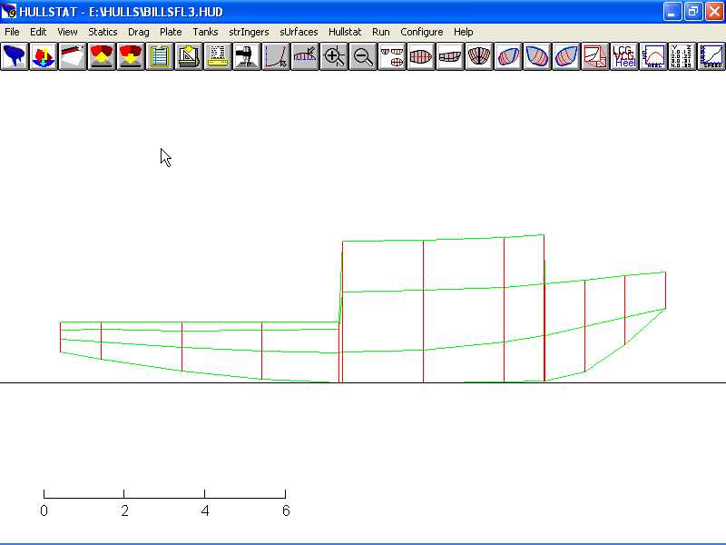

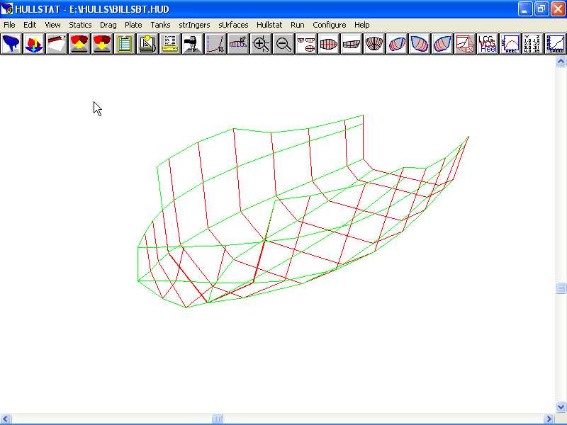

I do a "lines" drawing and I take "offsets" a regular points, enough so that I can define the shape in numbers. I use those numbers to make a model with Hullforms, a free hydrostatics program you can download with the link shown in the links section of this website. Here is the Hullform model:
Hullform is a really smart program. I have no idea how it works but it works very quickly on any computer and I've never caught it trying to tell me a lie. So it tells me that this shape will displace 700 pounds at 5.7" draft, 1000 pounds at 7", 1200 pounds at 8", and 1400 pounds at 9". So my quicky guess was only off by 50 pounds. So the single skipper scene will draw 8" and the party boat scene just over 9". In real life add about 3" to those numbers since we are going to have a center skid with some lead hanging on it.
I am reminded now about why I always gave up on projects like this. If you wanted full knockdown recovery with a crew of say three you might need another 300 pounds of ballast, or more, and the weight just gets out of hand for such a short boat.
NOW BACK TO HULLFORM...
Hullforms will do a lot more than just give you displacement and different drafts. You can flip your model on its side. If you know the weight and cg location it will tell you if your boat will right from different angles of roll. A calculation like this is very very tedious to do by hand. So much that it essentially was never done much by hand and it took the computer to help us out.
When I first started doing these it was clear that the Hullform model has to be modified to give meaningful results since the cockpit will flood long before the hull is rolled sideways and then you have a different shape displacing water. Instead of high sides aft you will have just the low raised deck to float her there. So I modify the model to look like this:
With the newer versions of Hullform you can get a curve printed out of righting moment along a range of roll angles. But you have to tell it the weight and cg information and you have to figure that yourself and it ain't always easy. At this stage what you can do is put in our guess at the weight and run the program at 90 degrees of roll using various cg locations and find the cg location that gives a zero righting moment. If we can keep the cg below that point she will self right. Doing that, the winning cg location for this hull is ...(drum roll please)...19.0" above the hull bottom.

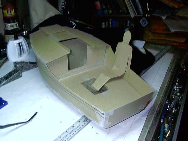

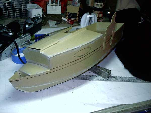

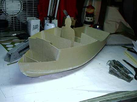

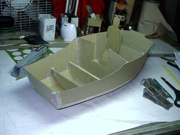

I felt that the design had jelled to the point where it would work for the right skipper and I was going to refuse any more changes. Might as well press on with more details. At this point, with the offsets well defined, (you can actually use Hullform to fine tune your offsets), I dragged out my flat panels spreadsheet that we talked about a long time ago. To review, you imagine each plywood panel in the hull to be made of small triangles. Each offset point defines the common points of joining triangles. Then the spreadsheet uses the xyz of the offsets to determine the true length of each of side of each triangle, thus the true shape of each triangle, then it hooks them all together and spreads them flat to give, you hope, the true flat shape of the original panel so you can lay it out on plywood. I've always called this the Rable Triangle method although I would think that Sam Rable, who published the idea in the 1950's (special thanks to old buddy Dave Carnell for never throwing anything away!) used the method in big shipyards long earlier than that. They probably drew the triangles full sized on steel plates. It won't work with scale hand drafting because little drafting errors throw the final shape way way off. But even my Apple 2 had no trouble doing the math in a flash, hiding the fact that it took me weeks if not months if not years to finally fall into the needed equations.
Anyway, I figured the shapes of all the panels in 1/8 scale, made card copies of the panels and taped them together. An important step because if the model don't fit then the real boat don't fit. OK, here are three pics with the decks still off. First bow shot:
Stern view (there is a "temporary form" in the middle of the cabin and the bulkheads don't have openings under the rear deck yet):

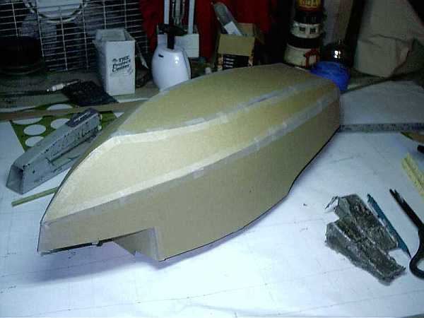

Upside down (note how the fine bow and multichines really eats into the living floor space):
And then with the decks on, from the front:
And the stern:
Sort of looks like a boat.....
