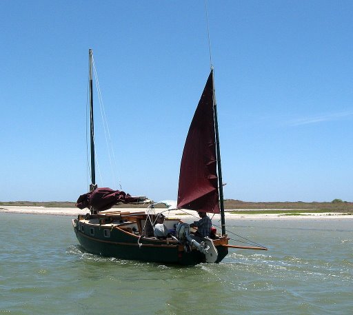

I continued to draw mizzens on the larger boats. They are much more likely to go cruising, much less daysailing, and the mizzen is almost mandatory. Here is Sandra Leinweber relaxing at the tiller of Caprice:
On a bigger boat the ability to trim the tiller force is more important. Here is Garth Battista at the helm of his Cormorant, clearly the mizzen is putting in power and the tiller load is very mild:

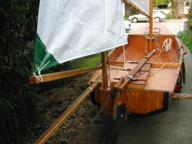

Well, it looks right now as if we could just add a small mizzen to any design where it will fit and get most of the benefits without giving up a single sail layout for quick daysailing. I have designed for Steve Chambers such a rig for his Wooboto which is pretty much a bolt on deal.

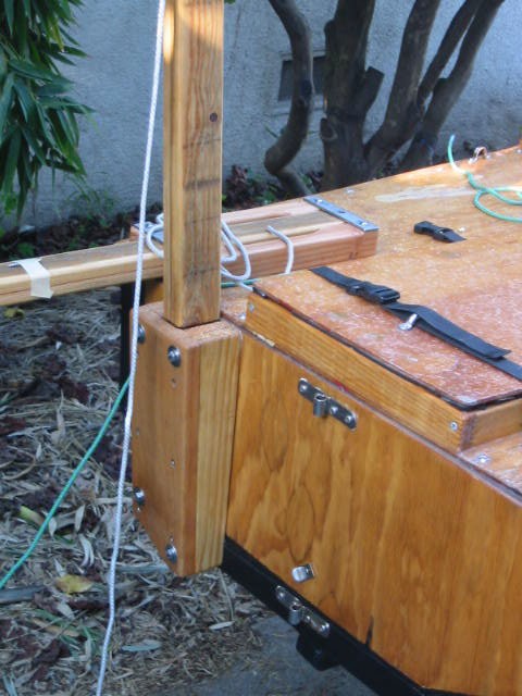

It uses a simple bolt on box mount which has a slight taper to secure the mizzen mast.
We should know if a few months how it all works out. Steve is an active boater and is probably mizzening around as we speak.
