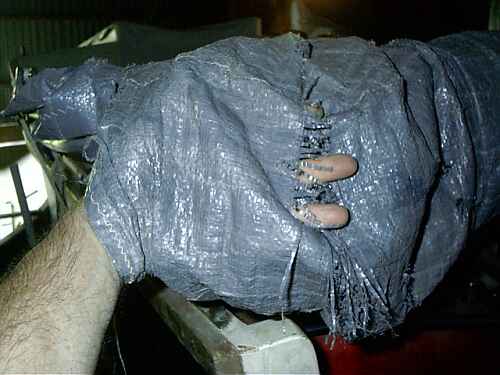

I WENT TO USE MY AF4 THIS SPRING AND....
...found my hand went clear through the bimini boot. I made this from polytarp probably 8 years ago, or more, and cheap polytarp at that. That is OK by me. Remember that this boat is stored indoors so polytarp works for a good while here. If she were an outdoors boat I don't think you could get more than a year out of a polytarp boot.
Time to replace it.

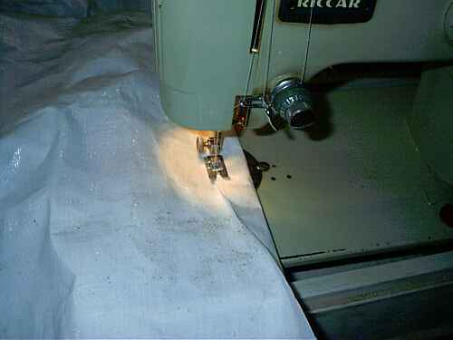

First I sewed the long side edges over with a 1-1/2" wide hem, like this:

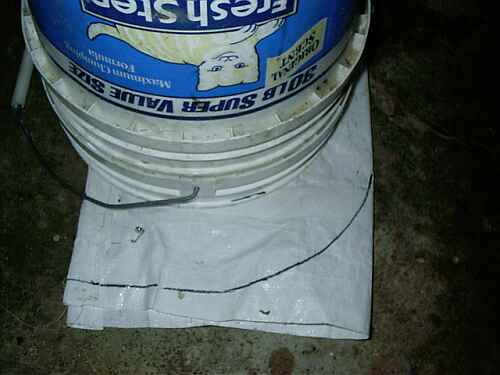

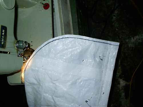

Now to sew up the ends of the "bag". I put rounded ends on mine but I have seen commercial boots that have squared off corners. If you round the ends then make sure your radius is about the same as those of your bimini frame. I marked mine with a special radius tool I keep shown here:
oar
Then I sewed along the marked lines to close the ends of the bag. And trimmed the excess like this:
You can see I know have a long shallow bag, inside out, which will be the boot.

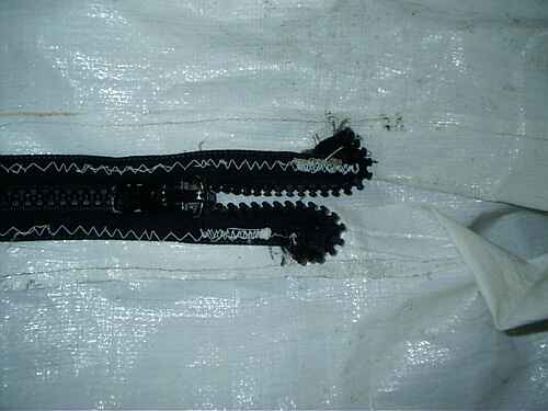

Now, zippers have two ends, one has a "starter" end where you can start the slider to join the two strips, then slide it full length to some sort of "ending" that prevents the slider from going clear off the end. On a commercial zipper that ending is usually a crimped on blocker. But if you get a zipper that is longer than you need then you will be cutting that end off. If that is the case, as it was here, then cut it a few inches longer than you need and I will show you how to easily fit a new blocker for the cut end. But the zipper needs to be long enough to close the open edge of the boot but not so long that it doesn't allow enough room for the bimini frame to pass through.
Anyway, the zipper is centered on the open edge of the boot and one edge is pinned in place. The boot is still inside out at this stage and you will be sewing it on what is now the outside (such that when you turn the boot inside out the zip is actually on the inside of the finished boot with only its slider showing). Then starting from the slider end you sew the first zipper strip to the boot.
Now, when you get to the cut end of the zipper you need to give it a quick turn and sew that down. The idea is that the zipper can't make the quick turn and thus can't come off that end of the zipper. (A trick learned from studying boat canvas that came out of Florida where I suppose the sun required regular replacement of boat canvas, thus the Florida boat canvas ladies are always busy and know every trick). The turn looks like this:

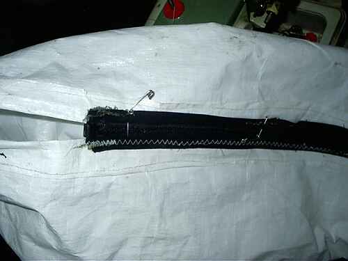

After you get the first half of the zipper sewn in place 'tis time for the second strip of the zipper. You might think you could just start the second strip to match the first and just sew it down...but that won't exactly work! If you just start it in the right place and sew it down it will come out too long!!! I don't know why but it is guarenteed!. On a 50" zipper the second edge of the zipper, if unrestrained while you sew, might end up an inch or two longer than the first! So you will need to first zip the second strip to the first (which you just sewed into position), and pin it to the boot about every 6" along its full length. Like this:
Then unzip the two strips and sew the second strip into position giving it a turn on the cut end if needed.

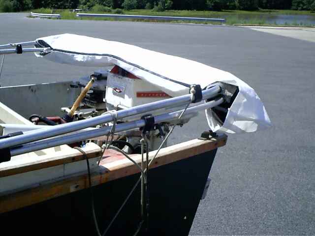

TURN IT RIGHT SIDE OUT...
... and see if it fits.
Not too bad for me. Might be a little long, thus the end openings are larger than needed but that is a lot better than too small. I could fix it quickly by sewing up new end corners maybe 1" inward from what I have now. But you know me...

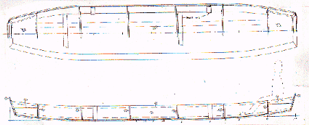

Construction in 1956 was what one could expect. You start with something you might not find at your lumberyard today - five "clean" pine boards 1" x 14" x 20' long. Three boards make the bottom with tongue and groove joints and one board makes each side, so these boats aren't too big on freeboard. I've shown wooden frames where the original boats had metal frames made from old iron wagon tires! The list of materials also included 15' of "Cow chain", whatever that is. I should add that I think a similar boat, but with pointy ends, was used in a similar way in Michigan that dragged a length of heavy chain from its stern, keeping the boat pointed reliably downstream.
Well, my Ozarkian uses standard simple plywood "instant" construction needing five sheets of 3/8" plywood. "They ain't nothin' to makin' a John boat," said Charlie the old guide. "Any hillbilly kin do it."

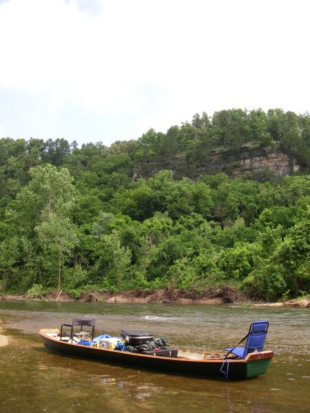

Well, Kyle Kosovich in Springfield, Mo, built the prototype. He knew the history of the boats and is using his just as the old ones were used, (which is pretty unusual). Don't even ask me about putting power on such a long light hull. You are on your own there. Remember these were never used at high speeds or in big open water. They are slow stream drifters. Here is Kyle's boat in the very waters the original boats floated:
He sent another with a modern normal boat in the background to give the Ozarkian some scale:
And here is Kyle on his first voyage:
Kyle added: "It was a dream to run the river with. We floated on the Bryant Creek and caught smallmouth, and ran limb lines with the trolling motor for catfish. The trolling motor pushed it easily. This boat is great. I repeatedly over corrected it while fishing, all it takes is a little tip of the paddle to keep it straight. It is a lot easier than a canoe to steer."
