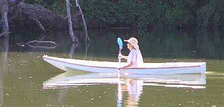

Perfect paddling conditions for Kenny Giles' Toto in Iowa.

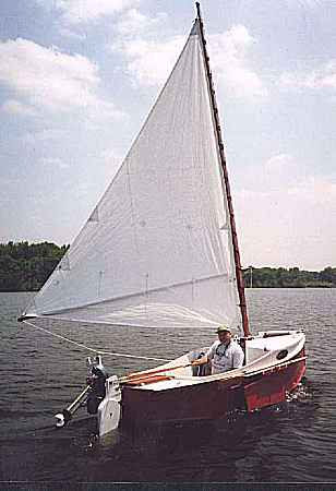

In the last issue I presented an essay about knockdown recovery demonstrated by Herb McLeod with his AF3. This year Max Wawrzyniak completed an AF3 in St. Louis not far from here. One weekend we went out for a boat camp at Calylye Lake. On that Saturday there was no significant wind and we decided to take advantage of the calm conditions by doing a practice capsize of his AF3 (shown below with a classic 2hp Neptune mounted).

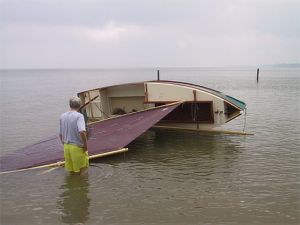

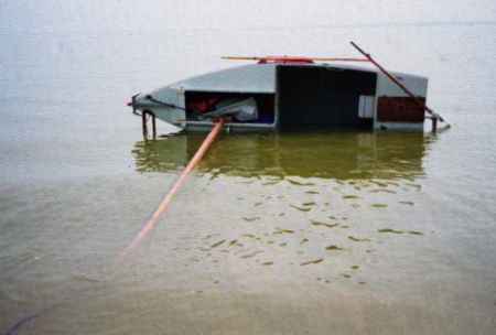

On reason I was looking forward to the test was to scope out the situation which Norm Wolf ran into with his Normsboat where the capsized boat floated nicely on its side and was easy to right but had its centerline slot pretty close to the water. Here is a photo of the situation.
Few knockdowns happen in calm conditions of course, and that open slot might look inviting to a large wave. When I made the first boat like this about ten years ago, a Bolger Jinni modified to have a small slot top cabin, I was careful to add segmented hard covers over the slot when sailing in rough conditions. I never capsized that boat and can't say how it would have done. But I feel the slot was covered sufficiently to minimize the effect of waves. I did similar designs like Pencilbox and AF2 and showed the plywood slot covers on the drawings but none of the builders built them. I'll admit that hardcovers are a pain. Eventually everyone moves towards soft covers and that is what Norm and Max use. I'm not sure how effective a fabric slot cover would be in keeping the waves out but I'm pretty sure it would be a lot better than nothing. Remember that the cover is not supposed to keep the water out for hours but just for a few minutes while the skipper swims around and rights the boat.
For any slot cover, the mast is something of a problem in that it is mounted on the side of the slot and would need to protrude through the cover if the cover were used while sailing. It was fairly easy to make a slot it my plywood slot covers. I think someone handy with a sewing machine could do the same with a soft cover but that is only speculation.

Here is what we did. The AF3 was beached and we removed the motor and all the loose things, although Max is much better at secure stowage than most of us. The boat was walked into waist deep water, parallel to the shore, and anchors run out from the bow and stern. The halyard was secured to the mast and its free end given to me close to the shore. So I could pull the boat over with the halyard while the anchors held the boat in place.
The sail was stowed to keep tangles to a minimum but the sail and boom can have an effect on the result. I would expect the boat would be slightly less stable due to the weight of the sail and boom up high. Once the boat is knocked down the boom and sail can help float the boat and keep the boat from going turtle. In fact that effect is really strong with a lug sail who's yard acts like a float out on the top of the mast. Then when it comes time to right the boat it is very very important to totally release the sheet because if water pools in the sail as you try to raise it off the water the weight of that water can make the boat much harder to right. (There can be other effects. Remember wind surfers? You never see them any more but 15 years ago they were all the rage. One day I was out sailing when a young woman fell off a windsurfer nearby. She climbed back on and raised the sail with the rope. "Did you see that!" she exclaimed. "What?" says I. "There were five fish in that sail when I pulled it up!" says she.} And don't forget that if you raise the boat upright with the sheet tight that boat might sail off without you!
Max sat in his boat in his usual sailing position while I tugged it over. He has a tilt angle indicator on his bulkhead although it maxes out at 40 degrees, I think.
I pulled it over and thought in a subjective way that the maximum righting force came at about 20 degrees which is what I expected. Almost any unballasted sharpie seems to behave like that. I continued to pull until the cockpit coaming was about to go under and flood the cockpit. Max said that was at about the limit of his gauge, 40 degrees. I was surprised that the boat still had substantial righting ability at that point unlike my old Jinni which capsized twice in tis career, both times it seems like way before any water came over the rail. But the AF3 was still hanging in there and you might be able to recover right up until then. Max had covers over his oarports which leaked slightly - a good indication that it is time to release the sheet although I can't imagine anyone seriously sailing one of these over 20 degrees of heel in a regular way.
Next I released the tension on the halyard so the boat rolled back upright. Warning! If you ever do a test like this give the skipper lots of warning because the boat rolls upright very quickly and the ride inside the boat can be rather violent!
Max checked things over and all was OK for the test to a full capsize. I tugged on the halyard and at about 45 degrees of heel the tension on the halyard was about zero. Over it came and I grabbed the mast when it approached horizontal and Max jumped out of the flooding cockpit. The righting moment continued in a negative way indicating the boat might turtle but when the mast tip hit the water it settled on its side like this:
Max righted the boat in an instant. He said there was nothing to it. Norm said there was nothing righting Normsboat and Herb said there was nothing to righting his AF3.
Once righted Max climbed back into the boat using the step hole he had cut into his rudder. It worked very well and I am going to show such a step hole in all future boats. The hole has no noticable effect on sailing.
Max bailed it out and that takes a while. There was no water in the cabin or stern locker but it was maybe 6" deep in the cockpit. In a real capsize this would be a critical time since the water in the flooded cockpit would roll around with each wave and make the boat a lot less stable. It is important to have a good bailing bucket handy and secured to the boat if you are sailing in capsize conditions.
When it was all squared away we capsized it again so I could get an idea of the effort needed to right it. Not much required. With Jinni it took my weight on the leeboard to right the boat but with AF3 I never got that far. When I waded around the stern I grabbed the chine and pushed on the bottom and up she came.

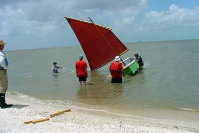

Chuck Leinweber of duckworksmagazine.com did a practice capsize at his Texas messabout this past year, took photos, and wrote up the experience:
"I wanted to add some notes to the pictures of the Ladybug capsize test:

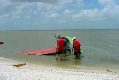

It's hard to tell, but the bottom drops off quickly here and the boat never touched. Sometimes it looks like it might be sitting on the bottom, but it was happily bobbing in the waves even when completely on it's side. It took a surprising bit of effort to pull the boat over even though it was entirely stripped of gear.
Once on it's side, the boat floated on the yardarm with the hull high in the water. That is the tiller in the air since the rudder flopped to starboard.

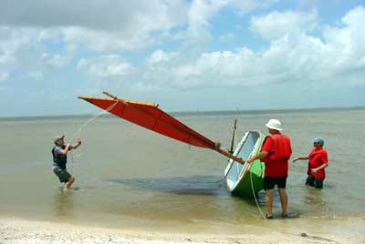

Now I start to try to bring it back up. I probably should have done it the other way so that I could have pulled the leeboard, but I guess in a real knock-down, you don't get to choose.

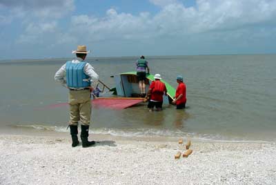

Now I'm grabbing the gunwale and am putting some weight on it. - that did not work, so I climbed on the mast - at this point the yardarm went under and may have hit the bottom. Anyway, I swung myself over the side.....
...and hanging onto the gunnel, easily tipped the boat back upright.

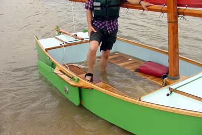

I tried to simulate getting back in the boat in deep water by bending my knees and pulling myself in with my arms only. This was surprisingly easy.
There was a bit of water in the cockpit, but that was easily bailed. I think the boat would have sailed that way unless it was very brisk.
Skip Johnson helped me bail the boat out. The hatches were built a little oversized to accommodate an ice chest (yes, we are spoiled) but only leaked a few tablespoons of water into the flotation chambers. Now we pack our gear in dry bags when we go cruising."

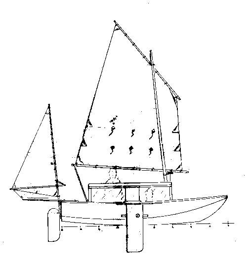

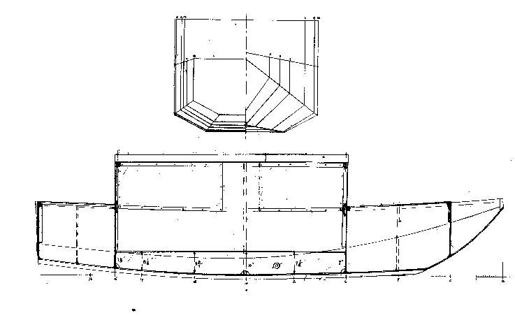

CAROLINE, SAILBOAT, 18' X 6', 750 POUNDS EMPTY

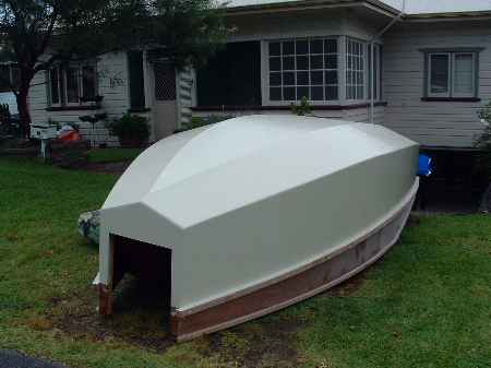

Caroline started as a blend of Philsboat and Frolic2. The idea was for a little more cabin room than Philsboat and hopefully with the same seakeeping ability that Frolic2 has demonstrated. I made it a little deeper and wider and with a longer cabin than Philsboat. It all added up to about 30% more cabin volume. But it is also more boat to build and pay for and haul so the other boats, which are lighter and cheaper, still haven’t been made obsolete as far as I am concerned.
One interesting side to this sort of house design is that if you add a motor well, as this one has, the stern gets pretty busy since the only way you can run a normal tiller to the rudder is under the aft deck. To get a good swing of the rudder that aft deck needs to be short and wide if that motor is to live there too. I think I have it all crammed in there such that it might work but even so the rudder is well offset to one side, as it was successfully done with Philsboat.
The builder wanted a yawl rig (she wants to coastal cruise the Maine coast) but I added the mizzen as I do now, keeping the basic balance such that you could sail it without the mizzen.

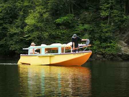

I'm still carrying Caroline as a prototype even though she was completed and cruised in the summer of 2008. Problem was that the mizzen wasn't ready in time for the cruise so they went to sea without. She sailed fine but I underestimated the anchor situation in Maine where the tides won't let you beach a heavy boat. Any boat like this will swing at anchor in a wind and so did Caroline. The mizzen is supposed to stop that so hopefully we shall see in the 2009 cruise if she works AOK with the mizzen. But here are some photos of the first launch/cruise:

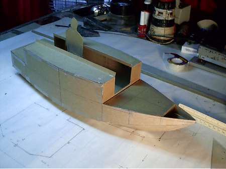

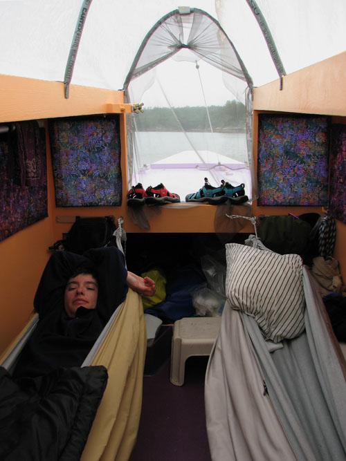

You can see that these Birdwatcher cabins are simple and roomy.
Looks like six sheets of ¼", ten sheets of 3/8" and three sheets of ½". Taped seam construction.
