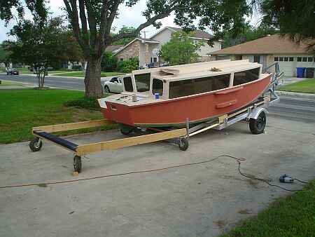

Mike Morris's shop gives birth to a new full sized Jewelbox. Texas, of course, note cowboy hat on cabin deck.

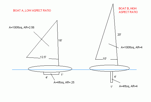

Actually they are twice gliders. Their sails glide through the wind and their keels glide through the water. Both the wing and the keel (or underwater board of any sort that counteracts the side force of the sail) are subject to the downwash. So each lives in its own downwash and in both cases the downwash is going to subtract from the boat's ability to point to windward. Let's look at this with two simple example boats:
Now imagine these two are sailing together in the same wind, close hauled to sail as close to the wind as possible. Both sail and keel are brought to just below the stalling point while they do so. The skipper will note that if he tries to point any closer to the wind with his sail that it starts to "luff", that is the leading edges start to flutter and his sail power is reduced. At the same time he might watch his wake and note that his keel has not stalled and he is not making too much leeway. Both boats are the same except that the sail and keel aspect ratios are different.
Now imagine you are on one of the boats and the wind shifts slightly to the bow causing the sail to luff. The skipper must bear off a bit to compensate and keep the sail drawing fully. Now imagine instead that this "wind shift" is actually the sail's own downwash. So you see that the sail's own downwash directly decreases the boat's abiltity to point into the wind.
Now let's hang some numbers on these two boats. The aero gurus say the shift of the wind due to downwash, in degrees, is a=18 x Cl / AR where Cl is the "lift coefficient" and AR is the aspect ratio. (Actually they have lots of correction factors for this equation given different wing shapes.) A thin cambered airfoil like a sail will have a maximum Cl of about 1.5 and I'll use that for this case of sailing close hauled. So it works out that the low aspect ratio sail will have an "induced angle" of 12 degrees while the high aspect sail will have an induced angle of about 7 degrees. All other things equal the high aspect ratio sail should point about 5 degrees closer to the wind simply because it has less downwash.

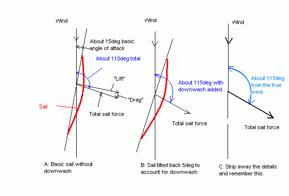

Before I close out this topic I want to present this graphic in summary:
So first we have the basic sail close hauled at about 15 degrees from the wind (I'm guessing at all of these angles). It produces on the sail a total force which can be shown as the vector sum of lift (perpendicular to the airfoil), and drag (parallel to the airfoil). I'm guessing again but if the sail's general Lift/Drag is 10 then the total force will tilt back about 5 degrees from the basic angle of attack. So the total vector slats back at 110 degrees from the wind direction. Next we add a bit of downwash effect where the skipper needs to tilt the sail another 5 degrees (for example but the earlier study shows it is a bit larger) so the sails main vector tilts back 115 degrees from the wind. Finally let's simplify the picture by just looking at the resulting sail force. This is what is moving your boat when close hauled. Think of it as a rope pulling on the mast sort of like what tow path mules used to do as they pulled a canal boat down a canal.

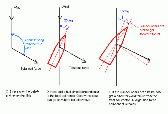

Anyway, the keel has a very important job to do. Look at this graphic:
First view is just the basic sail force as before. Next we add a boat hull perpendicular to that force shown at 25deg to the wind by all my angle guesswork. So, you think, the boat can't possibly sail closer to the wind than that since now all the force is to the side. So the skipper tilts his boat slightly downwind, say another 10 degree guess, to get part of that total sail force to push him forward. The major portion of the sail force is still pushing him sideways but we'll worry about that later. At least we are moving somewhat forward. Now he is 35 degrees to the wind and I'm thinking that is about as close as any reasonable sailboat might point into the wind.
So the really important job here for the keel is to counteract all that side force.

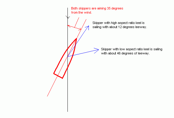

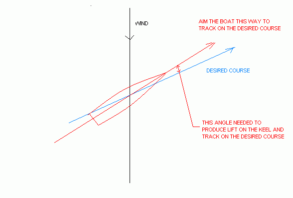

The keel develops its sideforce, needed to counteract the side force of the sail when close hauled, by flying through the water at an angle just like the sail. If the skipper wants his boat to follow a heading of say 035 and his wind is from 000, he might have to point his boat say 045 to get ten degrees of angle of attack on the keel to get the side trust needed to deal with the sail forces. Like this:
So the skipper always has to aim his hull to windward of his desired course and he might think of that as leeway. Another way to look at it is in the above example he is trying to point 35 degrees from the wind and he aims it that way, but the boat's track will be 10 degrees downwind of that because of the leeway. So he is tracking 45 degrees to the wind close hauled. Mind you his hull is pointing 35 degrees to the wind but it isn't going where it is pointing due to mandatory leeway.

...the keel also lives in a fluid and is subject to downwash! So the leeway is worse than just the basic "angle of attack", just like with the sail.
There is another difference with the keel in that there will be no spillage of the water around the top where it meets the hull (assuming no gap there or with a leeboard the water can't flow over the top of the leeboard). So in effect it is half a wing as far as downwash is concerned and the aero guys say this effect doubles its aspect ratio as far as figures are concerned. So in the example above the low rig has an effective keel aspect ratio of .5 and the high rig an effective keel aspect ratio of 8.
Let's run the induced angle numbers for the lwo examples using a Cl=1.0. For the high aspect ratio rig it calculates to be just 2 degrees. (I wouldn't notice that myself.) And for the low aspect rig it figures out to be a whopping 36 degrees! It sounds extreme and I don't know if I really believe it but I can say for sure that if you raise the leeboard on a close hauled boat you will find you aren't moving to windward anymore. I know some boats have things like keel runners and such. I've never tried them and can only say they aren't very effective by these theories. Full keeled boats of low aspect ratio have been around a long time, a lot longer than deep finned boats. They can work because they can have a huge side area, thus operate at low values of Cl all the time.
So add it all up. The high aspect keel will have maybe 12 degrees of leeway when close hauled. The low aspect keel will have maybe 46 degrees! Like this:
