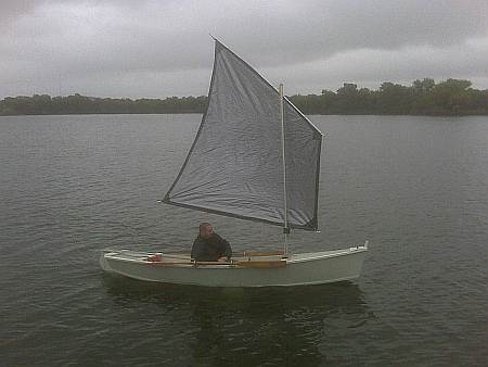

Cary Berger in Texas built this nice QT rowing skiff, did his sail area math, and designed this nice sail rig. 67 square feet all set on 10 foot spars. Also note his perfect hull trim gained by sitting well forward. Nice job!

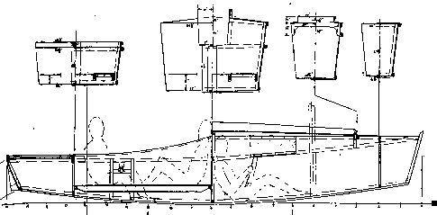

AF2 is a rather typical sharpie, 20' long and 5' wide on the bottom with a single gaff sail. The cuddy cabin is roomy enough for a solo bed room and it has a slot top that could be left open for sailing on nicer days.
One of my design guesses was that it would have an empty weight of 600 pounds and I'll tell you how I stab at that. AF2 requires, no guesses here, six sheets of 1/4" plywood, seven sheets of 3/8" ply, and one sheet of 1/2" ply by the blueprint. The usual plywood weighs about 25 pounds for a 1/4" sheet, about 38 pounds for a 3/8" sheet, and about 50 pounds for a 1/2" sheet. The resulting pile of plywood should weigh about 470 pounds and I have found that to be a good guess at the weight of such a hull bare with no extras. Add maybe 50 pounds for the sail rig. Then round up and there I am at 600 pounds.

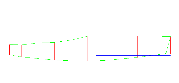

Now that is a minimum weight boat in the water. Add a skipper and some of his junk and let's say the boat is sailing at 1000 pounds most of the time. Using our old friend Hullform we would expect a waterline like this:
It looks quite good to me and I have been taught to look at it with Phil Bolger's eyes. He said sharpies need to sail over the water and not through it. The bow is swept well above the water to meet the waves with the bottom and not pushing through them with the sides. The stern is also well out. She would have a short waterline bolt upright as in light winds, minimum wetted surface area so they say. But a sailing breeze would heel her over to get a longer waterline when there is power in the wind. And heeled she would meet the waves with the edge of her chine like a V bottomed boat. It all works great provided the conditions are right. The best case is a strong wind with smooth water. The worst case is rough water and little wind. So sharpies have split personalitites much more so than V bottomed or round bottomed boats.
I might add that the short upright waterline helps a lot for quick maneuvering.

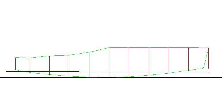

Now let's add a couple of big passengers and we are up to 1500 pounds and she looks like this:
Still looks OK but I might suggest this would be the limit for brisk sailing.

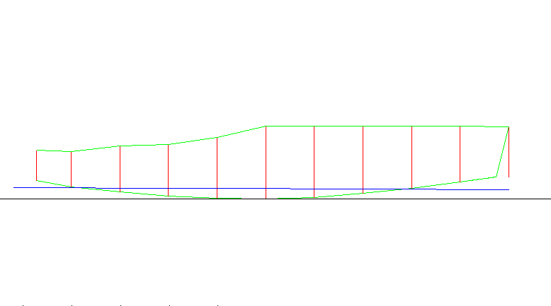

Now let's add a couple more passengers, a full house but AF2's benches have room for four adults. Then we have this at 2000 pounds total:
The transom is pretty much in the water and will drag when the boat is heeled. The bow is ready to plow through the water. I'd say this is a maximum but most likely it would be a once a year sort of outing, not serious sailing.

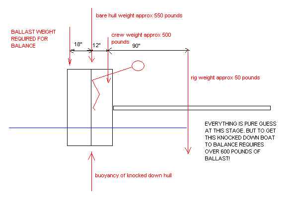

Let's say you are going to use AF2 as the basis for a small cruiser ballasted to be self righting. I tried this a number of years ago. The ballast will be something like metal inside on the bottom although it might be water ballast too as low down as possible but still inside the hull. But just adding ballast is seldom enough. The top of the boat must be make watertight like a bottle with a sealed raised deck aft that would resist swamping in a knockdown and shed any water like a duck. The trouble is raising the deck also raises the crew and they are a major portion of the weight.
OK, next step is to figure the ballast needed to make it self righting and if you want to start a big argument just try to define "self righting". To me with a boat to be sailed close to shore where huge waves won't lurk and where rescue is possible I think it might mean it would return upright from a 90 degree tilt. To Howard Chapelle self righting for a sharpie was to return from just a 45 degree tilt. To an ocean sailor, who could get rolled by a big wave, it can mean righting from way past horizontal, say to 140 degrees. I don't know if any boat with inside ballast could do that.
Here is the picture I draw for a first cut at a problem like this:
What we have here is a front view of the boat knocked over 90 degrees with the weight of three adults on the raised cockpit deck. I've taken the weight of the hull to be 550 pounds distributed evenly thoughout, and the weight of the rig at 50 pounds. The main effort of the buoyancy of the tilted hull is taken to be halfway up the side. Now solve for the ballast weight needed to put it all in balance. If you take the torque about the point of buoyancy you see the torque twising down to the right is the passengers (= 12x500=6000 inch pounds) plus the sailrig (= 102x50=5100 inch pounds) for a total of 11,000 inch pounds. Counteracting that is a torque in the other direction provided by the ballast at 18" so the ballast must weigh 11000/18=611 pounds for this crude first look. I am not surprised at all. All of Bolger's small sharpies seem to have 500 pounds of it.
Here I've assumed the weight of the bare hull is right above the point of buoyancy and I think that is pretty safe to start with. So the hull weight hardly figures into it. The real killers are the crew and sailrig weights and distributions. You can see how outside ballast placed way down on a keel has a real advantage. And you can see that the crew weight, if placed on the bottom as with a Birdwatcher type hull suddenly becomes its own ballast to help the hull right instead of trying to pull the hull over.
And you can note that buoyancy down low in the boat, as say beneath that raised aft deck, actually tries to turn her turtle. But whatareyougonnado? You need to seal that area so the boat doesn't swamp and become helpless at far less heel than 90 degrees (water usually comes over the side at about 45 degrees of heel, I think). And you can note that the higher the cabin is to the rest of the boat as in a raised deck cabin, the more buoyancy you will have up high provided that cabin does indeed go into the water (with its windows closed) and is not a trunk cabin with a low walkway around it.
But the upshot of it all is that we would start with an empty weight of about 1200 pounds and then we go from there. When I tried this on a design more along than this one I actually had to give up on it since I saw I needed to redraw everything to give more hull rocker.

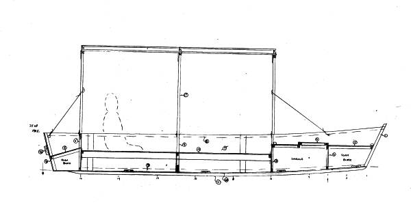

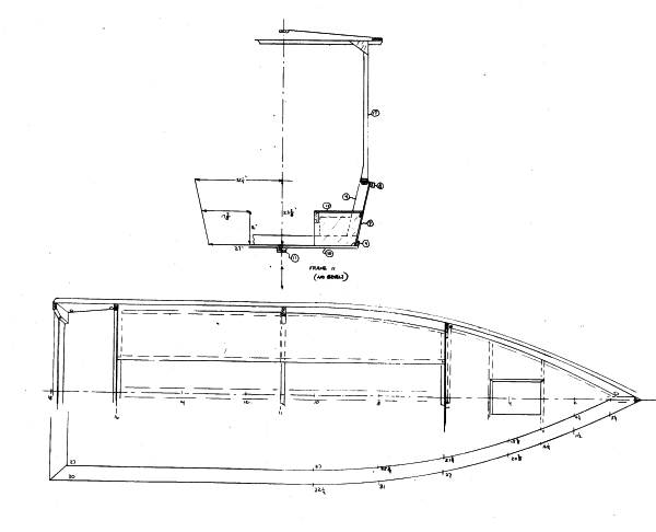

POWERBOAT, 18' X 6', 350 POUNDS EMPTY
This was supposed to be a cut down AF4, without cabin, but with a large open cockpit for sightseeing, and maybe a canopy over all of those seats. Chuck Leinweber called it a "picnic boat" which is a pretty good idea.
It is the same overall size as AF4, should be about the same weight. In general the bow has a 6' long recessed deck, storage under if you want, followed by a 10' long cockpit with bench seating on both sides, followed by a 2' long motor well segment just like AF4's.
But I did simplify the construction a bit from the original AF4. I made the sides a constant 2' width so you make them by ripping plywood panels straight down the middle with no curves to the edges. Then when you bend them around the bulkheads the bow will pop upward in a nice swoop. The stern aft of 10' is constant width and depth, unlike the original AF4 that had its sides pinched inward a bit strictly for looks. But I like the looks of this new one too.
This sort of shape has some advantages beyond the simple setup. Because the hull is constant aft of the middle a fellow could lengthen, shorten very easily. You can't make it wider or narrower easily. In addition, the bench seats are I think pretty much nonstructural. You could omit them leaving the center open except for the center frame. Sit on a folding chair like I do with my AF4. Unfortunately I do think the center frame is needed to keep flexing of the bottom under control. But there are other ways around that, for example using a deeper center shoe. The bottom, as shown, is a copy of what I use on my AF4 now with satisfaction. 1/2" plywood with a 2x4 center shoe full length. Max Wawrzyniak showed me the way on this after my first AF4 bottom proved flexible beyond enjoyment. It is a very simple build indeed.
I can picture fishermen making this one stripped down but maybe with the bow deck left to stand on.
The canopy is somewhat bothersome but it is very important if you are to spend all day on the water. A fellow might do just as well to buy a premade job from someone like Taylor Made. Here are the problems I see with a homemade top. For one is weight. The boat can certainly float the weight but weight up high can be dangerous, so I would suggest a polytarp lashed to a simple wooden frame. Best would be a simple frame of aluminum tubing but most of us can't weld it and if you start buying factory fittings and tubing you might find the Taylo Made solution is actually cheaper. OK, next problem is probably that you will want to fold it down for towing and probably will have to fold it down to get it into a garage. I designed this one to fold aft but on second thought reversing the hinges so it can fold forward might be better and hope it will stow nicely on the bow deck. Anyway, the boat will be fine without the top so you could start it out that way and ponder a top solution as you wait for the fish to bite.
Let's say 25 hp max. (AF4 likes 15 to 20 hp.)
Construction is simple nail and glue requiring three sheets of 1/4" plywood, two sheets of 3/8" plywood, and four sheets of 1/2" plywood.
