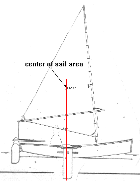

I have to rerun this essay every year. This subject is the most common area where tinkerers of designs get in trouble. It always has been and always will be. Anytime you modify the sail rig you need to keep this math in mind.
sail balance
helm

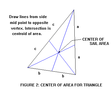

THREE SIDED SAILS...
3 sided sail
triangle centroid

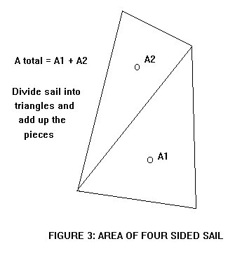

FOUR SIDED SAILS...
area of four sider
centroid of four sider

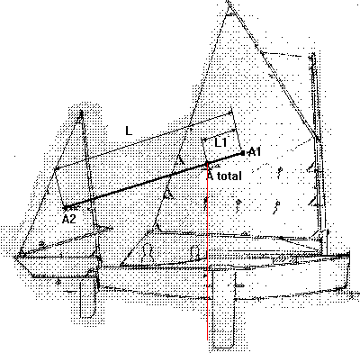

RIGS WITH MANY SAILS...
multi sail rigs

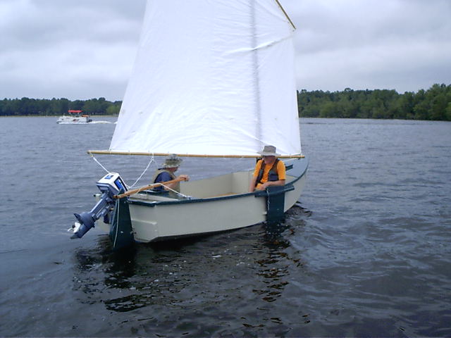

... and his own polytarp sail. He brought it to the Rend Lake Messabout:
We agreed there that I should have drawn the mast taller but she was otherwise right on. We had no strong wind that weekend so we don't know yet how she would handle that but this shape hull is about the best I can draw for rough water. She is big and roomy inside...
An ideal family boat in a way. The offset motor/rudder all seemed to work well. We were all happy with the outcome.
