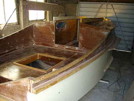

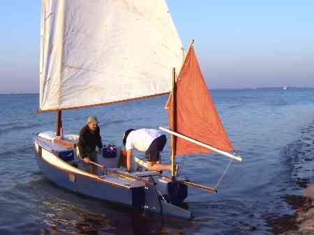

Sean Moffitt, of the Georgia Moffitts, launches this Piccup Squared he built by himself.

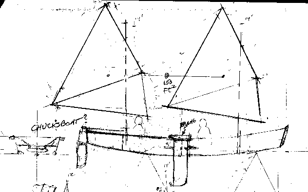

If you're gonna lengthen it, might as well add 8' or so, the length of a plywood panel. I was asked to keep the bottom narrow enough to plank over with a single width of plywood, 4', like Mayfly16. The sail rig was also to be kept simple and need not be large given the usual strength of the wind there. My second or third doodle looked like this:
The two sails and masts are the same as my Ladybug rig, something CL already has on hand, at least one of them anyway. Then there is a plan to have the ability to mount a solo mast in the boat's center.
So in general we have a long skinny flat bottomed sailing skiff of the simplest sort of construction. There are two cockpits so the sailors can sulk and mope apart from one another on the long trip, no need for mutiny or worse. The cockpits are each 6.5' long so sleeping on the floor is possible. There are storage/buoyancy chambers fore and aft. They should help a lot in a knockdown but a boat with 13' of open cockpit can swallow a huge amount of water in a knockdown. One thing that might help a lot in such a situation is to tie large air filled fenders outside of the top wale to give the narrow boat broader shoulders to lift it when it goes sideways.

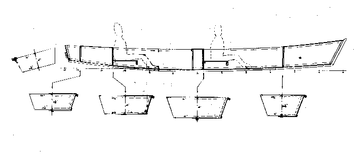

At first I gave it long bench seats like Mayfly16's but on second thought I changed to individual seats that cross the backs of the cockpits. On a trip this long you must be comfortable. These should be quickly removable to allow clearing for the sleeping spot. The bench seats simply can't allow a center aisle wide enough for sleeping. I might add that if the boat were used on occasion to take out a very numerous crew, say a family reunion, then I would suggest leaving the seats on shore and have all sit on the floor. Then again, if you are never to sleep in the boat you might install the bench seats, which can be somewhat complicated but usually provide the best comfort. Anyway, the side view cross section ended up looking like this:

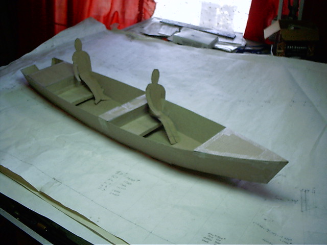

I drew up the expanded panels and made a card model that looked like this:

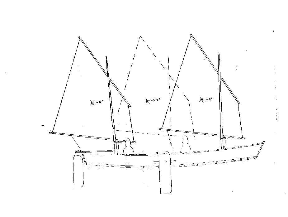

It stern has my usual open well with a place for a small motor. I drew up the sail rig in more detail and got this:
No real change here from the original cartoon but I've shown the single mast setup in dashed lines. The tiller of such a boat always bothered me. The masts are on centerline. The tiller has to end short of the mast of course to allow it to swing. So the skipper has to hand it back and forth to himself sometimes on tacks. I think what I show is the best approach, or at least the simplest. Any other rig would require some linkage or perhaps a large oddball tiller. This should work OK given the long stretches with no tacks required in the race.

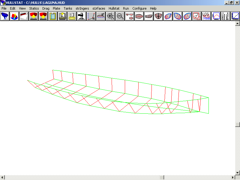

About this time, with the design pretty much set, I made up a Hullform model which looked like this:
The program doesn't seem to allow slanted stems and transoms so it isn't exactly per the drawing. These are very good at scoping out displacement, although with such a simple design you can do OK with a quick hand calc. For example here, if the boat were loaded down to where its stem hits the water, what I would call the maximum displacement (although the boat could clearly take a lot more weight with ugly flow lines), then the waterline length would be about 21'. The maximum submerged cross section would be about 7" x 48" in area (draft times beam) which is 336 sq in which is 2.33 sq ft. So a "prizm" 21' x 2.33' would have a volume of 49 cubic feet. Boats like this almost always have a "prizmatic coefficient" of about .55, so I would expect the real boat to have a displaced volume, at 7" draft" of .55 x 49 which equals 27 cu ft of water. Water weighs about 63 pounds per cubic foot so that displacement amounts to 1700 pounds of displacement. The Hullform model predicts 2000 pounds displacement at 7" draft so perhaps the difference is partly because the side flare gives a bit more displacement and perhaps the hull is fuller in the ends than the norm. I think the higher coefficient is good in smooth water.

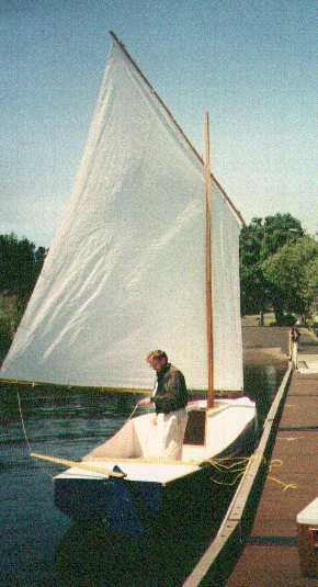

And Gary Blankenship's Frolic2 completed the Everglades 300 mile challange with him reporting sailing for hours at 7 knots or more. Last count he completed three of the challenges with a 4th overall in 2007. Here is Gary's Frolic2:
