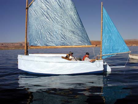

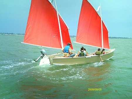

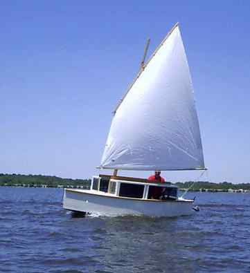

The prototype Laguna blasts along on plane with a family of five on board. Built by Gordo Barcom in Texas in three months of spare time.

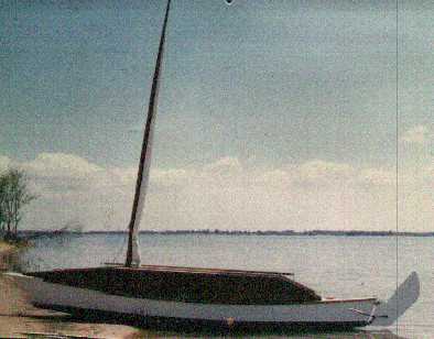

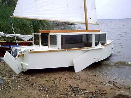

A long time ago, in 1989, I built and launched my Bolger Birdwatcher. It was the second Birdwatcher ever built and I probably would not have built it if not for the words of the first builder (Ron Mueller ?) who told me the idea really worked. I had seen Phil's first drawings of it a few years earlier and in 1986 Phil wrote up an essay about the idea in the old Small Boat Journal. Phil later told me the Birdwatcher cabin was most likely the only real original thing he had thought up and I've got to tell you that in the 1800's I think anything you might imagine was tried. Later I decided that it took the invention of high strength clear plastic like Plexiglass to make the Birdwatcher idea work. Anyway, here is my old Birdwater a long time ago:
Not a great photo to be sure. I still have my Birdwatcher and see no need to replace it since it is still in fine condition, stored indoors.

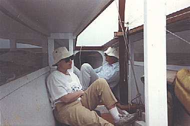

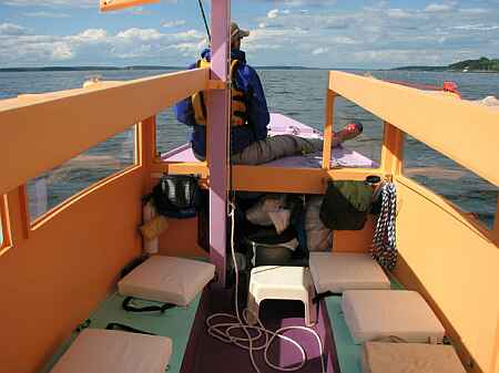

...is that the crew rides inside sitting low as in an open skiff. Thus the crew weight, which is often the heaviest part of a small boat, is always down low. Next, they ride inside a waterproof Plexiglass "room", more or less just like you ride inside your car in its glassed in room. This is the cabin. Essentially all of the volume of the boat becomes the cabin. You steer from inside and handle the sails from inside. Here is an old photo of Bob and Sue Archibald riding up front in the cabin of my Birdwatcher:
Now, unlike your car the BW cabin was designed with a slot down the center, from stem to stern, wide enough to move about in. So you can stand up on the centerline and walk the length of the boat. At least in good weather. In bad weather the slot is closed with a fabric slot. You can sail in the rain without getting wet. In good weather with mild winds the skipper can sit up on the little aft deck and steer with his feet. Boy, I quickly learned there were many unusual combinations made available. If you lash the tiller BW would sometimes self steer very nicely. Then you walk to the forward end of the slot and watch the waves slide past the bow. And I learned that if you left the slot cover off while trailering you can look in your rear view mirror and see all the traffic behind you, through the open slot. With any other boat this size all you see in your rear view mirror is a big boat chasing you.
I never found the BW cabin to be uncomfortable. I think the dark tinted windows are a must but others seem to feel differently. Actually on a hot day you can always sit in the shade, and the sail usually provides a downdraft that flows through the cabin.

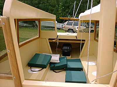

...for the size of your boat, of course, since the whole hull is your cabin. In BW, and in most of the BW cabins I designed, you can sit at the tiller and see from stem to stern and all the volume is available to you. Here is a photo of the interior of Gerry Scott's IMB, a BW design I did that is only 13' long:
We had five adults in this boat at one time. The cabin is 8' long and meant to sleep one on the floor centerline but clearly it would sleep two good friends if they had a way to fill in the place between the seats to provide a flat that is 5' wide. There is no way you could get such a large and airy cabin in anything this size except in a BW type hull. My 19' Jewelbox has room to sleep four adults in its cabin. (The original BW would sleep three, one spot missing because of the use of a centerboard (which is off center)).

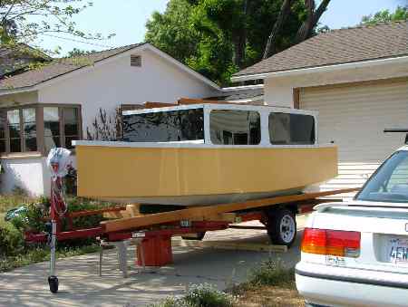

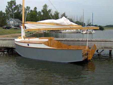

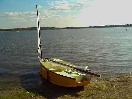

And a lot less draft. My BW, over 24' long and about 700 pounds empty, draws less that 3" of water with the board up! As you see in the first photo of it, a quick pull on the snout will get it a third of its length out of the water. Launching is simple to say the least. I like to show this photo of Chris Feller's great Philsboat pulled over half way out of the water stern first. Try that with your ballasted fin keeler!
Philsboat is only 15' long but it will hold three or four adults like IMB. You can see how I tinkered with the original BW design as I went along. In general I tried to change the things that bothered me about the original BW. So mine are smaller (my BW is 30' long from trailer tongue to rudder tip), with simple squared off cabins (my BW has some double bevel fitting in those fancy sloped cabin ends), and simple square off sterns (got away from the welded rudder linkage required by the pointy stern and Phil had no intention of ever putting a motor on BW and thought we were all rat race wimps for wanting one). And I went back to that other great Bolger reinvention, the leeboard.

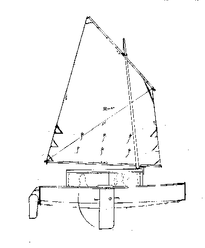

Philsboat
Plans for Philsboat are $45.
