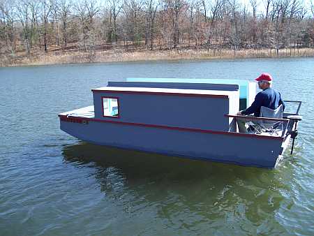

Gene Berry takes his new Shanteuse out for a spin on a Missouri lake.

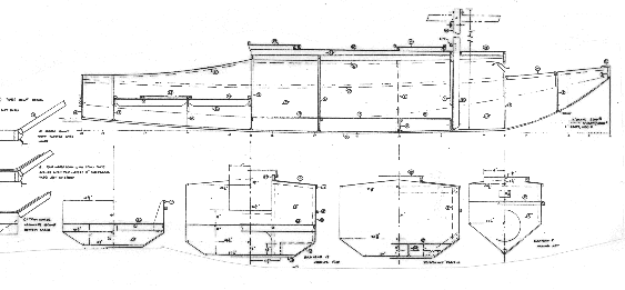

The design progressed to where I had drawn the panel expansions and made a card model:

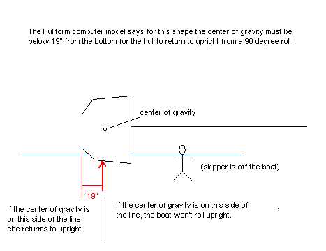

And made a Hullform model to get a good hack at where the center of gravity (cg) had to be for the boat to self right from 90 degrees.
BALANCE POINT...
The Hullform model said the boat will self right from 90 degrees of roll if the cg is at 19.0", or below, measured from the bottom of the hull. So imagine the hull balanced on an edge like this:
Now it becomes a question of doing a weight and balance estimate for the design and find a ballast weight and location that will give us the cg at 19" from the bottom.

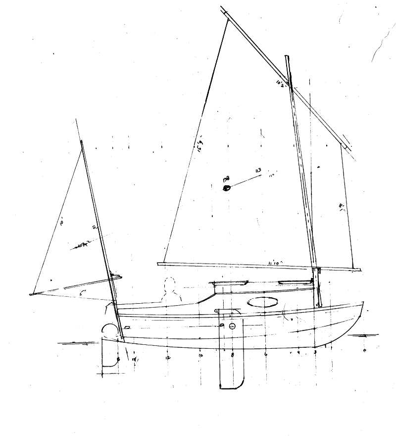

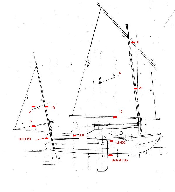

To progress you need to have a drawing of the boat with a sail rig up and really an estimate of everything that will be in the boat. At this time I had a sail rig which used the same sails the skipper had for his present boat:
Now to paste in the weight guesses. Like this:
There can be a lot of gosh and golly hand waving, on top of pure ignorance, in a job like this. The sail rig isn't too bad in that you can take the yard, for example, say it is 2" round and 11' long and that makes it 414 cubic inches in volume. Typical wood might weigh .017 pounds per cubic inch (say 25 or 30 pounds for a cubic foot with a lot of variation) so you guess the yard will go about .414x.017=7 pounds or so. I've guessed 10 here being rational and conservative in engineering nature anyway and note that there are some ropes and pullies up there too and that I like round numbers. But you see how it is pieced together a step at a time. When I first worked at the missile factory I wondered how the weights engineers did their work and the answer is slowly and meticulously....calculating shapes and volumes and keeping ponderous track of rivets and rivet holes. But they did something I am copying here in estimations in the first stages. As Harry once said, "We always know how much it weighs. We just don't know where the weight is. Yet!".
An example of that is in the gross hull estimate of 500 pounds. Well, it will be more than 300 and less than 800 if it goes by the plans. But as the design progresses we can refine that weight and its location on the cg diagram and refine our ballast estimates with it. At this stage it is a guess.

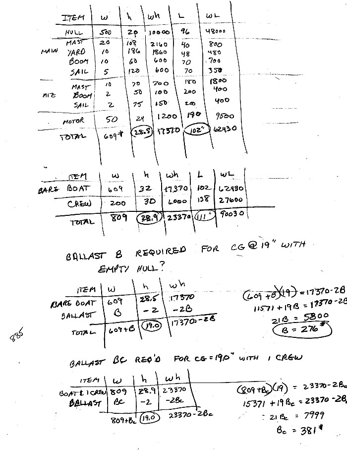

...using the above scale model we measure upward from the bottom, which is here our baseline and datum line, and make a chart of it all with all the elements, with weight and height above the baseline, and find the cg location which might be thought of as the "average" location of all the weights together. Here is my chart:
There you have it. The "h" is the distance from the datum to the item. I've also figured the "L" which would be the distance from the bow tip to the item so I can get the horizontal location of the cg also and maybe can trim the boat level by also getting the ballast located best fore and aft. Anyway, the bare boat (with a 50# motor) looks here to weigh 609 pounds and the cg is 28.9' above the datum, well above the 19" desire. You can look at the chart and see that the hull itself and the main mast are the main contributers to the high up cg. No surprise there.
I've also shown in a separate calculation the cg location with a 200 pound skipper on the aft deck. Turns out I've placed him pretty much on the average for the boat so the vertical cg hasn't moved much but his weight aft moved the logitudinal cg aft.
NOW THAT NASTY BALLAST...
The plan is to bolt the ballast in lead bars to the bottom of the hull so that its average location will be at -2". The bottom of the calculation page shows the algebra. To get the cg down to 19" takes 276 pounds of ballast at -2".
Now before we fly off the handle about how I thought it would be less, I say it still will, in the end, be less than 276 pounds of lead. Here is why. As the structure is better defined the hull weight, given at first guess as 500 pounds 20" up, will be broken down into smaller pieces more accurately located. In particular this boat is to have a very thick plywood bottom, at least an inch thick. So I expect maybe we will have a hundred pounds of plywood there which will come right off the lead weight. I hope.
Even without that idea we are still in business I think. Total boat weight ready to go will be about 900 pounds on the trailer. And with the skipper and his lunch we might be 1200 pounds sitting in the water.
And let's look at the lead requirements if the skipper wants to stay on board for his knockdown. Now we need another 100 pounds plus to balance his weight as he sits on the aft deck. If he stands up all bets are off. Figuring ballast to counteract live folks on deck is just a dice throw. No telling what they will do at the time and their weight in a small boat is major portion of the total.
In the same way it appears that you would need another 100+ pounds of lead to counteract the weight of crew in general sitting on the aft deck. If you want self righting with say three 200 pound men you will need over 300 pounds of extra lead down low, the total adding about 1000 pounds to the floating weight of the boat. Now we are over 1600 pounds which was the original plan. The boat will float that weight. The original goal at that weight was for "reasonably good flow lines" which to me means the transom and chines are just starting to touch the waterline. She will float a lot deeper than that, just slower. Total weight sitting on the trailer would then be about 1000 pounds with about 40 percent of that in lead down low and if you read the old time books you might think I have reinvented the old "40 percent" rule.
