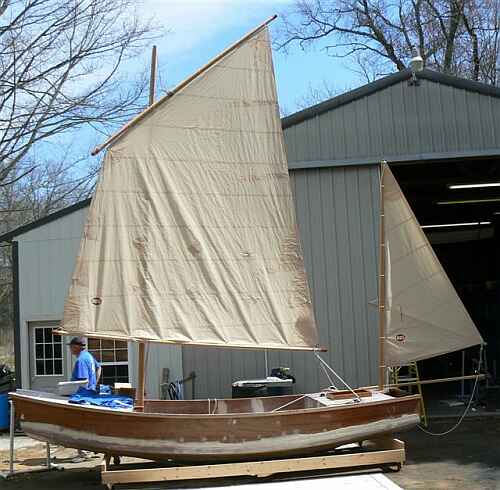

David Chase's Mikesboat is close to done, here it gets its first rigging.

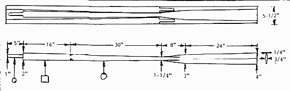

I'm going to show drawings for 7' oars which are about the most useful length for me.
WHAT KIND OF OARS....
The oars I make are really derived from the patterns of the late Pete Culler. They are characterized by having heavy square looms inboard of the locks and long narrow blades in the water. An example is shown in Figure 1.
The square looms are easy to build, help balance the oar, help locate the oar in the locks, and keep the oar from rolling around on the wales.
The long narrow blades go against modern thinking of spoons, but for long distance rowing, long and narrow is the way to go. The average mortal can only pull so much of a load, in spite of what an Olympian might do. The Culler blades can match the mortal's pull. They might slip a bit when starting a heavy boat from a standstill, but once up to speed, the have full grip on the water. They balance better. They are less fatiguing. They have less windage. By the way, the oars of traditional Irish caurrahs have no blades on their oars. Neither do the paddles of some traditional kayaks.

First cut the 1x6 boards to the proper length. lay out the centerline with a straight edge. Then draw the pattern for the center piece, the one with the blade, around the centerline. Cut out the center lamination following the line closely with your saw, because the outer laminations of the blank are made from the off fall and there isn't much extra.
You can draw patterns of the outer pieces and cut them out. But it's easier to glue the pieces directly to the center piece and trim them after the glue cures. Trial fit the outer pieces. You may have to trim them for the proper shape where they blend into the blade area of the centerpiece. When you are satisfied, butter them up well with glue, and clamp them in place. You may need to tap in a a light temporary nail to keep the pieces from sliding around on each other because almost all glues are quite slippery until they start to set. Try to get glue squeezed out all around. And be sure the blank is resting straight while curing. Walk away from the blanks until the glue has cured hard.
After cure, trim the outer pieces to match the centerpiece. Use a plane and sander to work these pieces to their final lines, being careful that these faces remain square to the other two unworked faces.
Now cut the two unworked faces of the handle and loom of the oars to their final dimensions. Draw centerlines down the two worked faces and lay out the shape of the handle and loom. Cut to the lines and sand smooth. At this point the cross section of the oar from handle to loom is square.

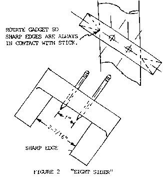

The oar drawing shows how much of the loom is left square. The rest is to rounded. You start by drawing lines on handle and loom that allow you to make the cross sections octagonal. You can draw them using the gadget shown in Figure 2. Then cut down to the lines with a half round rasp where the lines blend to the square section of the loom. Then use a drawknife or plane to remove the rest of the material down to the lines along the shaft. Now she's eight sided. To round it you're supposed to sixteen side it and then round it out. To tell you the truth, I leave mine eight sided, including the handle and the area which fits in the rowlock.
8sider
Lastly you need to trim mass out of the blade. I plane the blade down so its edges are 1/4" thick. Then I use the front roller of my belt sander to hollow the blade slightly on either side of the center, leaving a ridge in the center.
I think the only critical part of these oars strength wise is the 1-1/4" section where the blade meets the loom.
Give the oars a good overall sanding, but leave the handles rough.
Wrap the rowlock area, from the square section down 8 inches toward the blade, with mason's twine. Wrap it tightly and use knots to secure it.
Give the oars three coats of spar varnish. That includes putting varnish on the twine binding. It will go a long way towards holding the binding in place. Don't varnish the handles.

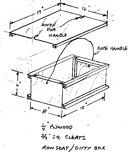

Figure 3 shows a rowing seat/ditty box that I've been using for years. You might have to tinker with it a bit to get it to fit your butt. As for the height of the box, it is nice for a bar placed across the rowlocks of your boat to cross you at belly button height. That would include any padding on the seat such as a flotation cushion which you should have on board anyway. For that matter a stack of two or three stiff flotation cushions can make a pretty good rowing seat.
rowseat
Here is what the seat looks like for real, this one about 15 years old now. Here are some things you might keep inside the seat: spare oarlocks, a knife, some line, sunscreen, Vasoline, binoculars, compass, whistle, and some energy bars. Always take a lot of drinking water with you also when you go rowing.

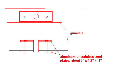

If your hull's side have limited flare, say less than 15 degrees, you can make some cheap oarlock sockets that are as good as store bought. I got the idea for these, plus the oarlocks that follow, from Phil Bolger who used them on his Spur 2 rowing boat that appears in his book BOATS WITH AN OPEN MIND.
Here is how it's done.
What we have here is simply two metal plates bolted to the wale with the proper sized hole (usually 1/2") drilled in each. Phil had his made of stainless steel. I made mine out of aluminum and have had no problems. I used an aluminum yardstick of the type carried by lumberyards for use with drywall as the basic material. I think the metal is about 1/10" thick and about 1-1/8" wide. I cut the aluminum to 3" lengths, stacked them up and drilled the oarlock hole and the bolt holes all at the same time. Filed off any sharp edges. Clamped the plates in the proper position and drilled the wooden wale. Bolted the plates in position and that's it. These work well because the oarlock bears on the metal parts which are about 1" apart, a bit more than the usual shallow factory sockets. So far I haven't worn them out. By the way, it helps to grease any oarlock from time to time, ordinary Vasoline works well.

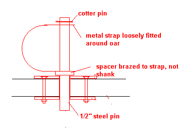

I haven't tried these but Phil swears by them. It is really a thole pin with a bracket to retain the oar. Phil has always said that thole pins are better than the usual factory oarlock where the oar centers directly over the rotating pin. With a traditional fixed thole pin the oar rotates around the fixed pin as it bears against it and Phil says that is a better motion than with the factory oarlocks. The pin shown here could also be fixed, the bracket rotating around the pin with the oar! I should try these.
