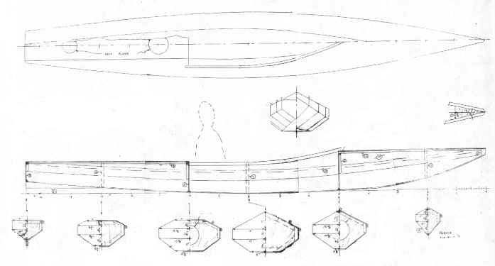

IMRESBOAT, DOUBLE PADDLE CANOE, 15.5' X 26", 50 POUNDS EMPTY
Imresboat is a slimmed up version of Larsboat which was designed for Lars Hasselgren to replace a Folboat that had finally met its end. Lars wanted capacity for two, plus decking, as with his old Folboat. But Imre wanted something more slender and lower in the same length. The result is 26" wide instead of 30" wide. And the result of that is that Imresboat is a single seater because the capacity has been reduced with the width. Imre wanted it even narrower but I hoped to stay within the tippyness bounds of most folks. Not sure yet how narrow something like this can get before the normal guy can't sit upright in it. I do know that you apparently can get used to about anything in that respect as experienced kayakers do.
The deck opening is smaller to sit just one man but I think it is longer than the usual kayak because us older folks have trouble fitting our legs through the hole in a performance kayak. Something like putting on a pair of pants without standing up.

Another change I made with Imresboat is to go to thinner plywood to save weight. In this case I suggest 1/8" ply for everything except the bottom which is still 1/4". Not sure where the 1/8" plywood comes from but it used to be what they skinned doors with. Be sure to boil a sample and hope it is waterproof. Anyway, Chuck Leinweber brought a Toto to our messabout with 1/8" ply sides and 1/4" bottom and it struck me as being fine for stiffness and strength. Like Toto and Larsboat, Imresboat is taped seam construction. I'm guessing at the 50 pound weight but for example Larsboats built of 1/4" plywood have weighed between 60 and 80 pounds depending on who built them.

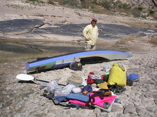

Can you believe all this gear came out of that boat? Skip surveys all the camping stuff that came out of the bowels of my Imresboat so we could pull it onto the sandbar for field repairs in Mariscal Canyon.

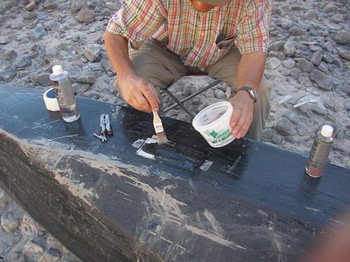

We pulled the boat up on the gravel bar we camped on that night and did a field repair. Nothing to it.

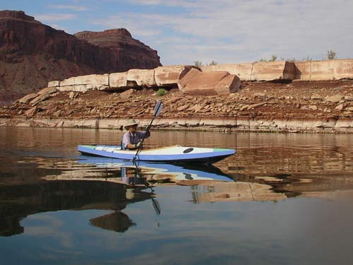

Sandra took this picture on Lake Powell. It was a calm morning of our last day on the lake. You can see that the boat is down almost to the second chine, but this only made the boat more stable and did not hurt the performance. At the start of the 80 mile Rio Grande Trip, this chine was just under water and that made all the difference.

Taped seam construction from four sheets of 1/8" plywood and one sheet of 1/4" plywood.
Imresboat plans are $30.
