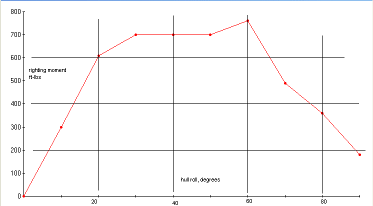

NEXT TO GLANCE A RIGHTING MOMENT DIAGRAM...
Hullform will calculate righting moment diagrams in a jiffy. These are nearly impossible to do by hand in a normal lifetime so small boats always did without them until the PC was invented.
Anyway, I ran the Hullform program for this shape with a total weight of 1000 pounds (probably the minimum this boat will sail at) and the 19" cg location. Here is a graph of the results...
Hmmmmm... Interesting. This is actually a composite of two Hullform models. The first is the full hull model and the second model has a cut down stern that is supposed to simulate flooding of the cockpit deck, but not under it. I assumed the cockpit would flood at about 60 degrees so don't take that part of the curve too seriously.
Well, there is nothing kinky about it. I don't see any sudden swings that you would see with a light flat bottomed boat that will capsize all of a sudden. This one settles in at about 700 ft-lbs. By the time it starts to fall off at around 60 degrees the cockpit would be flooding and I would hope the skipper is getting scared enough by then to release the sheets if he can get to them. Well, so far so good.

The above curve is for what is probably the lightest sailing weight for this boat, that is with a single skipper and almost no gear. If she weighs more you can multiply those righting moments by the ratio of the higher weight, so if she weighs 1500 pounds then the max righting moment would be about 1000 ft-lbs. But don't forget eventually at about 90 degrees the righting moment goes to zero and any ratio times zero is still zero.

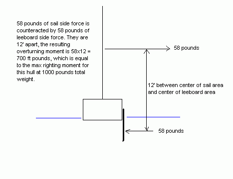

The righting moment is resisting the overturning moment produced by the sail's sideways force and by the force on the leeboard that is opposing the sail's sideways force. When a boat is close hauled almost all of the sail's force is really to the side and I will assume that for now to make like simpler here. The center of the sail area on this boat is about 12' above the center of the leeboard area so to make a 700 ft-lb overturning moment the sail's force would be just 58 pounds. Now the question is "How much wind will produce 58 pounds on the 113 sq ft main sail?"
OK, in a general way the force of the air on a sail or wing or whatever is F= .0034 x S x C x V x V where S is the "area" in square feet, C is a coefficient related to foil shape etc that we need to look up from test data, and V is the wind speed in knots. So this mainsail has an area of 113 sq ft, and the C is usually about 1.5 when the wind is fully applied on a typical good sail. It works out that V would be equal to 10 knots. We would expect the boat to be overpowered if the wind exceeded 10 knots. That is not very windy but lug sails usually reef well so the skipper will need to keep an eye out. On the other hand in order to sail well in light winds you need to have a lot of square feet up there. As an aside I should say that you find as you get elderly that a small sail area to handle higher winds and a good motor to handle lower winds is a very good combination.

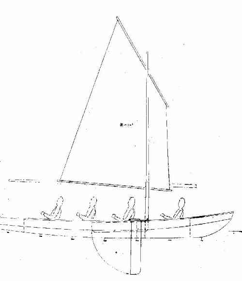

Raider

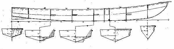

RAIDER, ROW/SAIL BOAT, 24' X 6', 500 POUNDS EMPTY
Norm Wolfe built his Normsboat to my design so we were acquainted. He visits the Baltic countries regularly and had participated in a "Raid" in Finland and was going to make it a regular thing, maybe with his own boat. A Raid is a pseudo race with boats that row and sail, over a fairly long course taking several days. But the racers don't sleep in their boats. Instead they do a stage each day, sleeping and partying on shore in nice prearranged places each night. So the "racers" need carry no gear except what they need during the day and a rescue boat is always nearby. I think each boat must have at least two crew. So what sort of boat do you take? A true sailboat will be helpless in calm and a true rowboat will get left behind in a breeze. Norm wanted something that would row well but convert quickly to sailing and even do hitches with oars and sails together at the same time. He wanted four oarsmen.

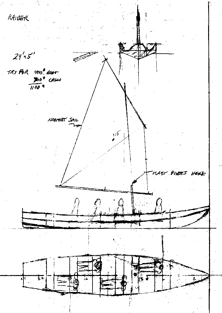

I sat with him at McDonald's one day and we sketched this:
The idea was a boat long enough to take four at the oars, with a folding rig that could be left up while rowing or quickly taken down and up again as the winds advised. I suggested a V bottom as it would row the best and beaching was not going to be a problem. The lugsail was lifted from the Normsboat. (I see we were thinking at the time of offset oarsmen each with a single long oar but it was first rowed with pairs of oars. I have been told that rowing with single long oars is preferred in rough water but that way you will always need an even number of oarsmen.)
The plan was to build in Europe and leave the boat there, so the drawings had to be in metric dimensions. I had never done metric because I found when I first started that metric tapes and scales were not commonly available in the US, still aren't, so I stuck with English measures. But I did draw this one in metric and was always worried about real goofs going unnoticed by me. I don't know if there were any. The boat was built in Estonia, I think, in the back of a car repair garage by a non boatbuilder. But that is OK. My boats are designed to be done that way. I never heard from the builder concerning any mistakes although I suspect he is the type of guy who forges ahead regardless and gets it done. I thought he did a fine job and I should say that there are some major twists in the panels in the bow area to deal with. I can see small changes from the plans but nothing I might not have done myself. He has a slotted gunnel. And he used a modified flag pole to replace the wooden one shown on the drawings. I should mention here that I am pretty sure a buoyant wooden sailrig is a safety factor for a sailboat in that it will prevent a capsized boat from turning turtle by my experience. I still say wood is the best material for a small sailboat. But if you have the proper flagpole at hand......

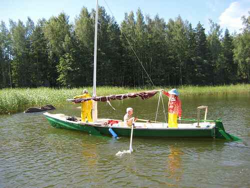

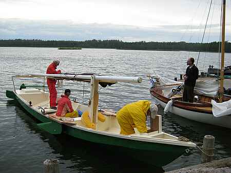

The Raider was finished in time for the 2008 Finnish Raid. Norm jetted over a bit early to sort it out or at least get used to it. He took along his Normsboat sail. The race was apparently its first time in the water, more or less. Here it is being paddled out for a sail:

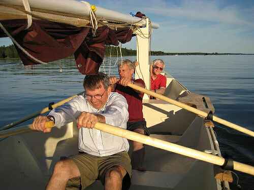

And here it is with some of its rowing crew:
Norm assures me these are hardy men, Vikings all! That is Norm, I think, in the bow seat with no oars urging them on. Can't you hear him yelling, "Come on! Pull! Pull! Break your backs!", just like in Moby Dick. Looking at the photo I thought they might do better by sitting a little higher on say a flotation cushion and maybe with longer oars, but you never know. I gave each man a meter of space as I recall and that looks to be enough. You can see the folded rig is OK. Norm thought he might revise it to fold a bit lower.
Well, I can't tell you how Norm and crew did cuz I don't know. But they did it!
