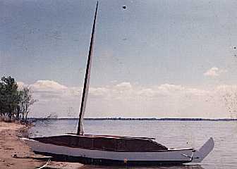

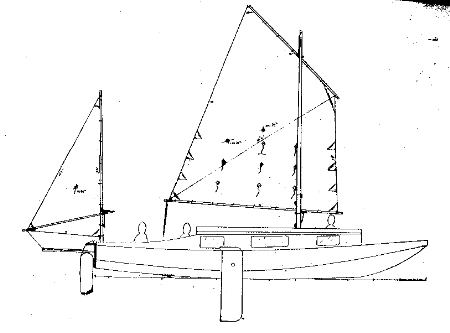

But we always advance to larger boats, don't we, at least until we learn our limit. So then I went to a Bolger Birdwatcher. Here is an old photo, although I still have her, now twenty years old and still in very good shape:
You see she is pulled out of the water about 1/3 of her length and that is quite easy to do. She is 24' long and about 1000 pounds ready to go but only has about 2 or 3" draft thusly. Now, here is the gist of this story. This basic hull is 24" deep to the wale so maybe a 30" step to the top of the bow and then down into the boat. A little care is in order since there are cleats, etc. up there too, but I can still do it. Smaller people have to climb a bit though.

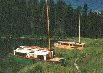

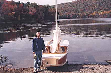

So back around 1990 I was in my idealist boat design stage. I did a few that had the Bolger theory scow shape where the side and bottom are bent to the same curve. The idea is that the water pressure on side and bottom then would be the same so there would be no nasty curling vortex at the chine. The resulting boats go quite well as long and the water isn't too rough but the result is always a very swept up bow that a lot of folks don't like. Into most of these I put a small well in the bow to take your muddy shoes and anchors but I also gave it a low front shelf so you might use it as an easy step to the bow deck. One of these was Deansbox and here is a photo of a new one by Josh Clover, the photo taken at the Texas200 which he completed:
You can see how easy it would be to step aboard although it wouldn't be too hard with the 15 footer anyway.

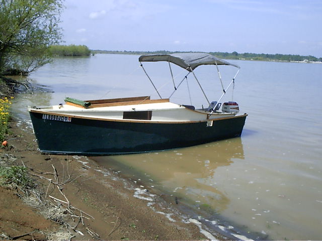

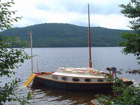

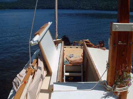

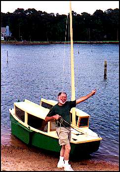

Another more ambitious project was Jewelbox, the prototype built by Karl James. Jewelbox was my idea of a Birdwatcher made easy to use. It had about the same interior volume as BW although it was 5' shorter. The ends were snubbed such that I could put the step well in the bow, a motor well in the stern, and I got away from the rudder linkage required by the BW double ended hull. I never said it was prettier than Birdwatcher.
Karl used the boat for about ten years before designing his own replacement. He took it everywhere including driving up to Rend Lake one messabout so I got a chance to see and use it a bit. It was quite clear to be equal in room to BW but much easier to use. You could get into the cabin in about two steps. And there was another advantage of this bow that may not notice right off in that these are very easy to launch from a beach. You simply stand with one foot in the step well and the other on the shore and push off, then saunter to the stern to run the ship.
Eventually Jewelbox Jr got built and again with the step well. No one complained.

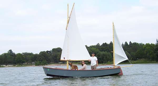

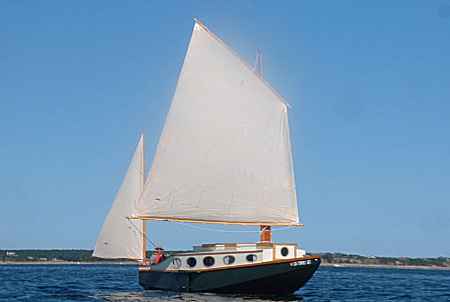

Later I got to see a pair of IMB's in Texas. Here is Jerry Scott's:

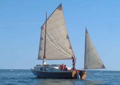

IMB has a short bow deck at about 2' high and is not hard to board from the shore, especially if you sit on the deck first and swing you legs around and slide into the cabin. (Remember that IMB, Jewelbox and Scram all have offset masts which allow you to go directly inside.) Hmmmm? One issue I was faced with was that folks wanted pointy boats more than square boats and you can't put a step well in a pointy bow. A low bow deck like IMB's would help.

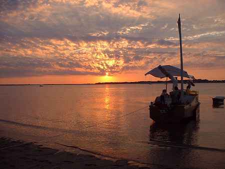

IMB eventually evolved into Philsboat with a pointy bow. No step well, although it has an anchor well. Chris Feller brought one to Rend Lake and I got to sail in it. Again, no problem with boarding by sitting on the low (approx 2' high) bow deck, swinging legs around and into the cabin.
This works because usually the bow of the beached boat is so far on shore that you can board without getting your feet wet. Philsboat is so shallow that Chris would beach it stern first like this. I don't know if L Francis ever thought of a boat like this but I think it is getting close to the ideal beach cruiser since it has shown itself to be self righting from a full knockover without anybody getting wet inside (although things may tumble about).

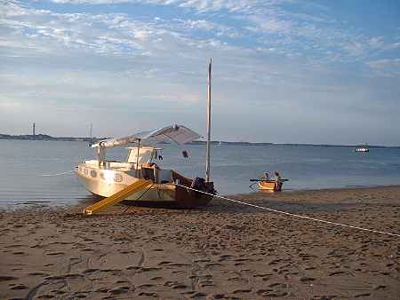

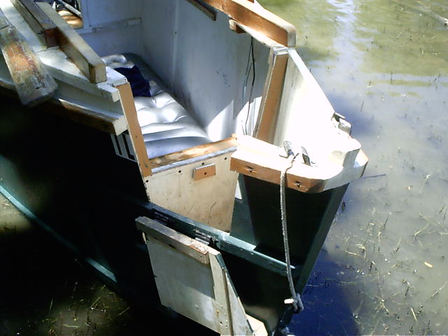

I suppose I should demonstrate with my own data point. My AF4 is a bit of a grunt to get into even though I gave it a step in the bow. It is about 3' up to the bow deck.
Getting aboard meant either scaling the bow and then dropping down into the cabin slot, or, just as often, wading to the stern and climbing aboard via the motor well. As you may recall I rebuilt the boat a bit last year and added a door in the bow and a step through slot through the first bulkhead so I can actually make a giant step with one leg into the cabin with the other foot still on the ground. Then into the cabin with a "Look Ma! No Hands!" Here is the door (shown here "beached" in a flooded farm field):
Made all the difference in the world, more to my wife than to me. But she has been along every AF4 boat trip this year and that never happened before. So, a word to the wise.......
