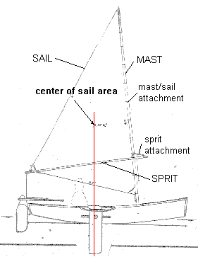

RIGGING SHARPIE SPRIT SAILS
THE BASIC ELEMENTS...
sharpie sprit sail

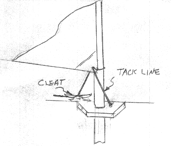

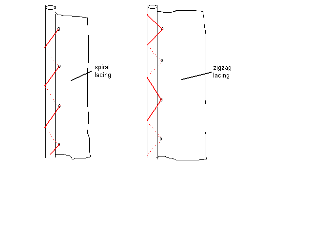

MAST/SAIL ATTACHMENTS...
birdwatcher
lacing

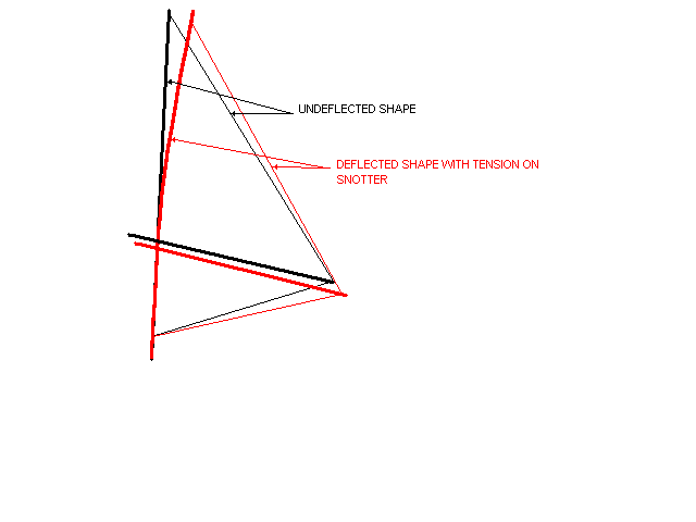

THE SPRIT...
mast bending

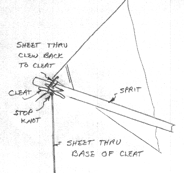

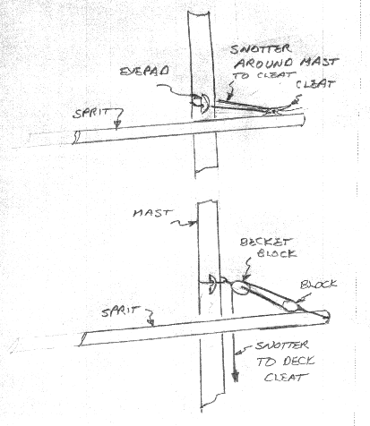

SPRIT ATTACHMENTS...
clew attachment
snotter tackles

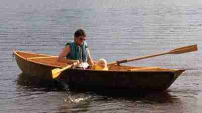

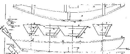

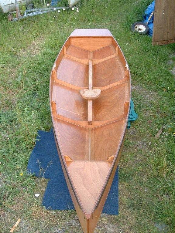

SPORTDORY

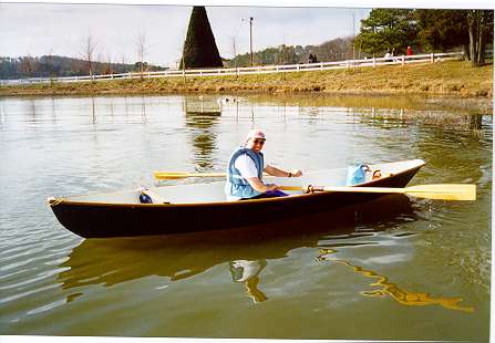

SPORTDORY
Sportdory plans are $20.

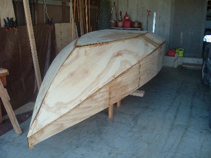

And a Family Skiff is going together in mid Missouri...
