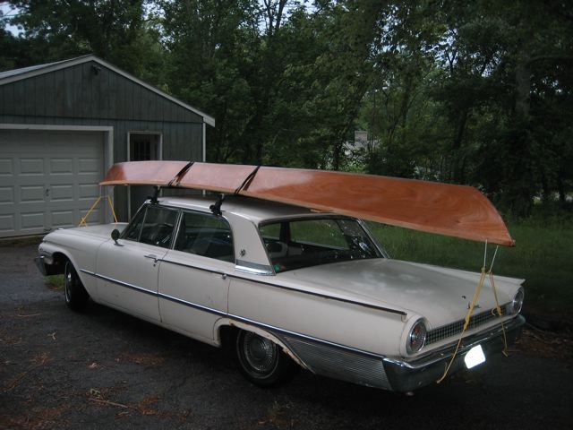

Seth Mancinko says your gonna need a big long car if you're gonna cartop a Bateau.

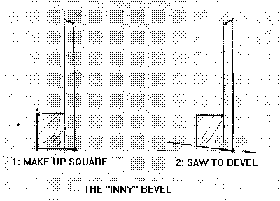

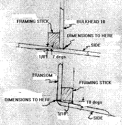

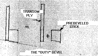

BULKHEAD BEVELS

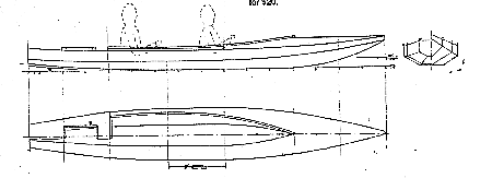

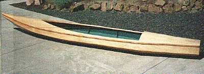

Larsboat
larslines

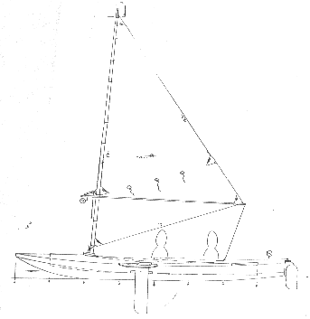

I also drew up a trimaran sailing rig for Larsboat called "Trilars" which is sold separately for $10.
trilars

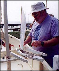

It is pretty much a clamp on rig except for the small mast step and partner. Down in Texas Charles Nichols built a model of it:

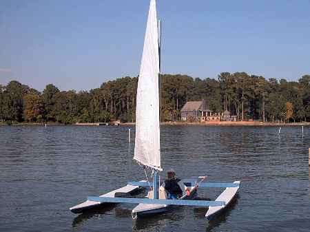

It's different from the Trilars. The main hull is per the Larsboat blueprint but built without the deck. I thought the rudder and leeboard were just like the Trilars print. The sail is a large balanced lug instead of a sharpie sprit. The floats are triangular in cross section instead of flat bottomed as on the Trilars, and I'm pretty sure the Charlars is wider than the Trilars which I drew narrow enough to trailer without disassembly. There wasn't much wind that day but I got a little sailing in with the Charlars and it seemed fine with the potential of being wicked fast. My only thought was that it was fast and stable enough (it was stable as a dock) that in rough water it might spear a wave and ought to have the fuller deck, something I think the paddling Larsboat can get by without in most cases.

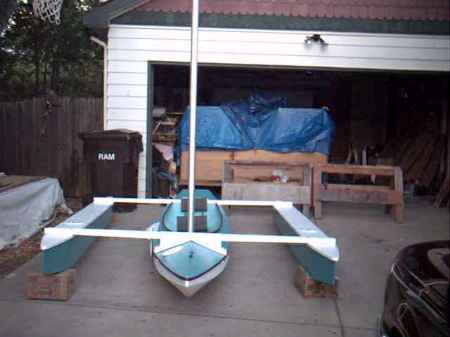

And finally Jeff Blunk built a Trilars in Colorado. Haven't gotten a sailing report yet:

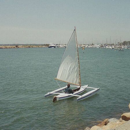

And Errol Smith down in Australia made a Trilars and has sailed it a lot. But it is not quite a Trilars and in particular has a centerboard instead of the blueprint leeboard (probably makes it a one man boat)..
Larsboat plans are $20 and the add on trilars plans are still $10 for now.
