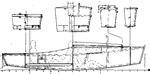

AF2 is a rather typical sharpie, 20' long and 5' wide on the bottom with a single gaff sail. The cuddy cabin is roomy enough for a solo bed room and it has a slot top that could be left open for sailing on nicer days.
One of my design guesses was that it would have an empty weight of 600 pounds and I'll tell you how I stab at that. AF2 requires, no guesses here, six sheets of 1/4" plywood, seven sheets of 3/8" ply, and one sheet of 1/2" ply by the blueprint. The usual plywood weighs about 25 pounds for a 1/4" sheet, about 38 pounds for a 3/8" sheet, and about 50 pounds for a 1/2" sheet. The resulting pile of plywood should weigh about 470 pounds and I have found that to be a good guess at the weight of such a hull bare with no extras. Add maybe 50 pounds for the sail rig. Then round up and there I am at 600 pounds.

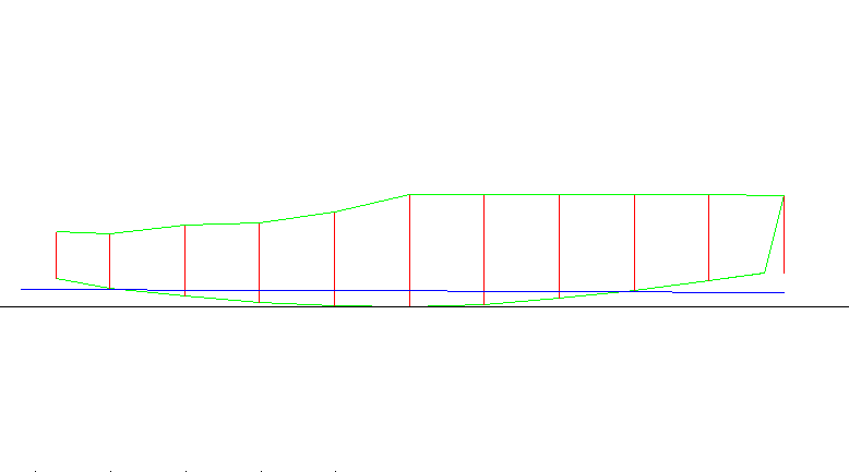

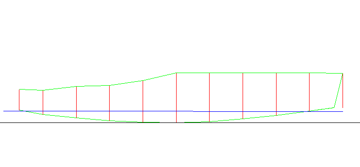

Now that is a minimum weight boat in the water. Add a skipper and some of his junk and let's say the boat is sailing at 1000 pounds most of the time. Using our old friend Hullform we would expect a waterline like this:
It looks quite good to me and I have been taught to look at it with Phil Bolger's eyes. He said sharpies need to sail over the water and not through it. The bow is swept well above the water to meet the waves with the bottom and not pushing through them with the sides. The stern is also well out. She would have a short waterline bolt upright as in light winds, minimum wetted surface area so they say. But a sailing breeze would heel her over to get a longer waterline when there is power in the wind. And heeled she would meet the waves with the edge of her chine like a V bottomed boat. It all works great provided the conditions are right. The best case is a strong wind with smooth water. The worst case is rough water and little wind. So sharpies have split personalitites much more so than V bottomed or round bottomed boats.
I might add that the short upright waterline helps a lot for quick maneuvering.
Now let's add a couple of big passengers and we are up to 1500 pounds and she looks like this:
Still looks OK but I might suggest this would be the limit for brisk sailing.

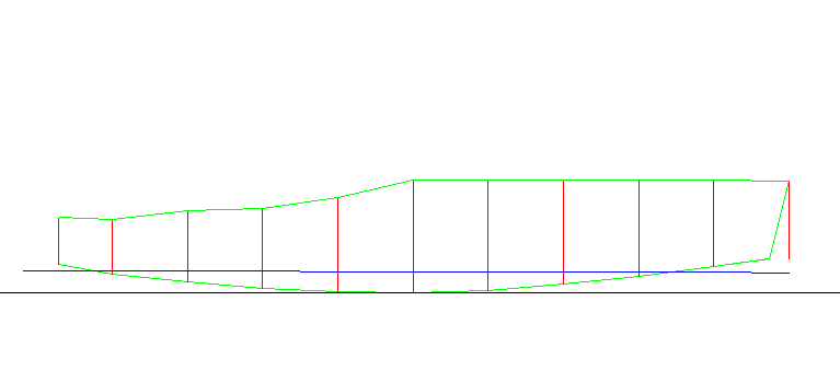

Now let's add a couple more passengers, a full house but AF2's benches have room for four adults. Then we have this at 2000 pounds total:
The transom is pretty much in the water and will drag when the boat is heeled. The bow is ready to plow through the water. I'd say this is a maximum but most likely it would be a once a year sort of outing, not serious sailing.

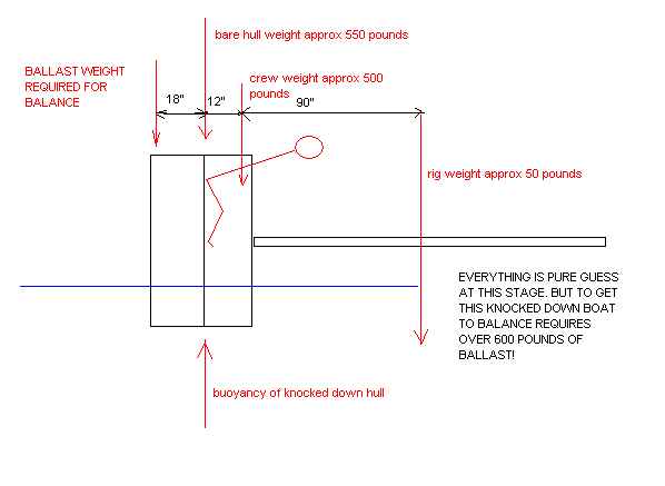

Here is the picture I draw for a first cut at a problem like this:
What we have here is a front view of the boat knocked over 90 degrees with the weight of three adults on the raised cockpit deck. I've taken the weight of the hull to be 550 pounds distributed evenly thoughout, and the weight of the rig at 50 pounds. The main effort of the buoyancy of the tilted hull is taken to be halfway up the side. Now solve for the ballast weight needed to put it all in balance. If you take the torque about the point of buoyancy you see the torque twising down to the right is the passengers (= 12x500=6000 inch pounds) plus the sailrig (= 102x50=5100 inch pounds) for a total of 11,000 inch pounds. Counteracting that is a torque in the other direction provided by the ballast at 18" so the ballast must weigh 11000/18=611 pounds for this crude first look. I am not surprised at all. All of Bolger's small sharpies seem to have 500 pounds of it.
Here I've assumed the weight of the bare hull is right above the point of buoyancy and I think that is pretty safe to start with. So the hull weight hardly figures into it. The real killers are the crew and sailrig weights and distributions. You can see how outside ballast placed way down on a keel has a real advantage. And you can see that the crew weight, if placed on the bottom as with a Birdwatcher type hull suddenly becomes its own ballast to help the hull right instead of trying to pull the hull over.

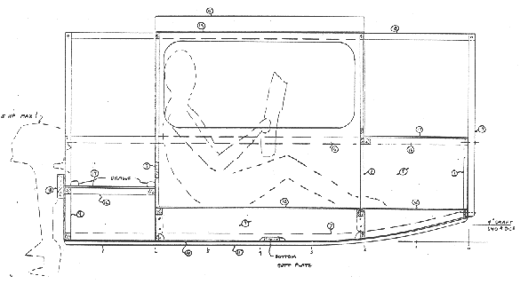

DOCKBOX, NANOSHANTY, 8' X 5.5', 300 POUNDS EMPTY
Go ahead and laugh.
Sleeps two. 5 hp max. Very protected water only.
Nail and glue construction from two sheets of 1/4" plywood and four sheets of 3/8" plywood.

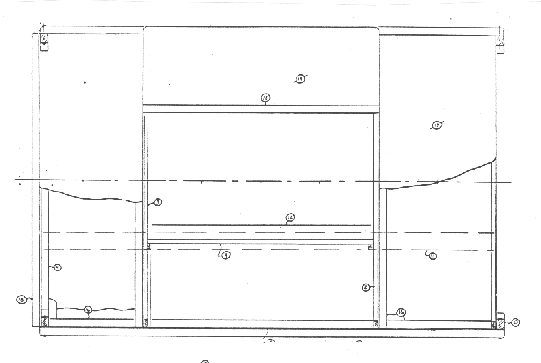

dockbox

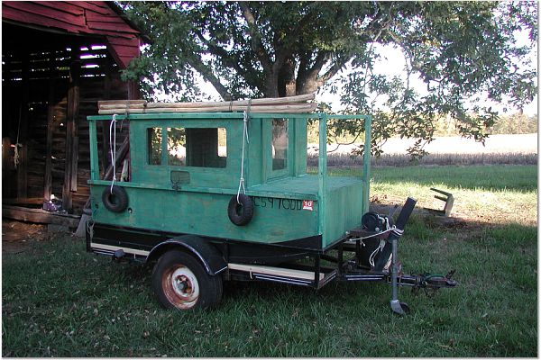

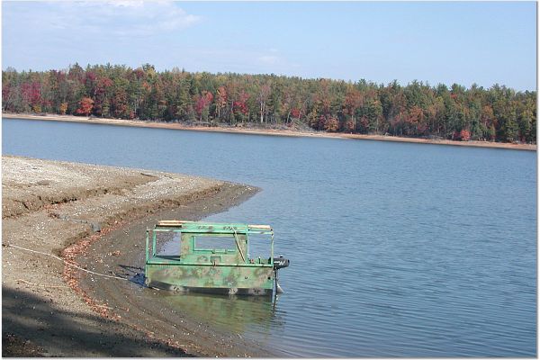

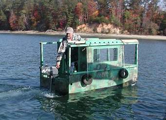

Bill McKeough built the prototype in Oklahoma but he narrowed the boat a foot so it would fit on his utility trailer (I would have done the same if I had the trailer already on hand) but he said the extra foot width would have been nice. I thought his finished boat was perfectly in tune with what the designer had in mind, right down to the mini tire fenders. Note that he added oarports, something not shown on the blueprints but not a bad idea.
Here it sits on the shore in autumn colors:
And here is Bill underway with his Dockbox:
He used it on a fishing trip and wrote:
"Hi Jim, I got out fishing; caught a mess of stripers. Did some speed runs with a GPS reading in Knots. Calm conitions, temp in low to mid 30'sF. 2.5 hp 2cycle engine. Top speed 5.3 kn; half speed 4.2 kn; slowest speed 2.2kn; I have to tow a bucket to slow down enough for trolling! When the wind picked up a little it was nice to be sheltered. Great little boat! Thanks,Bill"
