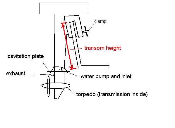

Here are the basics of your outboard's lower unit:
The question is, "What is the correct transom height for the motor."
IT ALL DEPENDS....
For one this I should say up front that the tilt of the transom is almost always about 15 degrees as called for by the motor makers. Most motors have some adjustment and some will even mount to a plumb transom. But if you are designing a powerboat start with 15 degrees and you will be on first base.
Now back to our question. Motors vary in the length of the lower units. BUT I have never seen one that needed a transom height less than 15". In fact I think that was the standard for a long time and almost any older motor you pick up will have this "SHORT SHAFT". But there are lots of LONG SHAFT motors out there, even with small hp heads. I think the standard in long shaft is 20" and often they are made by inserting a 5" extension in a short shaft lower unit. I suppose if you find one of these you can convert it back and forth, or maybe find an extension kit for your short shaft motor. Actually I think long shaft motors are far more common now than in the old days and there are motors even longer than 20".

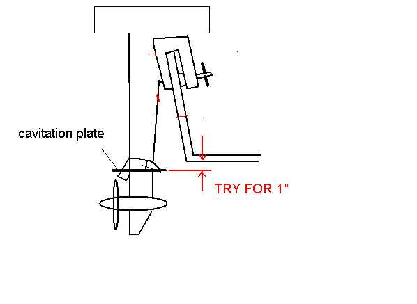

Actually if you ask a mechanic how the motor should be mounted he will likely answer nothing like "use a 15" transom" or whatever. Here is the general rule I have always heard for actually getting the motor height correct. FOR ALL SMALL POWERBOATS THE CAVITATION PLATE SHOULD BE 1" BELOW THE BOTTOM OF THE HULL. Like this:
That is how I have rigged my motors and have had no trouble. I assume the cavitation plate acts to prevent air from traveling down the shaft to the prop at which point the prop will start to push on air instead of water.
I guess the water pump and its inlet, which are right above the cavitation plate, will always be immersed given something like ordinary hull trim.

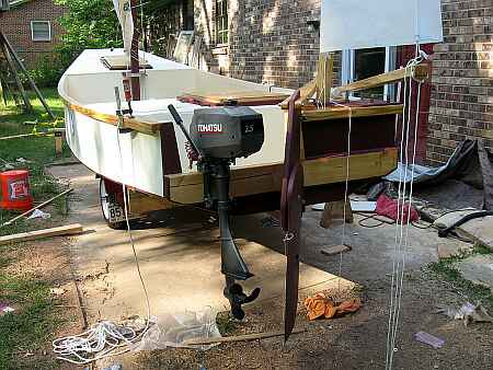

Here is my experience with my Birdwatcher, which is swept up and to a point at the stern. The motor can't be mounted at all in the stern since it is a double ender with the rudder at the end point. So I put a motor mount off to the side about 2' forward of the stern tip. I knew about the 15" standard by then and guessed at where the waterline would be and made the motor mount to be 15" above the waterline in normal trim. But a light boat with a lot of rocker is going to rock back and forth quite easily and with the Birdwatcher once the motor was running I could hear the exhaust popping loudly as I walked forward (say to handle an anchor) so on the advice of Motor Max I cut my add on transom down an inch which helped. At walking speed in normal trim I think it is just right. At full speed, which seems to be 6mph with any amount of horsepower, the stern squats way down to the point the motor mount is starting to skim the water! This with a boat that probably weighs about 800 pounds.
So some of you might note now that I never have designed a double ended sailboat. One of the lessons I learned from Birdwatcher is that a normal transom can be a wonderful thing. You can hang a motor back there and use a normal rudder and tiller too!

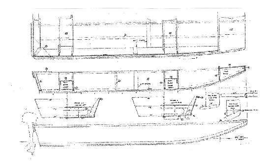

Here is an example of how I design them now, this example being Bill Moffit's Mikesboat;
Pretty simple for me: I just design the transom to have a top edge still about 15" from the bottom of the hull which is this case is about 8' forward of the stern. The stern sweeps up maybe 9" from there leaving about 6" of "transom" depth at the motor. The motor plate is just a 2x6 here. The mount is part of a motor well, well blocked off from the main hull by a watertight bulkhead. It has to be that way or else the boat would swamp in a jiffy from any serious stern wave. As it is any water that slops above that transom just ends up in the well and returns to the lake through drains in the bottom of the well. I've done several boats this way like Caroline and Philsboat and Mayfly16. And no one has told me the transom height was way off.
Now, a motor in a deep well is not that easy to use, right? Essentially you start the thing by leaning way back, get it headed in the right direction and steer with the tiller, as I do with Birdwatcher. Docking is more difficult but what else is there to do?
