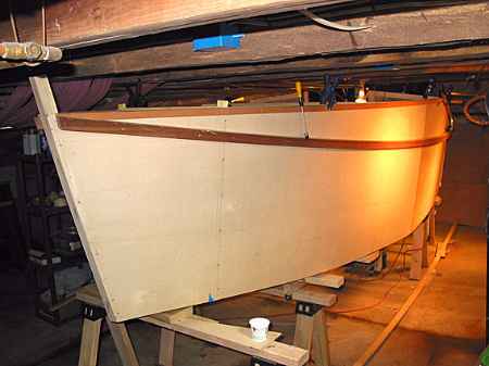

Rene Vidmer's nice AF4B project underway and he has never asked me about its headroom.

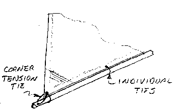

Nothing fancy needed here. Almost anything will work. Because the sail is balance already to a great degree the sheet forces are less than with other sail types. Because the tack is pulling down in the middle of the boom, the boom has less tendency to lift so downward pull of the sheet on the boom is of less importance. The location and lead directions of the sheet are of little importance also. It's another advantage of the balanced boom. By the was, if the boom is omitted to make the sail boomless, the sheet location is very critical and its needs change all the time. I think the boom is a great invention! The boom on a balanced lug can be quite light and still work.

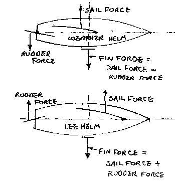

Also it should be mentioned that one of the most effective ways to trim the boat, helm-wise, is to rake the mast as required to move the sail are fore or aft. You can see that a small amount of rake will move the mast head quite a bit and the entire sail will go with the masthead. Old time boats had adjustable mast steps or partners. On my designs you can usually shim the mast partner on the bulkhead. It's one place where tinkering pays off. Making a mast a bit longer than shown on the plans is also almost always a good idea as it allows for this tinkering not to mention real life stretch of the rigging.

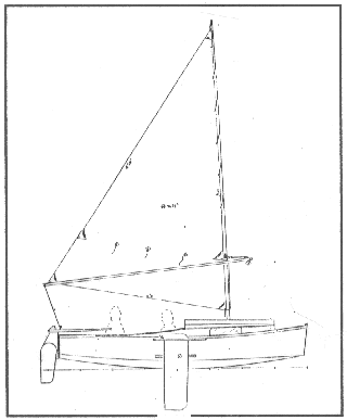

TOON2

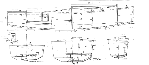

TOON2, CUDDY SAILBOAT, 15' X 5.5', 300 POUNDS EMPTY
Toon2 is in almost every way a multichine version of the AF3. I think these multichine hulls are more like round bilge hulls in that I keep the upper chine above any normal waterline so only the very easy lower chine flows through the water. Other boats shaped this way such and Piccup Pram and Woobo have proven to be very fast and well behaved. Yet they still have a flat center bottom plank that allows you to beach the boat upright.
So one might think that a multichine like this is in every way better than a real flat bottomed boat, but that is not totally true. For one thing multichines have a few more pieces to make and must be assembled with taped seams. Taped seams are light and probably more rot resistant than chine log construction but they can be a bit harder to understand at first glance. And someone building a boat with his children might have second thoughts about the kids messing around with large pots of epoxy. Also the bottom plank of a multichine hull is a lot narrower than that of the equal flattie so floor space is reduced, a real factor if you hope to sleep two on the cabin floor, which you can't do with Toon2.
Toon2 has about the same layout as AF3 but it is about 12" wider and I gave it some bench seats. I'm thinking this will be an excellent solo boat for a short cruise with someone used to tent camping, and yet be a good day sailer for two or three adults, or maybe two adults and two kids. This size boat has always been popular and always will be because it has that sort of capacity and yet can be manhandled by a solo skipper in almost any condition.
The sail rig is the same 96 square foot sharpie sprit that I used on Pencilbox and AF3. It started as the main on my old Bolger Jinni from 20 years ago. Very easy to make and use and efficient if you can live with a 21' mast on a 15' boat.
Toon2 uses taped seam construction with no lofting or ladder building jig required. She needs seven sheets of 1/4" plywood and two sheets of 1/2" plywood.
