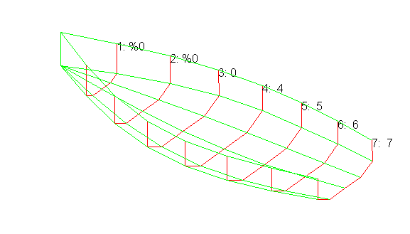

We can write the basic balance as the sail force S = W x D / L where W x D is the "righting moment" of the hull and D is the distance between the center of the sail area and the center of the leeboard (or keel or centerboard, etc.) area. W is the total weight of the boat with everything on board. L is often called the "righting arm" and changes as the boat rolls and is fairly difficult and tedious to calculate. But the free program Hullforms can handle it. To use Hullforms one must first model the hull in three dimensions. In the last issue we showed the model for Picara but this essay will focus on smaller boats. This is my Hullforms model of the 14' boat Ladybug (the prototype is well along in construction down in Texas):

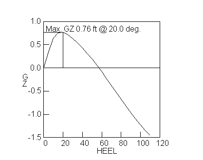

Given the hull lines and a weight/center of gravity information Hullforms will calculate the value of L and graph it for various values of heel as when the hull rolls. Here is the graph for Ladybug at 400 pounds weight and with the cg 24" off the bottom. This is about the lightest I would expect a loaded Ladybug would sail at complete with a minimum crew. I took a stab at the cg location.
Here Hullforms is calling the righting arm "Gz" instead of "L". The maximum value is .76' so the maximum righting moment of the lightly loaded Ladybug would be .76 x 400 = 304 ft-lb.

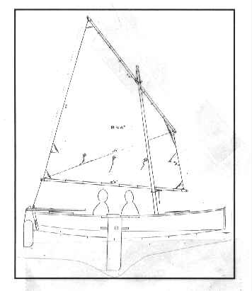

Here is a picture of Ladybug's sail rig:
The distance between the sail area center and the leeboard center is about 9'. So if we solve for the maximum allowable sail force we would get S = 304 / 9 = 34 pounds. If the force on the sail exceeds that amount then the lightweight Ladybug will roll past the point of maximum righting moment (at 20 degrees heel according to Hullforms) and continue to roll until the force on the sail is relieved.

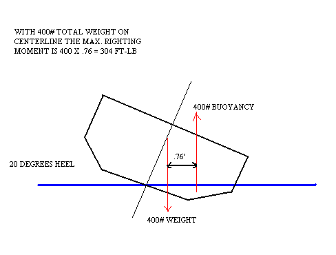

Anyway, the the above case has its weight centered on the hull because that is how Hullforms does its math. At the point of maximum righting moment the situation with Ladybug would be something like this:

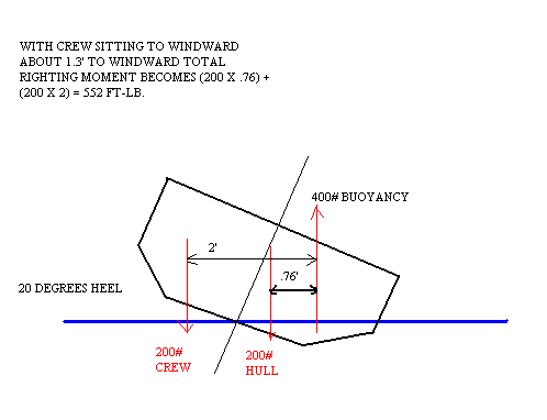

Now let's take the perhaps more common condition of the skipper sitting to windward on the bench seat. Not exactly hiking in any extreme way, just sitting on the bench on the windward side. In this example I will assume the boat weighs 200# and the crew weighs 200 # sitting to windward like this:
Now the righting moment is 552 ft-lb, up from 304 ft-lb, just because the crew has slid his butt to windward. 552 ft-lb means a sail load of about 552/9=61# for a sail pressure of 61/74=.82 psf. From our chart that happens at a wind speed of about 12 or 13 knots which is getting well up into the whitecap wave area, a visual sign that it is time to reef.

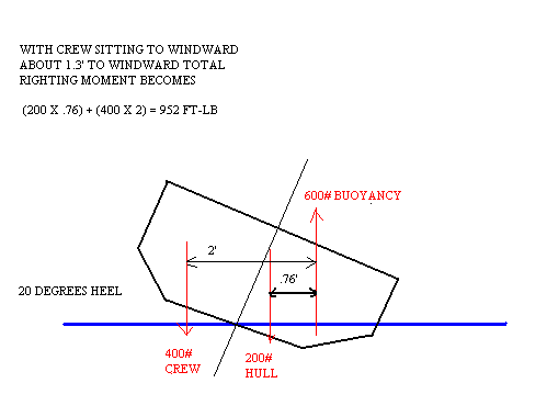

Now let's say you have an adventurous pal who wants to sail with you. He adds another 200 pounds to the effort like this:

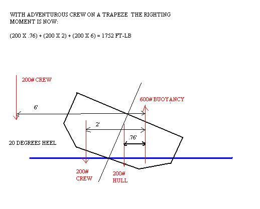

Now the righting moment is all the way up to 952 ft-lb. Sail load required to capsize the boat is now 952/9 = 106 lbs which is 106/74 = 1.4 psf for this 74 sq ft sail. That happens at about 17 knots. Now the wind is really starting to blow! Your adventurous pal says, "No problem." and grabs a rope leading to the masthead and steps out on the rail with a trapeze, like this:
Now we are really getting up there. Righting moment with the big guy on the trapeze is now 1752 ft-lb! That figures to be 195 lbs on the sail for an average sail pressure of 2.6 psf. That happens in a 22 knot wind.

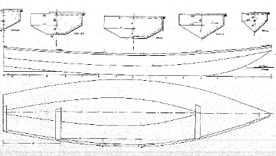

ORACLE, LIGHT ROWBOAT, 15-1/2' X 45" X 80 POUNDS

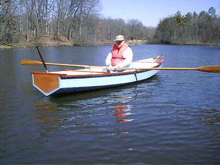

Oracle might have been called Roar3. It is a bit longer and lower than Roar2 so it looks sleeker. It is actually closer in shape to my Toto canoe. I'm pretty sure it is a visual improvement over Roar2. Hard to say if it is a practical improvement. Being lower sided it might seem less secure but then again my Roar2 has never taken water over the wale in the ten years I've had it and maybe I've been hauling around excess freeboard. Max Wawrzyniak of St. Louis made the prototype. We rowed our boats side by side on a good day recently. I'd say the Oracle was 1/2 mph faster all around going about 4 mph at cruise and 5+ mph on the gps at full effort. It should float two adults quite nicely.
I'd like to point something about the way I draw the line on many of my boats. I make card models of my designs which help me check the panel expansions and allow me to get a 3D check of the shape. The models are done in the same scale as the blueprint, in this case 1/8 and the model is fairly large. So I knew that Oracle has nice curves all around. But if you look at the end view in the lines drawing you see all straight lines! In a way this is a throwback to the original "instant" boats which had hull panels made from straight saw cuts. It is easy for a designer to make the jump to more flexible shapes, that is hull shapes which can look like about anything you might imagine being made from plywood. Back when I started drawing boats I noticed some of the nicest shapes in 3D had end views made totally of straight line segments. Don't ask me why. Not only does that give a nice shape, the designer's job is simplified. For example, with Oracle I might start by drawing the top view. Then I might sketch in the side view needing nothing more than an idea of what the stem, midsection, and stern will look like. Next I draw the end view which will include those elements connected by straight lines. In normal mechanical drawing it only takes two views to totally define an object. So without even drawing the side view of the boat the shape is defined. It only remains to go back and figure it out and adjust the top view, etc., etc.. Happy is the designer who gets it right the first time through.
Oracle is built with taped seams using four sheets of 1/4" plywood. No jigs, no lofting.
Oracle plans are $20 when ordered direct by mail from me.

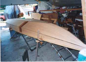

The Texas Ladybug is getting details (Toto in background):
