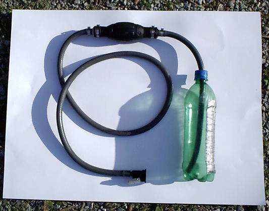

To do the tests in what I think is a halfway scientific way I made up a new "fuel system" with a clear plastic bottle. The bottle is a common soda bottle that you find everywhere. The bottle suits because the center 2/3's is a straight cylinder. This one measured 2.70" in diameter in the straight area. A US gallon is 231 cubic inches, so an ounce figures to be 1.80 cubic inches which would be .316" depth in the straight section of this bottle. I put a piece of tape along the length of that section and marked off 12 ounces. A standard fuel hose and primer bulb is inserted through a hole in the cap and a tiny vent hole is drilled there too. So if this tank is held vertical as the motor draws out fuel you can read pretty well the fuel use in ounces. I would say it is accurate to about a quarter ounce in real use. Smooth water is needed for testing since sloshing in the bottle makes for difficult reading.
The fuel use is timed with the common digital wrist watch set to the stop watch mode, very very accurate.
The speed of the boat is measured with a gps. I suppose the speed here is approximate since holding the boat to within 1/10 mph is difficult over the few minutes it takes to do each run although the gps seems to have no trouble measuring to that degree.
The boat used in all the tests was my AF4 at about 800 pounds total weight. In general this boat goes with little wake until about 6 mph which might be considered the "hull speed". I think it needs about 3 hp to go that fast. Then it starts to drag a big wave until it begins to plane fairly cleanly at 10mph. It needs about 7 or 8 hp to plane at 10mph. I think there is little future in trying to operate AF4 between 6 and 10 mph. So if you don't need to plane 5 hp will allow you to run at 6mph at a comfortable part throttle. And if you want to plane I think it takes 12hp to run it at comfortable part throttle at 12 mph. I think the best option for most would be about 15hp which would allow you the same cruise with another adult on board. Once you start to plane, weight counts for a lot. When my AF4 first was launched it was empty and stripped down at less than 500 pounds total, about 650 with me in it, and it went 17 mph with the Johnson 10. Now it is 150 pounds heavier and the same motor maxes out at 14 mph.
Tests were done like this. The motor to be tested was run a while on the regular tank to warm it up and get its fuel system full. The test tank was prepared and full beyond the 12 ounce marking. Once in the test area the motor was switched to the test tank and the primer bulb pumped hard. The primer bulb holds a large amount of fuel and you need to allow for it. The motor was run up to speed and when the fuel level in the tank had dropped to the 12 ounce mark the clock was started. After the motor had run 4 or 8 ounces, enough to get a valid time, the clock was stopped and the consumption for that run figured. I think the results are pretty accurate. The only problems were with occasional rough water that caused sloshing in the tank and oddly enough, difficulty with readings when the bottle was nearly empty. I think what was happening was that the motor begins to draw fuel out of the primer bulb and not out of the tank such that you motor on for a few minutes with no drop in the tank. So I stopped taking data if the tank dropped below 4 ounces.

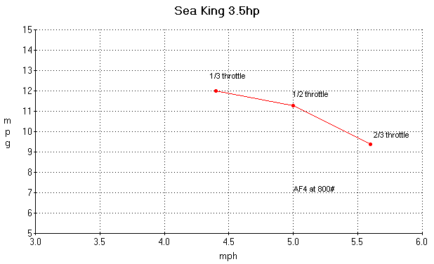

FIRST RUN, SEA KING 3.5...
An aircooled motor made by Clinton about 1970. Always thought it burned 1/2 gallons per hour at all speeds. Here are the results that about confirm that.

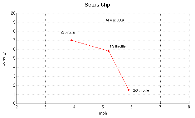

SECOND RUN, SEARS 5....
Also from about 1970. Made by Eska I'd say with a Tecumseh air cooled power head. Hard to start sometimes but once going has good power and uses little fuel.

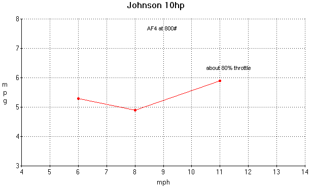

THIRD RUN, JOHNSON 10...
From about 1956. A modern motor with noise and vibration stoppers. Good running and good power but always thought it used a lot of fuel. The motor guru keeps telling me there is something wrong with it but won't tell me what it is.

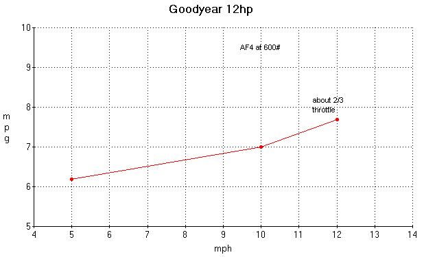

FOURTH RUN, GOODYEAR 12...
From 1956 or 1957. Made by Gale which was part of OMC so it is essentially a Johnson or Evenrude but it doesn't have the modern noise and vibration stoppers. Otherwise a very good running engine. I did not run a test at 8mph but I'll bet the fuel consumption would dip to its lowest there as it did for the Johnson10.

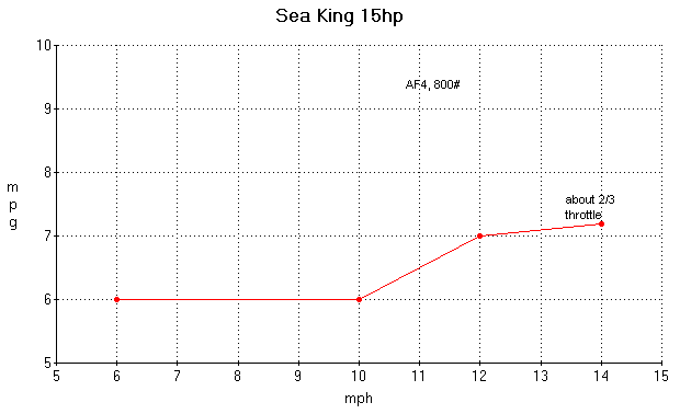

FIFTH RUN, SEA KING 15...
From about 1960, sold by Montgomery Wards but made by Gale which was part of OMC. Very modern with full noise and vibration stoppers. Again, no test at 8mph but I'll bet the fuel consumption would dip to its lowest there.

With the smaller motors the Sears is noticably the better of the two, especially considering it has a lot more power than the Sea King. The Sea King starts easier, an important factor with a motor that is supposed to be a back up. Remember, AF4 won't plane with these motors.
The results with the larger motors are interesting. I did not show it but when I ran these motors at idle in neutral they all burned about 6/10 gallons per hour sitting still. There is no point in slowing down your boat to get better fuel milage with any of these. The faster they go, the better the fuel milage. I did no runs at full throttle but I would expect the miles per gallon would be the best at full throttle! On the other hand the consumption is actually fairly constant and from a fuel planning point of view speed really doesn't matter much (as long as the motor is in gear). As expected the Johnson 10 is the worst although I think that may be just a quirk of this particular motor. The results of the 12 and 15 are pretty consistant.

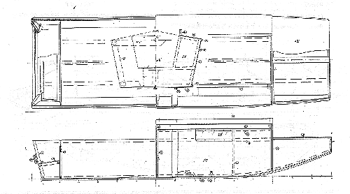

CAMPJON, CUDDY JONBOAT, 15.5' X 5', 300 POUNDS EMPTY
Campjon is based on my Jonsboat design. I increased the hull depth to 24" from 18" and again to 30" in the region of the 6' long cuddy cabin. The cabin decks slope upward towards the center so the "headroom" in the middle is about 3', usually that is enough to allow sitting up while seated on the floor. There is a slotted walkway on the cabin centerline just like I've used on my AF sharpies, but this one also has a step through to the front deck. The front deck itself is fairly large and easier to use as a boarding platform than with the AF sharpies. But it is very important to NEVER let anyone ride on a front deck like this when the boat is in motion. If they slip off the deck they have no option but to slide under the boat full length and through the prop in an instant.

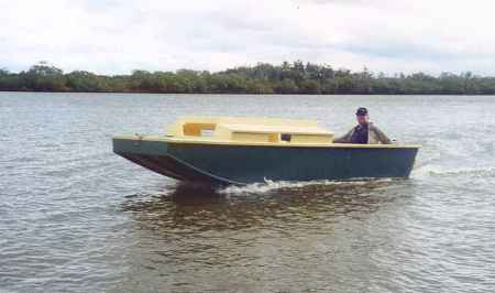

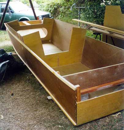

The prototype Campjon was built by Luke Spreadborough in Queensland Australia. Here he is using a 2.5hp motor.

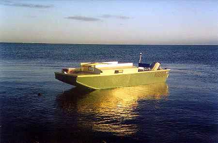

He now uses an Evinrude18 as shown in this newer photo and like the guru has become something of a collector of old motors and now they show up like orphans on his doorstep.
I doubt if the increased freeboard makes the boat any safer since a flat boat like this is not good in rough water in any case. The higher sides do give a feeling of greater security since this will be a boat you are "in" instead of "on". This would be a better family boat since the kids can be kept cornered in the cuddy while underway. They can stand in the slot, or look out the front or out the windows. I suspect the cuddy will find a lot more use as a spot for the portapotti than as a camping cabin. The cockpit as drawn has no seats and is itself a big playpen. For seating I suggest using common folding chairs like I have used with satisfaction on my AF4. When the boat is not underway the chairs are folded and stowed, or relocated to another part of the boat or the shore.
As for power I would suggest a good 15 hp motor or a 10hp to keep the capability of using the smaller lakes which are wisely limited to 10 hp. With 10hp and with two normal sized adults the boat should plane, and be very lively with one aboard. But I've noticed with my own AF4 that weight gets added as time goes by and I've noticed that folks usually build their boats heavier than I do. I should add that the Coast Guard has suggestions about powering small boats and they come down hard on flat bottomed hard chine boats like jonboats because of handling concerns. I think they would advise a max of 25 hp in a hull like this. (My AF4, which is about the same weight as Campjon, went 22mph with a 40 year old Johnson 18. Greg Rinaca's Jonsboat went 26mph with 18hp.) There is a draining motor well in the stern.
Constuction is nail and glue, with no jigs or lofting. From four sheets of 1/4" plywood, two sheets of 3/8" plywood, and two sheets of 1/2" plywood.
