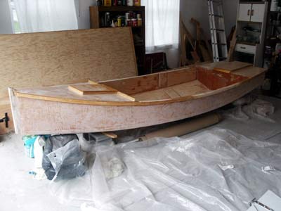

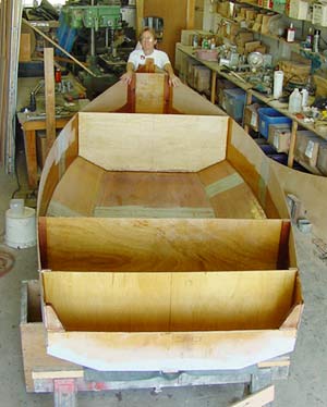

Shapely Mixer going together in Jack Clayton's living room.

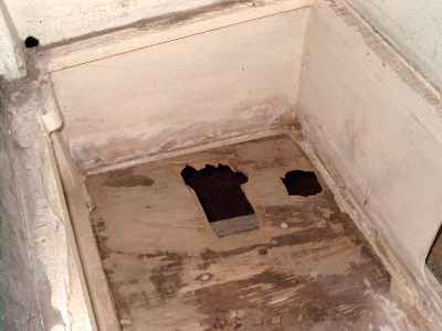

I let it dry for a week and then scraped and chipped away at it until the punky wood was gone. Let it dry some more. Here is what I had left:
Note the big holes. The starboard side of the boat was quite similar. So there were fairly large areas where the wood remaining was maybe 1/8" thick and then there were the holes. What to do?

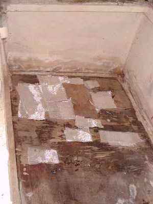

First I backed the holes from the outside with plywood surfaced with slippery plastic sheet. It was pretty easily done since the trailer bunks ran right under the larger holes and I was able to pinch the backup plywood between hull bottom and trailer bunk. Then to secure the outer edge of the backup ply I simply clamped it to the external chine log. I decided to fill the large holes with pieces of plywood and fill the eroded areas with pieces of fiberglass dry fitted for now like this:

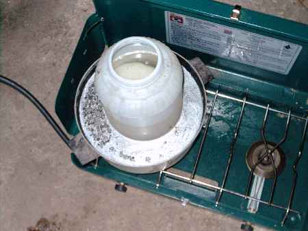

I had almost a gallon of epoxy on hand but it had set up, crystalized, in the jar! I had purchased it from Wicks Aircraft Supply about 20 miles from here about a year ago and it had set to apple sauce consistancy almost immediately even during the hot summer. It set rock hard over the winter. I went to Wicks to complain and raise hell about it. The man looked at it and said that was common, almost normal. He said it would return to liquid if heated. Had I tried heating it? Yes I had to no effect. He asked did I get it REALLY HOT! No, I hadn't. He said he would not replace it. That epoxy drums sometimes came right from the factory that way. Once heated to liquid again it would be like new, he said. I went away mad!
When I got home I got out my camp stove and a big old pot that my wife had condemn after I had boiled some homebrew in it. Filled pot about half full, placed the hardened epoxy jar inside with a piece of wood between jar bottom and pot to prevent melting of plastic jar. Set to boil. Ever so slowly it changed from like hard candy to apple sauce and then to pure honey, just as the Wicks man said it would. It took an hour on the boil. That was two months ago and it is still like pure honey. Here is a photo of the job, you can see it is turning liquid around the edges with an iceberg of solid resin in the center:

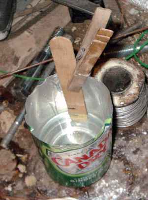

While I'm at it I want to mention how I mix epoxy. I stopped using pumps a long time ago finding they would shoot air at the worst time. Now I take a straight sided can like a soda can with the top cut off. Then I mark a mixing stick with two marks in the mixing ratio for the epoxy hardener. This hardener was 50% by volume to the resin. So I mark my stick at say 1" from the stick's end and another mark at .5" beyond that, or 1.5" from the end. Then the stick is placed into the can with end touching bottom and held there with a spring clothes pin. I fill to the 1" mark with resin, then add hardener to the 1.5" mark so the hardener volume is 50% of the resin. You can mix more or less but the ratio of the marks on the stick must be the same. Then mix. Here is what it looks like with the resin already poured in and waiting for the hardener to be added to the next mark, and take note that this job cannot be done on a clean bench:

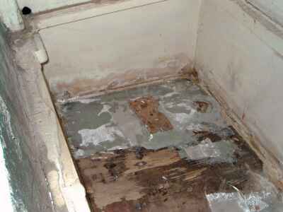

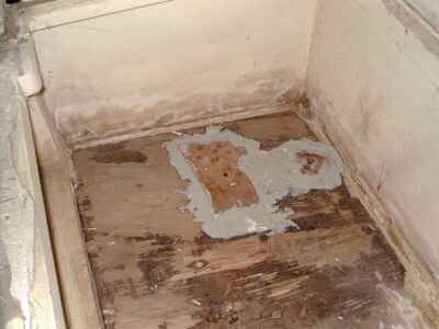

So the repair begain like this with some plywood chunks to fill the big holes and some epoxy paste (remember there is a plastic covered backup under all of this so the epoxy can't run out) like this:
Then I started adding in the glass pieces pasting them down with more thickened epoxy like this:
I kept pouring on the thick epoxy mix (I mix about 6 ounces at a time and thickened after mixing resin with hardener. You can't do this with fast setting epoxy since the whole operation took over an hour and the idea is to pour it all at once so it sets as one big blob.) I filled it, hopefully overfilled it a little bit, right to the top surface of the original plywood, like this:

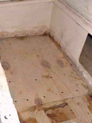

Then I capped it with a plate of 3/8" plywood (cut to shape before doing any of the epoxy work and set aside). There were two plywood plates that would fill in the entire aft bottom bay. There was enough good wood left in the bottom and especially in the bottom skids that I could run screws through the repair plywood to clamp. Like this:
Next I filleted around the repair doubler and secured the perimeter with two layers of fiberglass tape, sort of a taped seam repair. Like this:

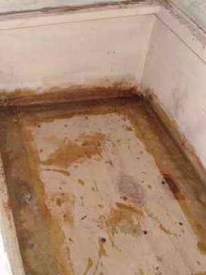

Both sides of the stern were repaired this way at the same time. When the epoxy had cured I gave it a brief sanding with a coarse disk mounted in a drill to remove any glass spikes, and I painted it.
I had decided to avoid trapping water in the stern as before. I added two large access holes to the aft bulkhead to provide a lot of ventilation and allow me to see and clean all the way to the stern's nooks and crannies.

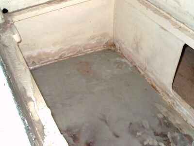

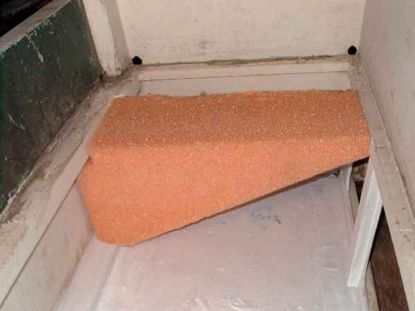

Now, what to do about that flotation foam? I cut some foam blocks to fit tightly under the aft deck, wedge shaped, such that they don't contact the boat's bottom at all. Like this:
I've only shown one section but more were cut and placed so that they extended all the way across the back under the deck. I also wrapped them in plastic so they wouldn't fill the boat with orange crumbs.

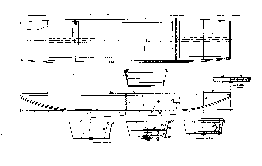

POLEPUNT, PUNT, 15' X 3', 110 POUNDS EMPTY
Do you have a swamp in your back yard? Turn that into a positive thing with a tradional punt that you push through the shallow water with a pole. I think this sort of boat has a long history and the similar shape in Chapelle's great book AMERICAN SMALL SAILING CRAFT goes back to at least the 1700's. Those weren't built of plywood, of course, and would be a lot heavier than this one. Actually Chapelle shows the shape of the old one as more elaborate than this one but I'm pretty sure this one is in no way harmed in function by the simplicity of its shape.
In particular I drew in a feature that I saw on a commercial aluminum jonboat. That is a constant width bottom. I used that feature on my Jonsboat design and it works very well. It might make the boat easier to build although something like Polepunt is easy to do in almost any case. I kept the bottom dead flat in the center 7' with no frames there so that you might walk the center as you push the pole. The boat is narrow at 30" inside on the bottom and I'm hoping that will make it stable enough to stand in. But such a light boat will be dominated by your weight and you will need to be careful how you stand. I've also shown rowlock sockets on the drawing and this might suit as a rowing boat using a removable seat. And this might be very suitable for floating streams with paddles, a substitute for an aluminum canoe. I see no good way to use a motor on a boat like this. The ends (which are identical) are swept way upward for good lines at slow speed and won't support any weight fore and aft. The only chance for a motor would be with an electric with remote steering so yo can keep your weight forward for proper trim. I've written words like that for almost all my arm powered boats and I still get regular photos of those boats with motor plates mounted on the stern. But I never get photos of those boats under power most likely because the owner tried it just once and never again after it tried to stand on its stern when the motor was fired up. So if you want power, and there is nothing wrong with that, build Jonsboat instead.
Nail and glue construction from four sheets of 1/4" plywood.
Prototype plans for Polepunt are $15 until one is built and tested.
