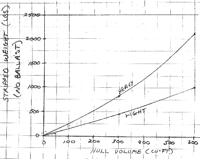

When I started drawing boats about 10 years ago I saw a need to estimate the weight of new designs using typical plywood construction and wondered if there might be such a thing as "boat baloney"? I came up with the following chart:
I'm afraid the method does not work so well with boats because boats aren't usually jammed full of stuff - there is lots of empty volume. And because boat hulls are built in entirely different ways by different people, even when they use the same set of plans. To illustrate that I'll recall the time I took my old Gloucester Gull dory, the Payson/Bolger boat, out rowing with Dan Knodler who also has a version of the same design. Mine was made of 1/4" plywood with taped seams and totally stripped out. It weighed 65 pounds. Dan's was built by a pro from 1/2" plywood with hardwood seats and gingerbread and weighed about 150 pounds. I think Payson said one built right to the plans as he made them weighed about 100 pounds.
Looking at the above chart it seems that empty hull baloney has a density of about 1.5 pounds per cubic foot if lightly constructed to about 3 pounds per cubic foot if heavily constructed. Remember this is just for empty plywood hull structural weight. I would say "lightly constructed" would mean a simple undecked boat like a canoe or rowboat that borders on flimsy. "Heavily constructed" would mean a more complex decked hull with some beef to it. Actually you could make a case that heavy could be heavier than I am showing.
Let's use this issue's feature boat, the Dorado, as an example of using the chart. This boat is 5' wide, 19' long, with a cuddy cabin 3' high. It's total volume is about 250 cubic feet. If we use an average boat baloney denisity of 2.25 pounds per cubic foot as suggested by the chart we would expect the empty hull to weigh about 560 pounds. Not much to figuring that!

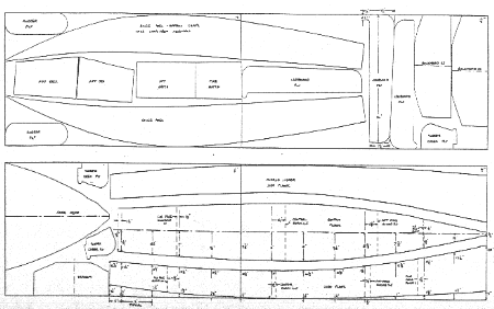

Payson and Bolger didn't invent the plywood panel layout but they popularized it and made it a key element of instant boats. All the plywood parts of the boat are laid out in scale on standard 4' x 8' sheets of plywood on a drawing. The layout is supposed to be a guide to the economical use of the plywood. It doesn't adapt too well to the traditional cut-to-fit style of building. I see in a recent Boatbuilder magazine where Thomas Firth Jones built a Payson/Bolger catboat by traditional methods instead of the taped seam instant method shown on the drawings. He kidded Bolger and company about spending the time to lay out all the parts. But the layout is an important material and labor saver to someone building instant style.
Once you lay out all the parts you can determine how much plywood you will be using. And if you know how much plywood you are using, you know how much the pile of plywood weighs. And since an instant boat is mostly plywood, you get an excellent idea of how much the hull and plywood parts will weigh. Then you can update your idea about the density of boat baloney.
Here is the plywood panel layout for my design Mixer. All the hull parts including the leeboard, and rudder parts are there on four sheets of 1/4" plywood:
Wood density varies quite a bit. But a 1/4" sheet of plywood usually weighs about 25 pounds, a 3/8" sheet about 37 pounds, and a 1/2' sheet about 50 pounds.
"But," you say, "there is more wood in the boat than just the plywood. There is the framing wood too." That is true. But then again not all the plywood gets used. Here is a general rule that I use with plywood boats with nail and glue joints that require stick framing and conventional chine logs - allow about 30 pounds per sheet of 1/4" plywood, 45 pounds per sheet of 3/8' plywood, 60 pounds per sheet of 1/2" plywood, etc. Taped seamed boats are lighter than framed boats and can indeed be estimated fairly well using just the weights of the plywood sheets. I think about the only warning I might give when using this method of estimating the weight of a new design is that often the ply panel layout also contains temporary forms that won't be permanently in the hull. Those areas should be excluded from the total. So when I look at the plywood panel layout of Mixer shown above, I think instantly, "No more than 100 pounds in four sheets of 1/4" plywood and taped seams. In fact with the sail rig and hatches stripped off for cartopping it might be around 80 pounds." I don't remember if David Boston who built the first one weighed her.
By the way encapsuating a boat like Mixer will increase its weight. The numbers I mention above would include minimal paint but not epoxy coating. So you might add maybe 10 pounds per gallon used.
Now let's use this issue's featured boat Dorado as an example of getting a close weight estimate of hull weight by using the ply panel layout. When I lay out all of Dorado's parts I find it needs about eight sheets of 3/8" plywood and two sheets of 1/2" plywood. So a guess at the hull weight, more refined than the baloney weight, would be eight times 37 pounds for the 3/8" sheets and two time 50 for the 1/2" sheets. That totals 400 pounds. When I wrote up the catalog blurb below for Dorado I said 500 pounds thinking of her framing, a glass coating and some motorboat parts that the sailers won't have. But I could be wrong. The original 560 pounds estimate using the baloney theory seems as good as anything.

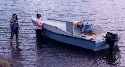

Dorado
DORADO, POWER CUDDY SKIFF, 18' X 5.5', 650 POUNDS EMPTY

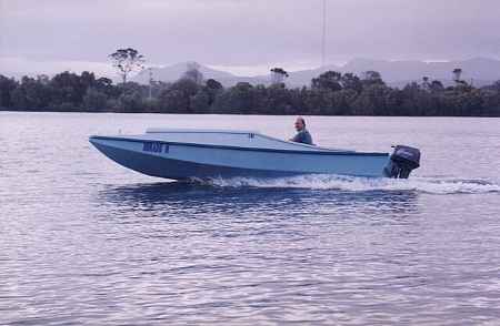

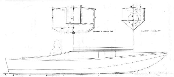

Dorado is a Southern Hemisphere constellation and also this boat designed for Ashley Cook in New South Wales. The idea behind it was for a rough water power boat with a sleepable cuddy cabin. We started with my Frolic2 sailboat (which itself evolved from the Toto canoe) and straightened out the stern lines to adapt it for planing power. After mocking it up Ashley said he and family needed another 3" of headroom so Dorado B was born and built. The plans show it both ways. I should add that even though Dorado started out as a modified sailing hull, it probably would be a terrible sailer just as Frolic2 would be a terrible power boat on plane. The two worlds just don't mix and the idea of "just hoisting a simple sail" on Dorado is bound to be a sure loser both because it will sail poorly and because you will lose the simplicity of a straight power boat. Not that the idea isn't worth more study. It would take a special person to do all the tweaking involved with making the two-way boat work well.

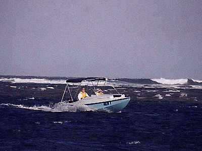

The shape works! Ashley has been running DoradoB into the rough stuff. In the above photo he is off the east coast of Australia with nothing but ocean between him and New Zealand. He says the big curling wave to his side is a permanent fixture and fatal to boaters trying it. He is using a new 30 hp two stroke motor which still is in its break in period. The Coast Guard would say that is the max for this hull. With the 30 Ashley reports cruising at about 20 mph with two adults on board. As an aside I should mention that in boats like this one needs to pay attention to the prop specs to prevent the motor from going over redline at full throttle. If the usual prop is for a heavier and slower boat then I would expect the motor to rev too high at full throttle in a lighter faster boat. The idea is to select a prop with a pitch that will put the tach on the red line at full throttle.
The hull is made with taped seams needing two sheets of 1/2" plywood and eight sheets of 3/8" plywood, a total of about 400 pounds of wood. I would expect the stripped hull to weigh about 500 pounds with framing and fiberglass. I would add at least 150 pounds to that for a motor and its gear which is why I estimate the empty weight to be about 650 pounds. Add two adults and fuel and now you are around 1100 pounds total. The old rule for motors on planing powerboats is a horse for each 50 pounds so if you havea 25 horse motor you will be able to cruise this boat at 2/3 throttle. I would say 15 hp is the minimum you might use and expect to plane, even then you must stay very light and run near full throttle.
