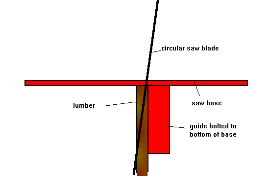

Actually scarf joints are easy except for cutting the scarf angle. There are fixtures made for circular saws that cut a scarf automatically like this:
Pro builders use these to cut scarfs on plywood, but the plywood has to be thin. The usual circular saw protrudes about 3" maximum below the guide, so if you are scarfing at an 8:1 ratio, the thickest wood you can cut this way is 3/8". Still, for a pro scarfing plywood it is very useful. But useless for scarfing 3/4" lumber.

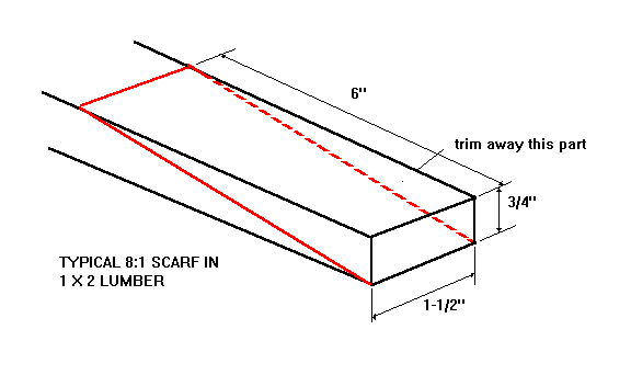

Let's say you need to join 3/4" x 1-1/2" lumber to make wales or chine logs for your boat. An 8:1 scarf in 3/4" thick lumber will be 6" long, like this:

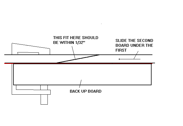

It's easy to draw the cut on the end of your sticks. You can try cutting it with a really good handsaw. It pays to practice. I've been able to cut the stick with a really good saber saw or circular saw but the guide has to be set exactly at 90 degrees and you can't waver in your cut. If you get a bad cut, you can try again on the same end. In fact if pays here to start with extra lengths of lumber so you can try several cuts on each board until you get the knack. You can also try working the cut to shape with a plane or rasp. If you have a power plane, you might try whacking the scarf to shape with only that. When you think you have two good ends cut, clamp one against a firm surface such as a length of 2x4, like this:
Slide the mating piece into position and check the fit. Remember that as you glue these up they must be straight. I think they should fit within about 1/32" to make a good glue joint with thickened epoxy. Like this:

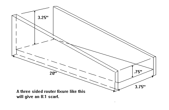

When I built a Birdwatcher a while back I needed to join a lot of lumber since the boat was 24' long and the mast longer. I built a simple fixture for my router for cutting the scarfs. It looks like this:
The base plate of the router needs to be removed (three screws) and replaced with a one wide enough to span the fixture opening in all positions. The fixture needed to be wide enough to scarf the 3" wide boards I was using for the mast.

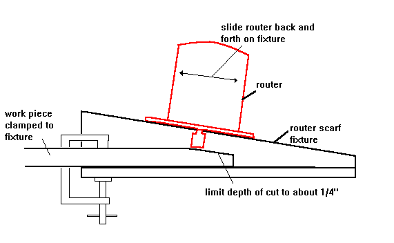

Here is how I make a scarf cut with this fixture. The board is clamped into the fixture such that the router will cut no more than about 1/4" deep. The router is turned on and worked around the fixture until it has cut all the available material. Like this:

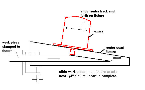

Then the board is unclamped and slid forward into the fixture such that once more the router will slice off another 1/4" of material, only this time there will be a lot more wood to cut. And so forth until the the entire scarf is cut. Or is it? I've found it best to avoid a total feather edge at the end of the scarf cut - leaving about 1/32" uncut seems ot work best, like this:
That's all there is to it. One of the nice things about this fixture is that it is pretty compact. So instead of moving those long boards to the fixture, it is usually a lot easier to move the fixture to the boards, a nice feature when you start working with really long boards.

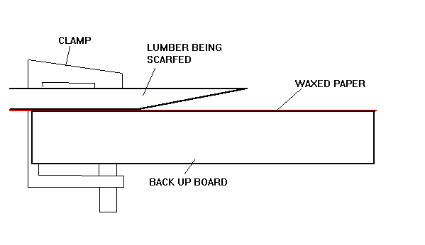

Now it is time to glue the boards together. Best to glue them up on a piece of 2x4 such that they will be straight as you glue them. Cover the 2x4 with waxed paper so that the backup board doesn't become a permanent part of your boat! Clamp the first board on like this:

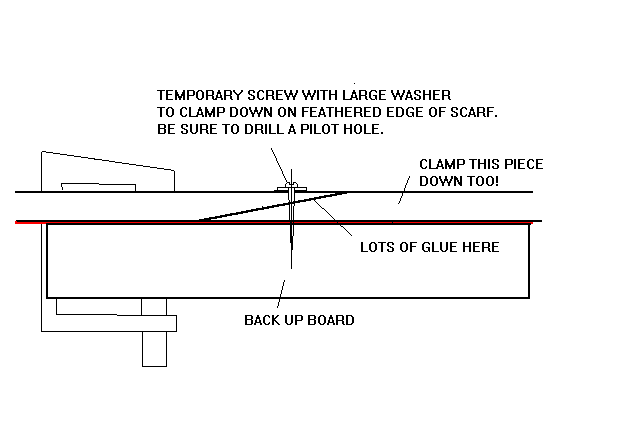

Trial fit the second board. Butter it well with epoxy thickened to about mayonaise consistancy. Push it into place but not so hard that all the glue squeezes out. Now clamp the second piece to the backup 2x4. If you are going to have problems with gluing the joint I think it will be with glue squeezing out too much and also with lifting of the first board at the feather end of its scarf. You can help that out by carefully drilling a pilot hole for a screw right through the scarf and carefully installing a temporary screw with a backing washer like this:
That temporary screw will help a lot for overall alignment while the glue sets. It's a fact that glue is very slippery until it sets up and tapered clamped joints like this can slowly slide apart without really good clamping.

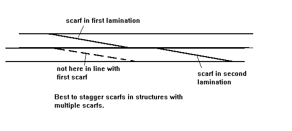

Once your glue is completely cured the joint should be as strong as the basic wood and you can go on building as if there were no joint there. But it doesn't hurt to be prudent. I try to locate the scarfs in wales and chine logs where the curvature will be the least. I try to locate the scarfs in masts towards the top, where the bending loads are the least. And on elements that have several boards with scarfs, such as wales with multiple laminations and boxed masts, I stagger the scarfs such that they are not all one atop the other.

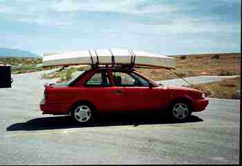

After the success Frank Kahr had with Robote I designed a smaller version with most of the same features. The idea was to get a fast and seaworthy boat that would cartop so easily that you would want to leave it on the car top more or less all the time, ready to go at a moment's notice. From cartopping smaller boats like Toto I had found that they hardly slow the car down or keep a compact car from getting 30+ miles per gallon on the highway. I thought the trick was to keep the boat small enough that complicated tie downs were not required. I also knew that Piccup, at about 90 pounds, is about the most a fellow would want to cartop. Lighter is better, of course, but once the weight gets below 70 pounds the boat becomes so easy to load that getting it super light is not mandatory. The prototype Vamp that you see here was built by Ken Prims of Layton, Utah. Here is his boat atop his compact car, a very nice package as I had hoped.

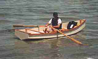

HC Skiff: One of these has been completed and sailed in Massachusetts. Here is one of the first photos - very pretty boat, I think. The builder has gotten many great comments from other boaters and it occurred to me that this boat was called the "Oystering Skiff, Cape Cod, taken off at Orleans (Massachusetts), Aug 7, 1933" in Howard Chapelle's great book American Small Sailing Craft, where I got the lines. So this is sort of a retro photo with classic boat in its classic Massachusetts setting.
