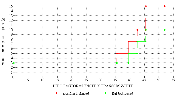

The pamplet next has several catagories of hulls and ways to figure safe power for each. I'm going to try to present the info as two charts, one for smaller boats and one for larger. Here we go...
This is the chart for smaller boats with the factor of 52 and below. To put this in perspective, My Jon Jr design with length of 12' and width of 3' would have a factor of 36 and be limited to 3hp on this chart. (I think the photo below shows it with 4hp.)
The Coast Guard comes down pretty hard on flat bottomed hard chined boats as you see. To quote the pamplet, "Why? Because with a hard chine and a flat bottom you must turn more slowly to maintain stability." OK, I'll buy that while at the same time pointing out that the same flat bottomed hard chined boats with inboard power would have no limit to power by the same pamplet.

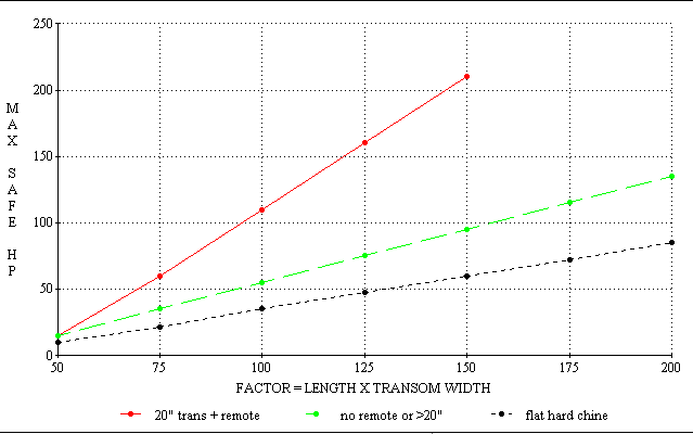

Next I'll try to conjure up the chart for boats with factors above 52.
Here we have three selections. The red solid line is "FOR OUTBOARDS WITH REMOTE STEERING AND A TRANSOM HEIGHT OF AT LEAST 20 INCHES". I've limited the factor to 200 which would be a pretty large boat, 25' x 8' for example. But in the pamplet there is no limit to the factor so to power an even larger boat you could extend the straight line as far as needed with the same slope.
The green dashed line is "FOR OUTBOARDS THAT DO NOT HAVE REMOTE STEERING OR TRANSOM HEIGHT IS LESS THAN 20 INCHES".
The black dotted line is "FOR FLAT-BOTTOMED, HARD-CHINED OUTBOARDS THAT DO NOT HAVE REMOTE STEERNG OR TRANSOM HEIGHT IS LESS THAN 20 INCHES".

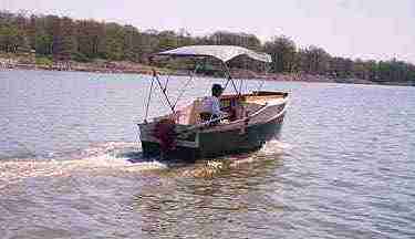

OK, the obvious question is what about flat bottomed boats with remote steering and 20" transoms? I'm pretty sure the writers didn't mean to place them in the high powered catagory. For example my stock AF4 has a 15" transom with 18' length and 4.5' transom width for a factor of 81. By the third line it would have a max safe hp of 25, and having used AF4 I would agree with that. Here is mine planing at about 12 mph with a 10 hp motor at about 3/4 throttle.
But if I raise the transom to 20" with a long shaft motor and add remote steering do I now jump to the red line and go to 72 hp?? If the problem with the flattie is handling in turns I don't see how the deeper transom or the remote steering makes it safer for triple the power. (No doubt it would be safer though). But a literal reading of the pamplet makes it appear that way.

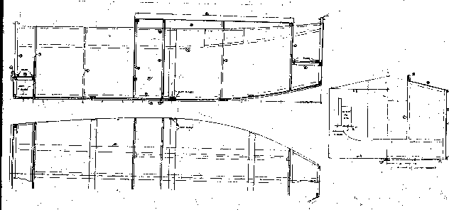

SOW'S EAR, CUDDY POWERBOAT, 15,5' X 6', 600 POUNDS EMPTY
Sow's Ear is somewhere between a shantyboat like my Shanteuse and a cuddy power skiff like AF4. It has a lot more room in the cabin than does AF4 but a lot less than Shanteuse. And it has an open cockpit that will seat two or three adults in comfort unlike Shanteuse. Sow's Ear should be a bit more seaworthy than Shanteuse but keep in mind that no light and small flat bottomed boat is going to be seaworthy to any real degree. And it looks a bit more like a boat than does Shanteuse. As for looks, it follows closely on the heels of Bolger's Micro where the looks are the result of high volume and ease of building. Sow's ear will be a lot easier to build than Micro because powerboats have a lot fewer parts than do sailboats (assuming you are not going to build your own motor).
And using a powerboat is a lot easier than using a sailboat, assuming you have a motor that is reliable. I think the irony of most modern sailboats is that no one will use one without a reliable motor, so they are really motor sailers. There is no question that a good motor makes the whole sailing operation in boats too large to manhandle a lot easier while you still have the option of smooth and quiet sailing. The cost involved is that the sail rig of any boat usually doubles the labor and materials needed and the setup time at the waterfront of the trailer sailer is often an hour instead of five minutes. So you see the advantages of a straight powerboat. I tried hard to make this one very easy to use, especially for a typical family. It will float in about 3" of water so launching and beaching is a breeze. The bow has a step through transom and you will need to step up 20" to get aboard and into the cabin, easy enough for a child or anyone with both hands full of gear. The main cabin room is 6.5' long and 6' wide and will sleep two adults. Atop the cabin is a slot top full length which you can cover with simple fabric. Behind that room is a storage/utiltiy area where you can store al of your gear and clothes, cook and keep a portable toilet. Aft of that is the cockpit, 5' long and 6' wide, large enough for lounging in a beach chair or keeping a short stack of those plastic lawn chairs. The sides are deep and secure for children. And in the stern is a full width self draining motor well. To steer the boat you will need to stand or sit on a tall chair to see over the cabin. Remote motor controls will be best but a long tiller extension to the motor will work well too. That is what I use with my AF4.
The Coast Guard would advise no more than 25 hp on Sow's Ear, based on length, width, and the fact that it has a hard chine. It would take that much power to plane the boat at 2/3 throttle with some adults aboard, weight being all important. But this boat won't do well in big open waters that can get rough. It will do very well with say 5 hp in protected smaller waters where planing and distance covered are not important.
Construction is simple nail and glue. Sow's Ear needs seven sheets of 1/4" plywood and four sheets of 1/2" plywood. That is more than the longer AF4 but this boat has a lot more interior volume.
