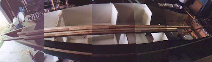

A Scram Pram project in Odessa, NY, is looking for a good home. I think the hull structure is about complete. Contact Allen Krayniak at alkrayniak@yahoo.com.

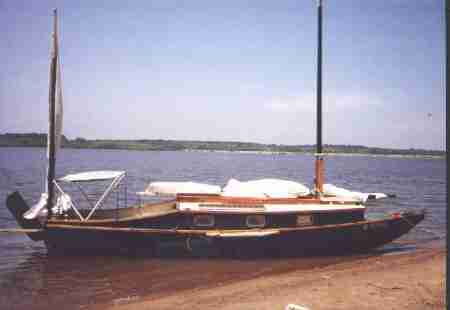

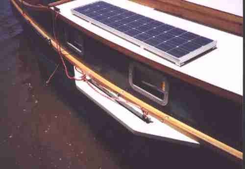

I took this picture to point out three features of Chuck's boat.
First, you can see here the upper leeboard guard. The guard braces the leeboard to take loads in both tacks and only one leeboard is used. The leeboard pivots on a bolt near the waterline. The leeboard is under the upper guard with a small eye protruding through the slot. A lanyard is tied to the eye so you can pull it down. Once down there leeboards like to stay down until they hit something, then they will pop up and you must pull them down again. Chuck's set up has a shock cord that will pull the board down and so it can rub the lake bottom but it will release when the leeboard meets a serious obstacle. allowing the leeboard to retract all the way.
Second, you can see Chuck's custom port window. He made patterns for the frames and had them cast at a foundry in aluminum. They have screens on the outside and a matching watertight frame hinged on the inside with lexan on the inside. You would have no idea they are homemade and you need to bug him about putting up the details on his Duckworksmagazine website.
Third, you see his solar array for charging the two 12V batteries he keeps under the aft deck. I think he said it puts out 50 watts, about 4 amps of charge to the batteries in good conditions. He says it is plenty to keep his batteries charged and he has needed no other charging. He has lights inside and out but also has a 120VAC inverter for powering conviences like a shaver or food blender. All very civilized!

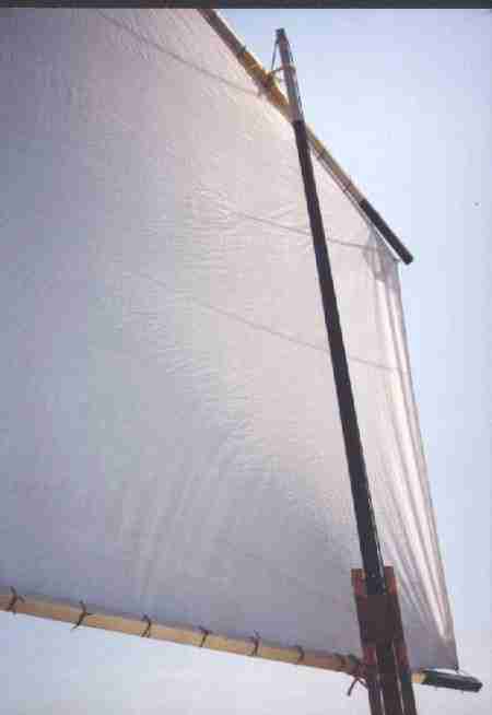

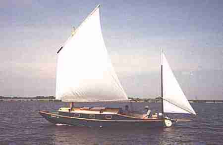

The sail you see is polytarp made from one of David Grey's Polysail kits. It was made by Sandra Leinweber who has written an essay about the subject posted at Duckworksmagazine. It is a blend of Grey's technology in that it uses a rope around its edge with taped edges. The tapes are sewn down as Grey advises (don't trust the adhesive very long). But it has the radial shaping darts that I've been touting. Chuck figured out the dart size using the essay I wrote about the subject a while ago. You can see the small dart near the sail's throat. There is a much larger one near the tack. The darts are sewn in place.
Normally I don't advise polytarp sails for boats that weigh more than about 500 pounds loaded and Caprice is way heavier than that. It will be interesting to see how it holds up! As for the shape, Chuck told me it sets perfectly no matter what he does to it.

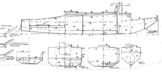

Twang

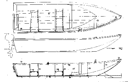

TWANG, POWER SKIFF, 13' X 4', 100 POUNDS EMPTY
Twang is a small light power skiff, light enough to cartop if you keep your mind on weight as you build and if you can figure out a way to carry your motor and fuel in your car. It would also suit well the needs of someone who wants to carry his boat in the back of a pickup truck. She is 13' long, 4' wide, and I'm thinking about 100 pounds stripped.
I've never seen a hull shaped like this before. Look closely at the lines and see that the bottom is dead flat lengthwise for the last 10', and also flat across for the last 7'. That gives the boat good capacity and I'm thinking the ability to plane with a small motor, say 5 hp with a light skipper. So that much is about the same as with my little JonJr. design. But the bow here is pointed and designed to meet a wave with a deep V shape and hopefully be softer riding than a jonboat or flat iron skiff. There is bound to be turbulence where the deep V meets the flat bottom but I'm hoping it won't be a factor on plane since only the aft half of the hull will be in the water then. I could be wrong and we might find out why I've never seen a hull like this. I'm quite certain it is impossible to come up with a new idea about hull shaping because everything has been tried in the past by good people. But new materials and techniques come along so that ideas that didn't work a generation ago might now be valid.
The hull is made with four sheets of 1/4" plywood and I think it will be easily made. The sides and bottom will be a piece of cake. The deep V bow is made from two simple pieces of plywood taped in place. I tried this design first by warping the bottom into the shape of the deep V and got the shape I wanted on the model, but felt quite certain that the amount of plywood torture needed would not please many. As is, there is almost no twisting in the panels. If this little design works I would waste no time trying it at 16' x 5' with heavier plywood. By the way, trying thicker plywood on a design with lots of twisted panels can be impossible. Even going from 1/4" plywood to 3/8" about triples the force needed to twist the panel into shape.
In my opinion these little boats aren't safe with big motors. I'm suggesting 5 hp. They also do quite well with small motors, say 2 hp. The low powered boat would be faster if the stern were swept up to meet the waterline and didn't drag the stern through the water, but only if the skipper sat well forward so that the boat really trimmed that way. Here is what really happens when someone puts a motor on a good rowing boat - one that has the swept up stern. No one ever puts controls on the boat that allow the skipper to sit forward for proper trim. The boat sits very badly trimmed down by the stern to the point where the skipper can hardly see over the bow. And when the power is applied the situation is a lot worse. So if you plan at all to use a motor, build a power boat like Twang and not a rowing boat. If you plan to never use a motor build a good rowing boat. Oars and motors don't mix well at all. Good rowboats never power well and good power boats never row well. In small boats at least, I know of no successful row/power boat. Remember that arm power might be 1/10 of a horsepower, and the smallest motors are ten or twenty times that.
Plans for Twang are still $15 until one is built and tested.
