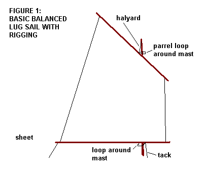

To review a bit, this sail is "balanced" a bit around the mast, the best place to fasten the halyard to the yard is about 40% aft of the luff. Further forward and the sail will twist a lot and lose the ability to point well into the wind. Properly set up these sails will tack through about 100 degrees, very good for such low tech. The yard needs to be fastened loosely to the mast at the halyard with a parrel loop of some sort to keep it located especially in rough water. There are lots of ways to do that and rigging a balanced lug was covered in detail in another issue of this site. Down at the boom is a tack line set about 15% aft of the luff, although this is not as critical as the halyard location. Again, the tack line needs a parrel loop of some sort to keep the boom from moving in rough water. The tack needs to be set VERY tight, thus putting great tension in the luff. Without that tension the sail will twist when sailed to windward with great loses. (In fact since the tack is so short and easy to get at I always make it at least a two to one tackle. A simple effective set up is a line running from the hull, over the boom, and back to the hull to a cam cleat. A quick yank at the cam cleat will retension the rig in an instant in a two to one effort.) Lastly there is the sheet, the location of which is usually not critical at all. When sailing the balanced lug, the sail is left standing from tack to tack. One tack will result with the sail draping over the mast but the effect is not noticable no matter how bad it looks. The sail is usually very gentle in a jibe.

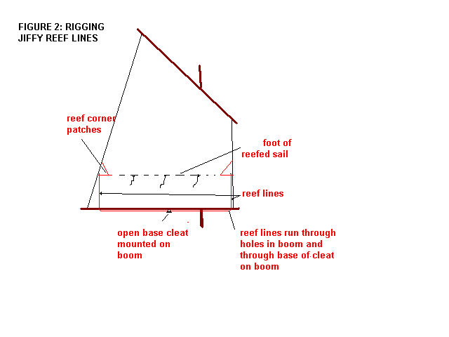

Here is how the reef lines are run:
There is a reef line tied permanently to each corner patch of the new reef foot. Those lines run down through faired holes drilled in the boom end, then they run to an open based cleat near the center of the boom. In practice those two reef lines can really be just one continuous line running from one reef corner, through the boom, through the base of the cleat, throught the other hole and one to the other reef corner.
The location of the holes in the boom is fairly critical. They must be placed such that when the reef lines are pulled tight and cleated, the corners of the reefed sail are pulled down and slightly outward to stretch the foot of the sail just the right amount. Expect to experiment. Since lug sails usually taper a bit, the reef line holes tend to fall slightly inside the unreefed attachments.
The location of the cleat on the boom isn't too critical except that it should be in a place handy when reefing. Better towards the front of the boom than aft.

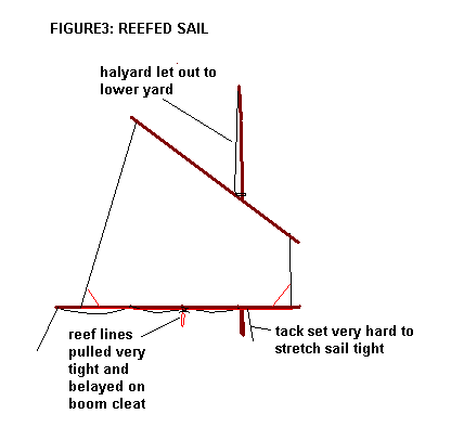

Here's how you reef the sail in action:
First you loosen the halyard to lower the sail. If you have a lazy lift it will gather there clear of the deck. If not, gather the lowered sail in the boat.
Next grab one of the jiffy reef lines and pull until the new reef corner is hard against the boom and cleat the line to keep it there. Then grab the other jiffy reef line and pull until that reef corner is hard against the boom and cleat that line.
Tie in the reef patches in the middle of the sail.
Hoist the sail with lots of tension in the halyard. You may want to reset the tack to put lots of tension in the luff of the sail but with this method the tack and sheet are not changed.
That's it!
Taking the reef out is even easier. Just untie the reef patches, uncleat the jiffy reef lines, and hoist back to full sail. Always make sure you have lots of tension in the luff by resetting the tack line.

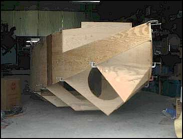

Caprice: A brave and experienced builder in Texas it making the 25' Caprice water ballasted sailboat. A big project. Here is a first assembly photo.
