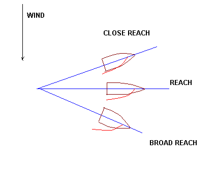

SAILING ON A "REACH"...Reaching is sailing across the wind, more or less, like this:.
Keep in mind that the wind the skipper feels will not quite be the same as the true wind. He and his boat will feel the apparent wind which is the vector combination of the true wind plus his boat's speed. So he will feel the wind more on the bow of the boat.
Reaching is I think usually the fastest and safest point of sail and you can spend a very happy day picking a goal that is across the wind from your launch and zip back and forth all day on reaches. Things that are really critical when sailing to windward, like sail twist and having the board down exactly right are usually less critical when reaching. Wind shifts that stop you dead while sailing to windward have no effect.
I think reaching is so fast because the the force provided by the sail can be better aligned with the boat's motion, with less of it lost as side force to be counteracted by the board with its drag. The board is still down, but it often can be lifted a bit, and even then the "pounds per square foot" loading will be reduced compared to sailing to windward. You still need to tend to the sail and watch your wake to guess at the ideal combination.
I consider reaching to be safe because you can pretty well start and stop at any time by playing the sheet.
As always there are things to watch out for. One is that your boat will usually be aligned with the waves and they might cause a deep roll. That used to be a problem with my Jinni which had a fairly long boom. It would happen regularly at Carlyle Lake that we would get a 10 knot wind across 10 miles of lake raising big lollypop waves at the lee end of the lake. When reaching that wind was about enough to capsize the boat and I'd ease the sail out. But in the rolling boat that boom would swing out and threaten to drag into the water with each roll and that also could capsize the boat. Usually you can switch to a close reach or broad reach to meet the waves at a different angle to avoid the problem.
Another problem is that if you get caught reaching in a big gust the boat may capsize even if the sail is let out. The flapping sail can have enough drag to send you over. My Jinni capsized twice in the years I used it and once was in that way. I think the thing to do is maintain some steerage speed and point more into the wind. Your boat will have more stability than when laying across the wind, and you should be able to carefully play the mainsheet to keep the sail depowered and yet keep the boat moving enough for steerage.

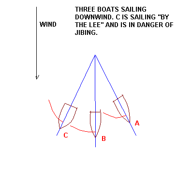

Here are three boats running downwind:

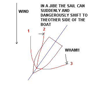

Boats A and B are doing fine but boat C is "sailing by the lee" which means his sail is boomed out to the wrong side. Sometimes you don't know this is happening to you because you don't know the wind's true direction well enough. Often when sailing by the lee your boat will feel odd at the tiller. But you can see that if the wind shifts a bit or the boat turns the wrong way, the wind will come directly aft of the sail and the sail may "jibe" like this:
Jibing is considered to be dangerous for several reasons. If you jibe in strong winds it can be almost explosive. A large boom can kill you if it hits you in the head during the jibe. The shock of the boom coming to a quick stop can rip out blocks and cleats or snap a sheet. If the jibe happens by surprize and catches you sitting on the wrong side of the boat, you might capsize.
You can jibe safely, at least in mild winds, by using some care. Do it very deliberately and slowly and with the sheet in hand. As you turn the boat pull in on the sheet until the sail jibes and then use your grip to ease the shock of the jibe. I think most sailing races have their courses set out so there is usually a jibe required.

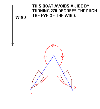

But when sailing alone you may need never jibe. This works:
Boat 1 wants to change heading to port (left looking forward) but that would mean a jibe when the wind passes aft of the sail. So instead he swings to starboard (right looking forward) through about 270 degrees, pulling the sail's sheet in as he goes, tacking through the wind and over to the other side. He ends up in position 2 without ever jibing. This works quite well, I do it all the time myself.

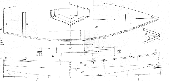

ROBOTE, LIGHT ROWBOAT, 14' X 45", 60 POUNDS EMPTY
Robote was designed for Frank Kahr of Rhode Island strictly as a rowing boat, very light and simple and fast and seaworthy. Frank had started a few years back with my WeeVee design shown here:
What surprised both Frank and me was that both of our WeeVee's would row at 4 mph, blinding speed for a 7-1/2' boat! WeeVee has a deep V center, 42" wide and 9" deep with a lot of rocker and no twisting to the bottom panels. It's actually pretty seaworhty too but is tippy if you are not seated. It's not for everyone.

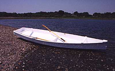

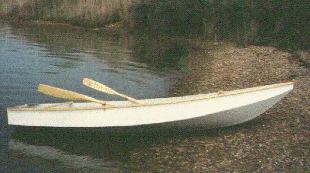

Frank built the boat, which he called Robote, from three sheets of Okoume plywood with taped seams. It went together easily as longer boats with gentle curves often do. He said it weighs about 60 pounds, light enough that he can carry it on one shoulder for a short way. Here is Frank first time out with Robote:
Frank entered himself and Robote in the Blackburn Challenge, where one has to row about 20 miles around Cape Anne in Massachusetts, most of it on the open ocean. But it wasn't meant to be and he wrote:
"Wind was SE 15+, rising, with 2-3' chop off the ocean. I rowed about 10 miles, then ran for cover in Pigeon Cove. The alternative was several more miles of windward slog followed by more miles of crosswind. It would have been too much for me."
"The boat was dry, in good control always. It will cope with conditions in which you have no business being out."
If I had seen that forecast I would have left my boat on the cartop. I haven't yet seen any photos of this year's race, but the results of 1999 and 2000 races are posted at www.blackburnchallenge.com. Last year 2 entries scratched and this year 35 scratched! But that brings up a very good point. Good rowboats with experienced hands can handle those conditions for a while but you shouldn't set off into them if you can avoid it. You can get "blown away", especially if anything goes wrong, such as losing an oar or rowlock. And the same is true for any sort of power or sail boat - a small failure in moderate conditions can bring on a disaster. My own rule of thumb is to not venture out too far in whitecaps.
Another subject came up between us, the fact that almost any good conventional rowing boat that has no extremes will row about 4-1/2 mph and no faster, at least not in a long row. My Roar2, Sportdory, RB42 and now Robote all go about that speed. Frank adds:
"I agree with your observations about good plywood rowboats. While robote is not a real speedster, it is very pleasant and responds to greater effort with greater speed. Beaching is no problem; in calm water just lean over so one side of the V is horizontal. The boat grew on me during my 2 weeks on Cape Cod and is now beached at a town landing, to be used weekends the rest of the summer. One of my adventures involved a sudden storm with 2' chop crashing on the beach at South Monomoy when I needed to launch to return home; this wasn't pretty, but I got away on the second try.

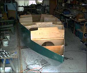

Caprice: A brave and experienced builder in Texas is making the 25' Caprice water ballasted sailboat. A big project.Here the hull has been glassed, painted and turned and is now ready for interior work. The water ballast tanks are complete, one coating with glass/epoxy and the other just with epoxy for a scientific test. The builder's past experience with a boat this size is that if the sun doesn't hit the plywood you don't need the glass fabric to keep the ply from checking. But if it does, as with the decks, epoxy coating alone won't keep the ply from checking.
