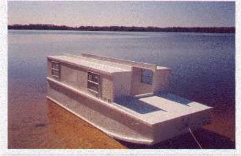

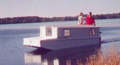

HARMONICA, MINI SHANTY, 13' X 5', 400 POUNDS EMPTY

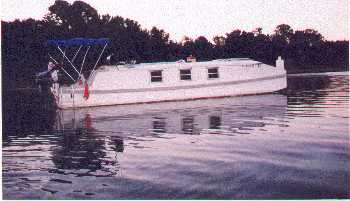

I reviewed my Harmonica design a few weeks ago but got these photos plus a nice letter from a second Harmonica builder, John Applewhite of Gainesville, Fl. When John wrote me way back when about looking for a small shanty boat he said that he was experienced with electric boats and also with a big shanty, 28' long as I recall. Here is the big shanty:
He said the big one was a bit much for solo boating and something like Harmonica would be better in that case. He calls his Harmonica Steel Will. Here are parts of his last letter:

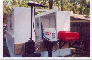

"We use the 3 hp MinnKota electric as much as possible. In the picture facing aft the two golf cart batteries are just behind the bulkhead on the port side. You might notice that I used two 2x4's at the bottom of that bulkhead, the symmetry was too perfect.
"The only time the electric motor fails to perform satisfactorily is going upstream in a river, then Mr Honda has to be used. The 10hp Honda is far too much for this boat, but it is all I have on hand. A five hp Honda would be perfect.

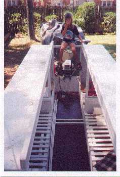

"I would be very interested in hearing how others have covered the center walkway during rainstorms. I have three PVC pipes that bend in a U shape over the cabin area of the boat. I throw a tarp over the pipes and hold the whole mess together with elastic tie downs. With the tarp up it looks like a waterborne Connestoga wagon. It works and allows standing head room, but it really flops in a breeze and I am convinced that it might fail some dark stormy night."
Well, John is actually on the cutting edge of this walkway tarp problem. I used to use plywood panels but converted to a simple cover made of polytarp that snaps to the side and is supported at intervals by small diameter PVC pipes which bow only slightly - I don't have standing headroom with the tarp on but it does seem snug and you can trailer down the highway with it on. Almost anyone who has tried a plywood cover for the walkway has gone to a softcover. One man warned against using Sunbrella like fabric which is apparently not sufficiently waterproof for a flat cover.
