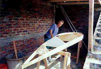

"I have perfect weather to work. I did the wales at night when the temp got down to the 70's. I'm having a real problem because I've got access to really hot computers at the end of a e 1 sat. downlink here in Managua. Free fast Internet. I'm trying to build a Web Page but I keep getting distracted looking at everybody elses. Here's a picture of Toto under construction.
"Oh, have you ever thought of rewriting the guide to the building? There are a few errors in the one on Toto. One mistake I made was I angled the sides of bulkhead 10 the wrong way. Would have been easy for someone to warn me of the possibity. I bet allot of guys would do it for free just to be a part of the whole thing. I really liked the essay on camping.

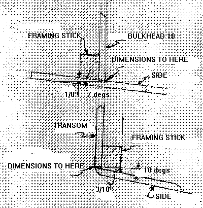

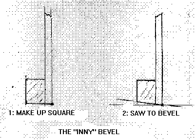

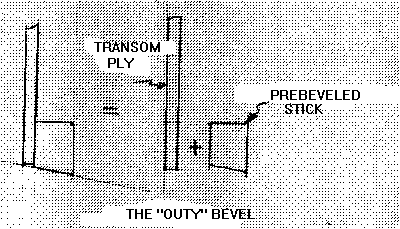

You might ask why I use beveled sticks on a taped seam boat. The answer is that I personally find it much easier to set up a boat initially with glue and nails to firmly establish its shape without relying on wired seams. The photo of Dale working on his Toto is the stage I'm talking about. If done this way the assembly, especially the sides to bulkheads and transom, is very firmly screwed and glued together without resort to messy resins which be used later in the actual taping of the seams. I think it's the easiest way and won't discourage anyone who thinks they have a better way.
Anyway, when I figure out the dimensions of the plywood piece that forms the shape of the bulkhead or transom, I take its dimensions off my lines drawing as if the piece had no thickness.

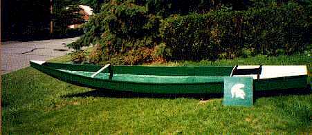

The photo above is from Tom Raidna who has a neat boating page at Backyard Boats .
The boat is an easy prefab job from two sheets of 5MM lauan underlayment, still very cheap at maybe $12 a sheet from the lumberyard until the rain forests are gone. Marc Smith came to the 1994 Midwest Messabout with tow of these Totos strapped to the roof of his Birdwatcher. They were built by two twelve year old girls under Marc's guidance. Marc said the girls did all the work including using the power tools. And they paddled around the Messabout in them.
Plans come with complete instructions including the details of taped seam construction and a drawing of a simple paddle that works. (Marc Smith's girls used double paddles made from old vaulting poles with plywood blades bolted on. I tried their boats and paddles and they were quite good.) No jigs or lofting required. Blueprints plus instructions are $15.
