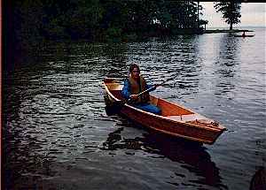

Left: DON O'HEARN'S PIRAGUA

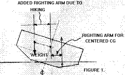

Take a look at Figure 1 which shows why hiking works so well. If the boat's overall CG is offset from centerline, that offset is added, to a certain degree, directly to the righting arm calculated by the stability program. I say "to a degree" because the added effect is actually the offset multipiled by the cosine of the heel angle. That would mean it is quite effective at small heel angles, drecreasing as heeling increases to the point where hiking has no benefit at 90 degrees of heel. (Unlike traditional ballast which is most effective at 90 degrees of heel.)

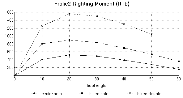

Here's the example for Frolic2 with the single off center crewman: Heel (H) H6S Righting Arm .625' X Cos H Total Arm Total M 10 .64' .615' 1.26' 800 20 .82' .59' 1.41' 900 30 .77' .54' 1.31' 840 40 .61' .48' 1.09' 700 50 .44' .40' .84' 540 60 .25' .31'. .56'. 360 70 .09' .21' .30' 190 Here is what is looks like:
Well, you can see that the effect of the skipper hiking (or in this case just sitting on the upwind side of the boat), about doubles the righting moment of the boat. I'm a bit surprised that the boat still shows a positive righting moment up to 70 degrees of heel. But the Hullform analysis indicated that the rail is going under at 60 degrees. If it really works out that way it ain't so bad. It certainly ought to give the crew a good indication that it's time to back off the sheet! Actually, if the oarports are left uncovered there will be some flooding even before then.
On the chart I've also shown the effect of a second 200 pounder on the upwind seat. Quite an effect. Righting moments are way up again, although the program showed the boat would now flood over the rail at 50 degrees of heel. I want to show this because the crew you sail with will certainly have an effect on the impression a boat leaves you. Sometimes I've admired how some folks seem totally unfazed by stiff winds only to find they are always sailing with heavy crews. (My old Jinni capsized on me twice while solo, but never with two crew even though there were some wild sailing days.) One similar problem is the case where a swimmer tries to reenter a light boat. If solo, the boat might easily capsize as he loads his weight on the rail to pull himself into the boat. He may not think too much about that if he never sails solo and the extra crew weight in always in there to stabilize things as he climbs back in over the rail.

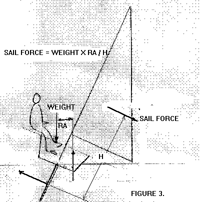

CONVERTING RIGHTING MOMENTS TO SAIL FORCES....
This is easy as pie! Look at Figure 3:
Once you've figured the righting moment, all you need to do to balance the boat is to divide the righting moment by the distance between the center of area of the centerboard (or daggerboard of leeboard or keel, whatever you are using to prevent leeway) and the center of area of the sail. On Frolic2 the two area centers are about 12' apart. So if the maximum righting moment is 900 foot pounds, the maximum sail force (and centerboard force, on a normal boat the sail force and centerboard forces are equal and opposite) is 900/12=75 pounds.
What does that mean? We'll return to this subject in a while and relate the righting moment curve and the resulting sail forces to the wind's speed over the sail and the water's speed over the board. Given the righting moment curve and a certain sail we can figure the wind needed to capsize the boat. Or given a wind speed figure the maximum sail we can carry.

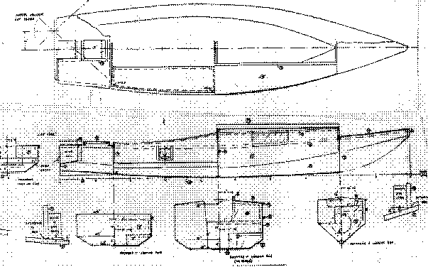

Frolic2
FROLIC2, BEACHBOAT, 20' X 5', 400 POUNDS EMPTY
Someday I may get to put my full catalog on the net. For now I'll put one design in each issue.
The original Frolic was in the catalog for several years. It was similar to Frolic2 but was narrower, 20' long and 4' wide. That one was intended for row/sail cruising but since then I've learned that no one wants to row a boat this size more than once. To do so requires conditions that are near perfect, no wind and no waves. Even on a perfect day, powerboat wakes stop you dead. So I widened Frolic 12" and got Frolic 2. I thinks it's all around better now. More room, more stability, bench seating for more comfort, and a serious motor well. I followed the lead of Petesboat for the engine well. I put the well in the center of the boat and offset the rudder. Why not? You could still row this boat in perfect conditions, maybe more than once.
Here's the writeup in the Prototypes Catalog:
.....Here in the Midwest we have lots of manmade lakes. The big ones are usually about two miles wide and ten miles long. They're shallow, 30 feet deep in the old river channel and with an average depth of 10 feet. Huge areas are only waist deep. The rivers and lakes run North/South as a rule and so do the prevailing winds. White caps appear in 12 knot winds, sometimes less. A 15 knot breeze might produce two foot waves, closely spaced with near vertical faces and foamy tops.
This sort of condition is common in a lot of places. Certainly the Gulf Coast can be the same, and I've heard it's true in the Chesapeake. It's not true everywhere, I guess, because I hear of folks sailing litle flatties in big waters and hard winds and you can't do that here without taking a dangerour beating. I designed Frolic2 to deal with those conditions. She's long and narrow with multichines and a long lean bow to handle the waves. She has my usual slot top cuddy cabin to sleep in, and a pivoting leeboard and rudder for shallows and beaches.
The lug rig is for quick and easy rowing, and towing and stowing. It may be too large but these rigs reef well. They can be closer winded reefed than when full, perhaps because the yard is better controlled. For that matter a sharpie sprit sail the same as Pencilbox's may be smarter in rought water operation. Swithing rigs won't be hard. The mast can be relocated almost anywhere in the slot top without altering the hull to any degree. You just need extra partner and step fittings.
Bigger boats like this can row well if there is no wind or waves. But I've put a small motor well on this one and 2 hp is probably a realistic max.
She needs eleven sheets of 1/4" plywood and two sheets of 1/2" plywood with jigless taped seam construction. Plans are $20 until a prototype is built and tested.
